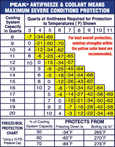

Test the "water" in the system. If test reads <50% coolant add more pure product to fill. Or drain the rest and refill. If test reads 50% - 70% add 50/50 Premix.
