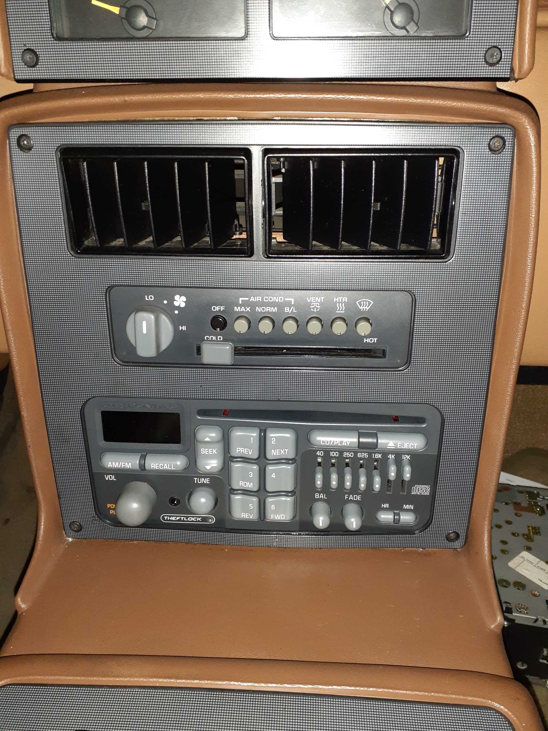

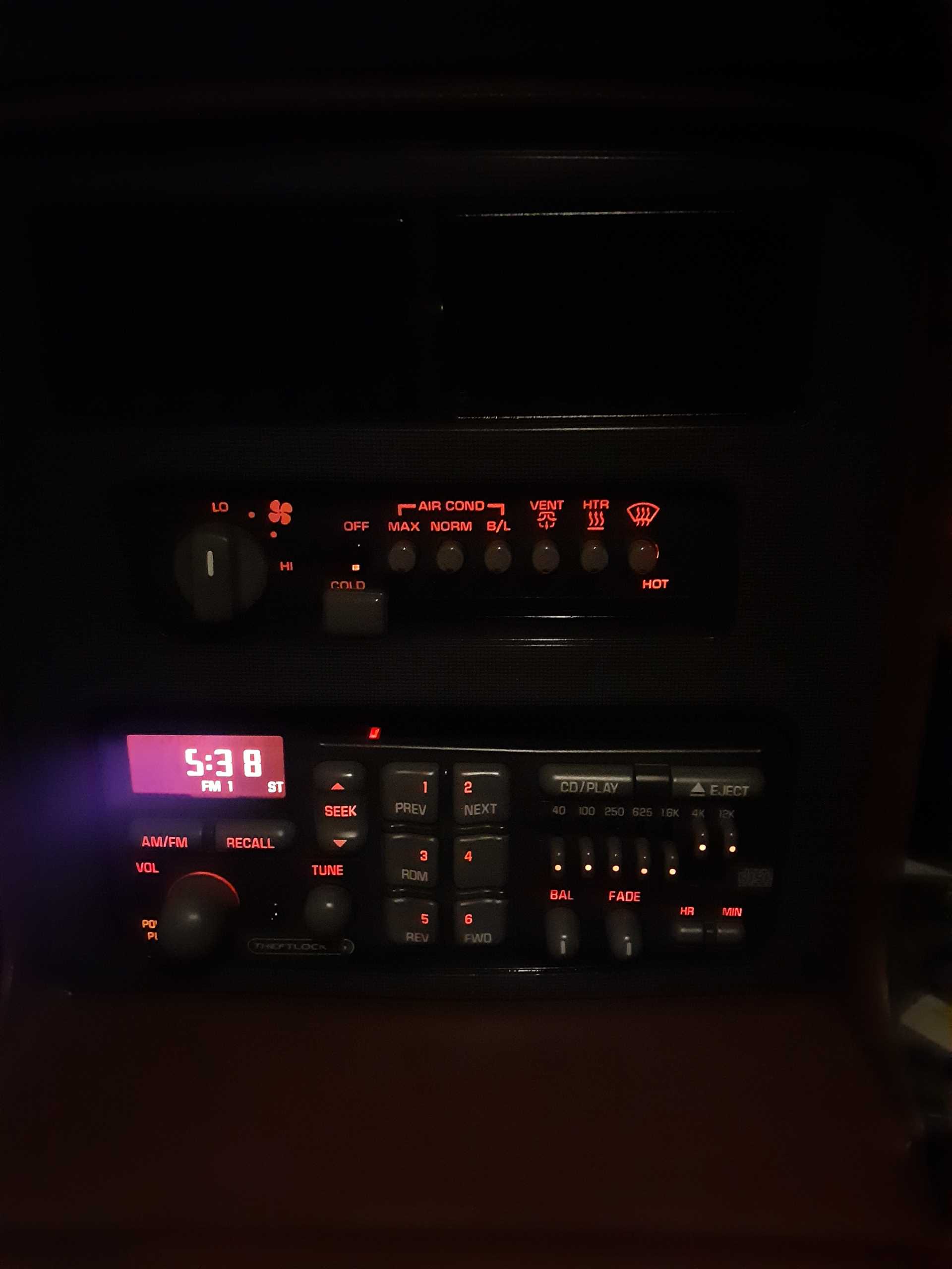

+1 for Fiero Tom's units. This was $129 shipped with the adapters. Takes about 5 minutes to install and as you can see it could totally pass for original.
fierofool
MAY 02, 07:41 AM
modesto, did you have to cut and splice the harness into the car harness or is it like the plug and play harness from Replacement Radios?
