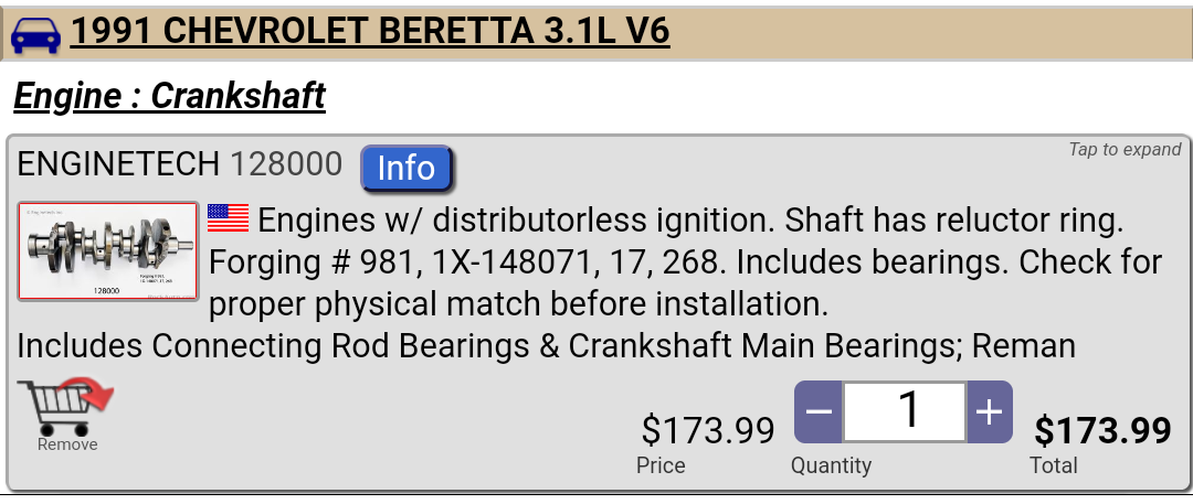

As Raydar said, you can get a neutrally balanced crankshaft for a (Beretta) 3.1 FWD engine and use your old rods and pistons or the new stock 2.8 rods and pistons you just bought. The shorter stroke of the 3.1 will give you much more torque. It's all a drop-in, except you'll need to replace the flywheel or fexplate. In that case, a 91 Beretta piece is readily available through Rock Auto.
Is this the right one?
I am also swapping out my transmission for the 4T60. Do I need to do anything to this transmission for the Beretta crankshaft?

I'm installing a 3.1 engine into my 86. It's a factory engine, but the block is essentially identical to the 2.8. It has the 981 cranshaft in it. That was how we determined that it needed a neutral balanced flywheel instead of the counterweighted 86 flywheel. Something way back, though says that the reluctor wheel might have some interference with the block. Some of the other guys like olejoedad might be able to answer that question. The 4T60 transmission is quite strong enough for that engine.
Raydar, does he need to change to 3.1 pistons or can he use the 2.8 pistons with the 3.1 crankshaft? If not, the 88 cranshaft and 3.1 flexplate would be the way to go
pmbrunelle JUL 06, 12:04 PM
You need to change to 3.1 pistons to use the 981 crankshaft.

If you want to keep your 2.8 pistons, then yes, go for the 88 Fiero 2.8 crank.
Use an 89 or later Beretta or Cavalier flexplate. (It will probably call for a 3.1. They should be the same.) It should not have any sort of balancing weight on it.
Edit - If you use a 3.1 crank - any 3.1 crank - you will need to swap over to 3.1 pistons as well. The rods, however, are the same.

Originally posted by fierofool: As Raydar said, you can get a neutrally balanced crankshaft for a (Beretta) 3.1 FWD engine and use your old rods and pistons or the new stock 2.8 rods and pistons you just bought. The shorter stroke of the 3.1 will give you much more torque.
This is incorrect. First of all, the 3.1 crankshaft has a longer stroke than the 2.8 crankshaft. That's where the extra displacement comes from. Second of all, the 2.8 pistons are too tall to use with the 3.1 crankshaft. If you did that, the piston would crash into the cylinder head, and that would ruin your day.
Since the OP already has new 2.8 pistons, he needs a 2.8 crankshaft. The '85-87 crankshaft (i.e. externally balanced) would be a direct drop-in for his engine.
