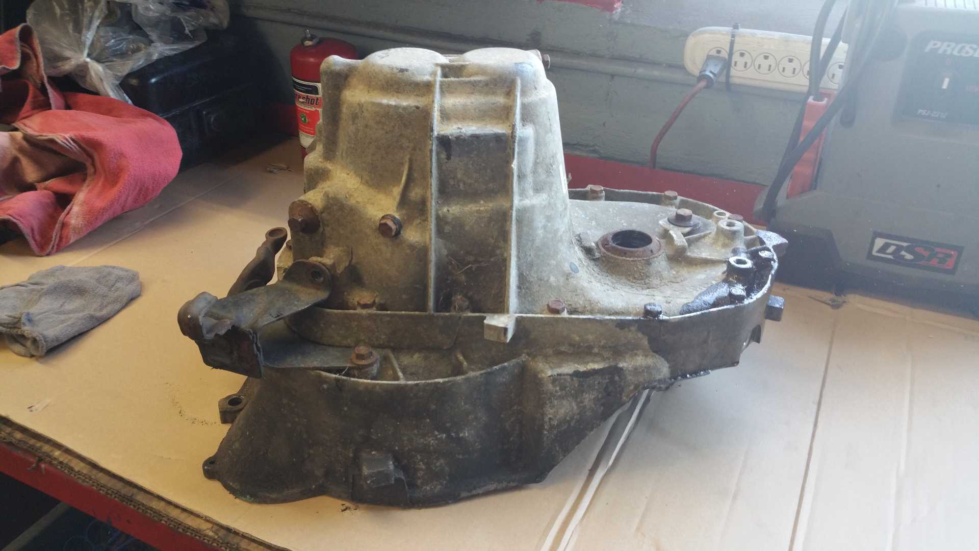

i'm putting in a 3800 SC from a 2002 GTP and i have all three 4 speed trannies. My original intention was to use the MY8 tranny for the swap, but then a friend turned me onto the idea of making a frankentranny using the 3,4 an final drive gear from the My8 and the 1,2 and case from the M17. Pretty sure i could pull it off if i had a press to remove and install the gears. Maybe this winter i will attempt it, when i pull apart the M17 to see how daunting it is. There is a thread on the forum here about how to do this.

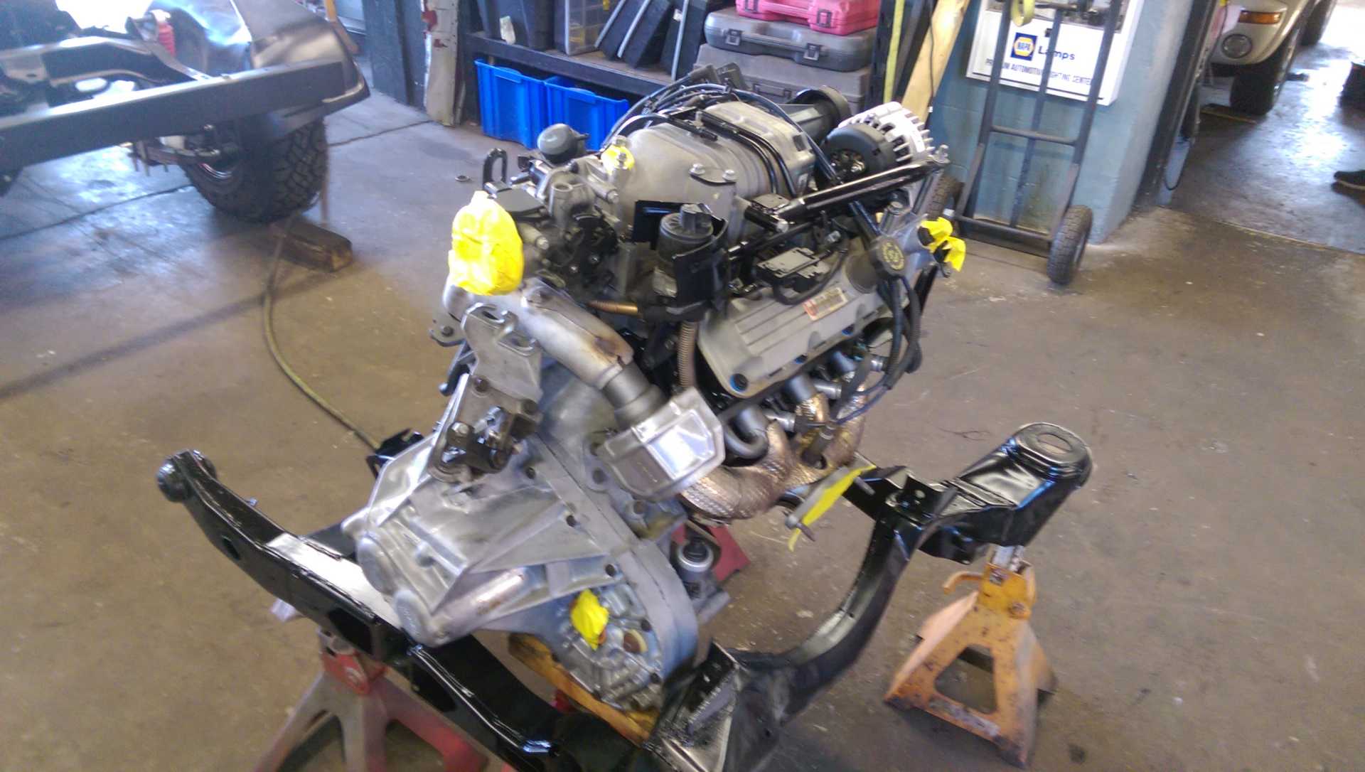

I have a hybrid Muncie 4spd in my 3800SC 84 SE. I wanted the 4spd strength but also good on the highway. After driving it for 2 years with the Duke and the 4:10 I knew that gearing was too low and planned my swap and bought an MY8 from someone here on the forum. I also bought an M17 to complete the build as per the thread here on the forum. The end result is great. 2300 RPM @ 70mph and about 28mpg highway and 22-24 local depending on how I drive it. Grew up driving a 4spd and I love it. Well suited to the L67 power curve. It does take more effort that just buying a 5 spd but it also makes it different.
   It did require I modify the shift cable braket and one of the levers to keep the cables clear of the crossover pipe. I also wrapped the with a heat insulator. 3 years and 12K later all is great.

larafan: Thanks for the pic and the encouragement to do a hybrid. i'm gonna tear down the M17 to see how hard it looks before undertaking a hybrid. How did you do the spacers?

Bought the Kent Smith tool used on eBay and used it and re-sold it. It's listed in the thread on the build. It really was easy to do following step by step from the thread. Also having a friend to help you keep things straight and 2 separate areas so you can keep the parts organized. In the end everything went together with the shims that were in the M17 originally. [This message has been edited by larafan (edited 04-23-2020).]

----- Message Forwarded from pmbrunelle ----- You may want to consider modifying (or building a new one) the crossover pipe and leaving the shift cables alone.
For the shift linkage, I think it would be ideal if the cables came in at a straight angle, like the stock setup does. If they came in crooked, they would be forcing the shift levers in a sideways (undesired) manner.
Larafan's solution probably works... I just don't think it's the ideal solution. I didn't feel like sharing this opinion on the thread, as larafan may have taken it personally. So after 7 years on this forum of gaining and sharing I accidently received the above private message meant for the OP from pmbrunelle. I shared my experience in answer to the OP's request. If someone has a differing opinion or experience why not share that information and or have a discussion about the differing opinion. But someone who doesn't know me or my qualifications does it this way. Now we all know your opinion.
