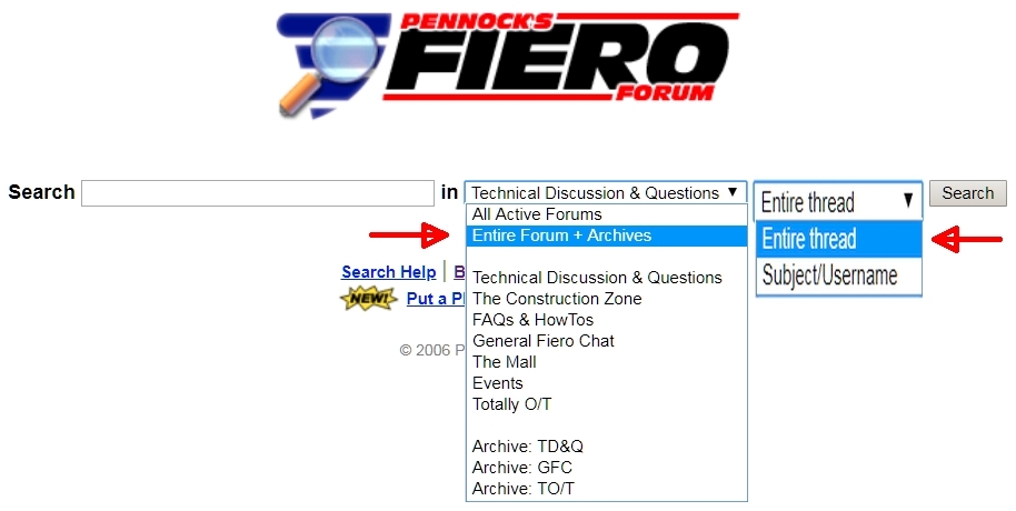

Interestingly, when I had done a previous search on the forum I must not have used the correct key words because that posting and your photo/diagram did not appear.
It's not just the "key words" used that are important, it's where you're looking. I suspect some people have never investigated the drop down choices. The ones I've indicated below cover the widest parameters.
