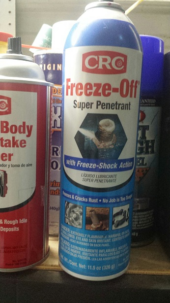

Is there a how to thread for getting that O2 sensor off???? I swear I think it is the original from 1986!!!!!! It is rust welded on and there is little to no room to reach it from the top??? |
Spray it with the usual products, and let it soak for an hour. Then use some of this and follow the instructions. A friend of mine was trying to remove a stuck O2 sensor and couldn't budge it with a 2 foot cheater bar. I sprayed some of this product on it, waited a few minutes and removed it with a regular wrench.

Thank you Spoon!!!!!!!!!!! It took a lot of effort, but she finally broke loose. I cleaned up the area and put anit-seize on the new sensor and got it back in there and plugged back in. I just cleared the codes and am going for a test drive.... Wish me luck.
