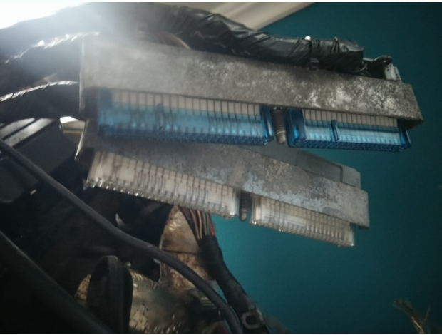

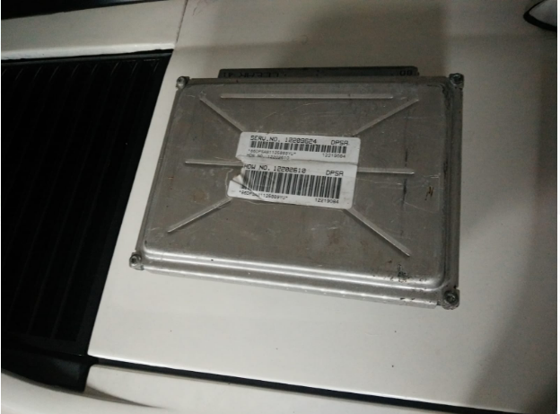

OK, i call that the computer. i understand that a new chip will need to be burned. That chip is located in the PCM no? i have read a lot of threads on the 3800 and i can't seem to find how the wires get from the engine compartment thru the firewall to the PCM. i know that you use the C500 and C203 connectors from the Fiero and that the C500 is on the firewall (at least it is on my 84), but the PCM of the 2002 GP has these huge connectors. What am i missing?

1. I would relocate the C500 to the location us d in the 85-88 model years. 2. I would add a Battery Junction Terminal in the 85-88 location. 3. The PCM does not use a replaceable 'chip'. The PCM is reprogrammable. I recommend Ryan at Sinister Performance. 4. The plugs for the PCM, the C-203, and the ALDL will fit through the square cutout in the firewall above the PCM mounting area. They go through the driver side cutout, and there is a plastic housing that captures the wires and seals the cutout.

1. Why should i relocate the C500? 2. With my Duke i have tied in all the hot wires together - the starter, the battery and the alternator. The battery is in the front under the passenger headlight. 3. i have already contacted Ryan, he says he needs the number on the PCM, and that is why i have carefully taped down the sticker on it as it was coming loose. He also needs to know what exactly i am installing or removing from my swap - mods and what not. He will not ship internationally, so i will have to have him ship the PCM to my brothers house so i can pick it up this summer at a wedding. 4. The ALDL is the thing that you short out to read the codes no? i thot that with OBD2 i didn't need the ALDL - tho, in the rush to pull the motor, i forgot to search for the OBC2 connector - i guess i can pull one at the scrap. i pulled a C-203 at the scrap so i can make the harness while my car is still on the road - less downtime. i found the C-203 in the center console, i guess i have to push it thru the firewall when i am finished with the harness.

THe ECM can be mounted in the engine compartment( it is in the GP). Mine is located just behind the driver, where the Fuel pump relay is located. If you got the whole wiring harness, including the fuse box, then it is almost a drop in ( fuse box where the battery was located). Only a couple of wires need to go through the firewall to the c203, a couple go to the C500. You can also use the Electronic Cruise control from the GP. ------------------ '87 GT , '00 3800 Series II SC, 4t65e, Vue Power Steering. (SOLD)
