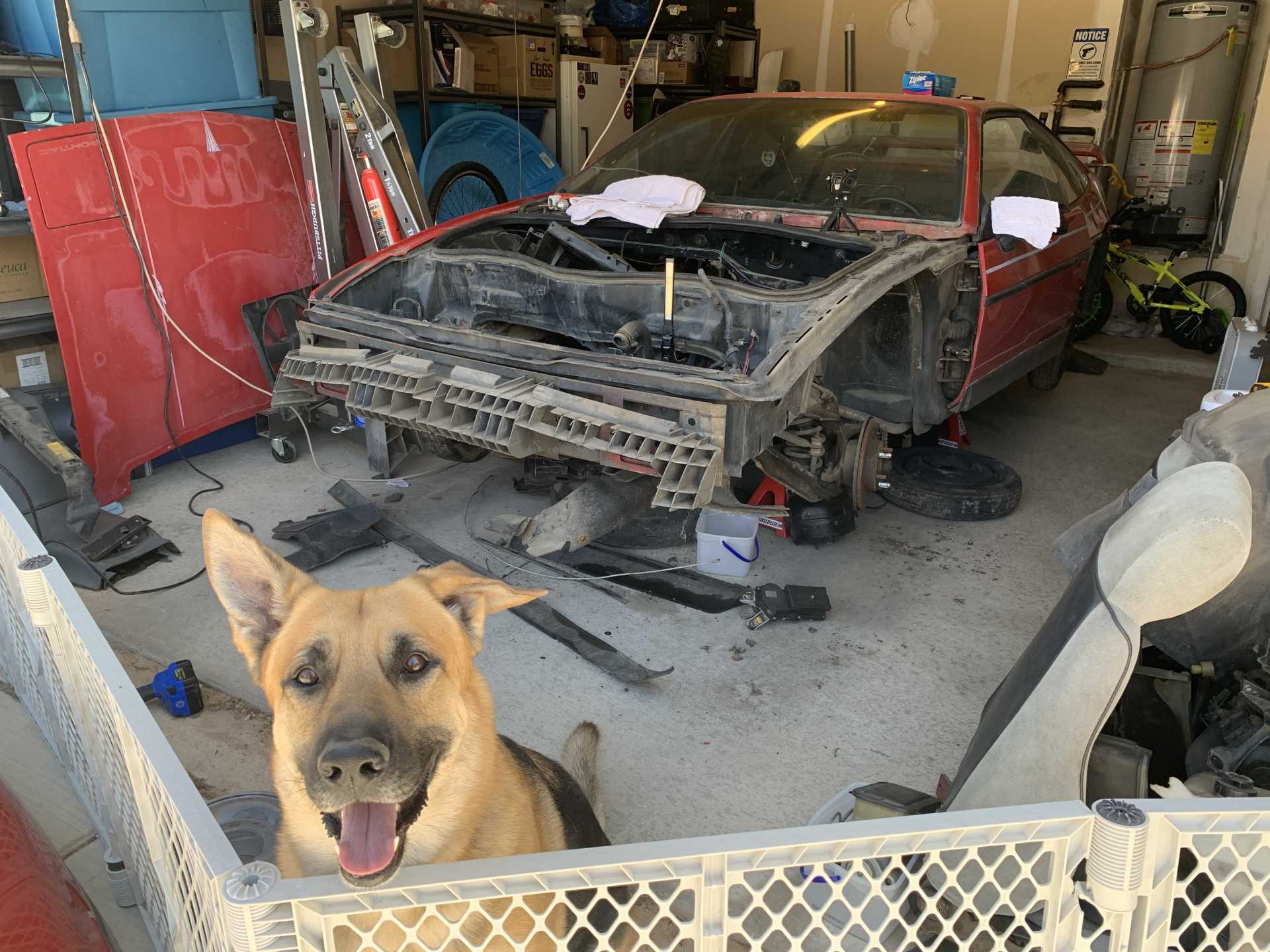

So this topic doesn't look like I up and quit on this, Heres an update photo while I work towords the next video! Managed to remove all of the forward body panels and most of the supporting brackets.
MAY 05, 11:59 PM
If I remember correctly, once it's loose, you pull it out and then to the driver side and it kind of angles out.
But it's been a while....
