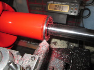

Hardest part is cutting the spring perch off of the struts....The other critical thing is getting screw-sleeves that properly fit the strut...I bought some, thinking I had nailed the dimensions, and found out they would not work. Fiero Guru had the right size sleeves and that solved my problem (Well...One of my problems...)
I had KYB GR2 struts out back- switched to Konis.....slightly better- not a huge difference. I would not spend the money again for the change. It may be better for a dedicated track car- but even then I don't think it is worth it.
By the way, on the Konis, the top of the strut has to be ground down so that the sleeves can slip over it.....That is a miserable job also!

The levels 1-3 require you to prepare the strut for the coilover conversion. This requires cutting off the spring perch on the strut (which is a pressurized cylinder). You have to be very careful with cutting and heat generation, so probably not something a first time fabricator should be doing.
