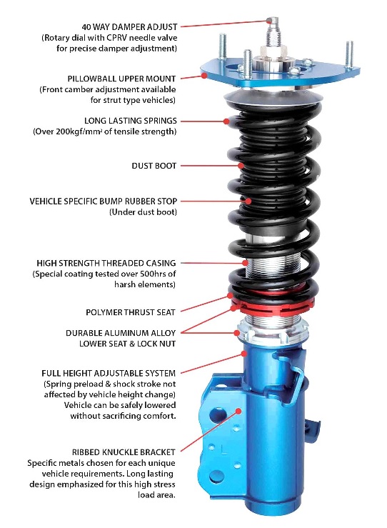

fierosound MAY 22, 12:58 PM
Originally posted by rubyredfiero:
I did the coil over conversion similar to the pic by FIEROALL using 12" springs. The part I don't like is that when the car is lifted or bounces hard, the coil comes out of the upper collar. The spring can even ride up on the threaded sleeve and possibly get damaged before the spring settles in each collar. My question is, what can be done to prevent the strut from opening past the free length of the spring. In my case 12".
Some coilovers have a dust boot like the original struts had.
They'd keep the coil in line with the upper collar.
