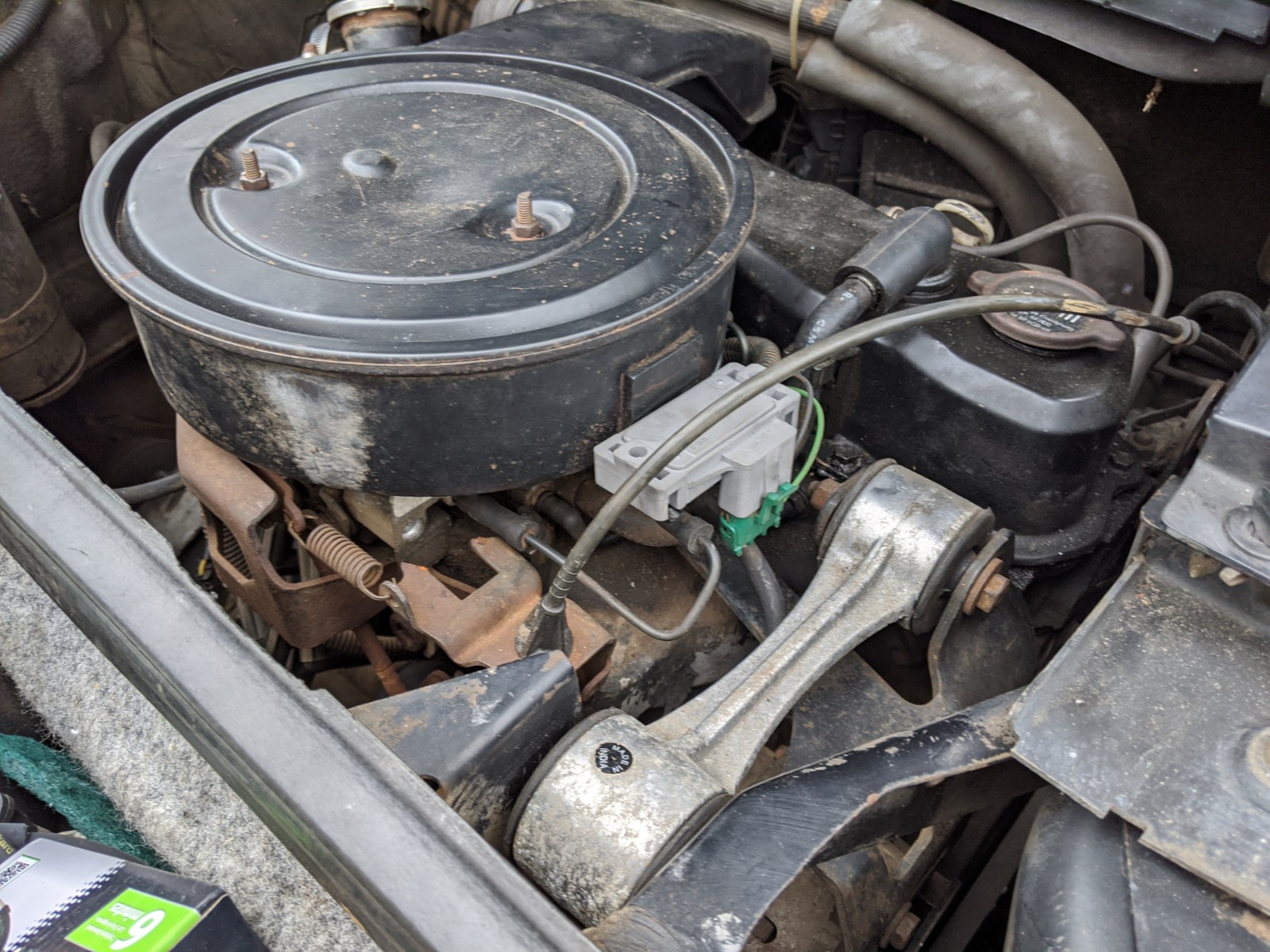

So I figured I would mess around with some things just to see what would happen, and included a bunch of pictures. As it stands it normally idles at about 3000 rpm.

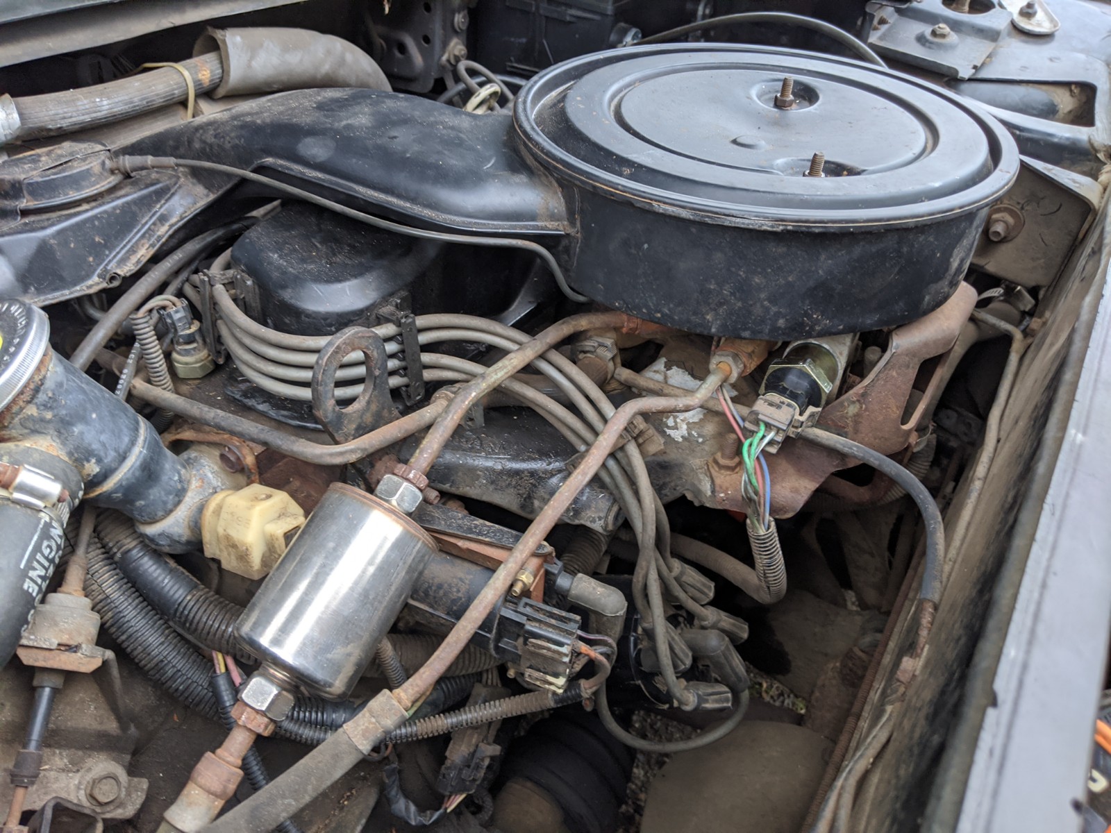

Here's the broad engine bay right now:
The throttle adjustment screw was messed with previously but I believe I have it set more or less correctly. It's only sticking out just a small amount and the throttle valve is pretty closed.

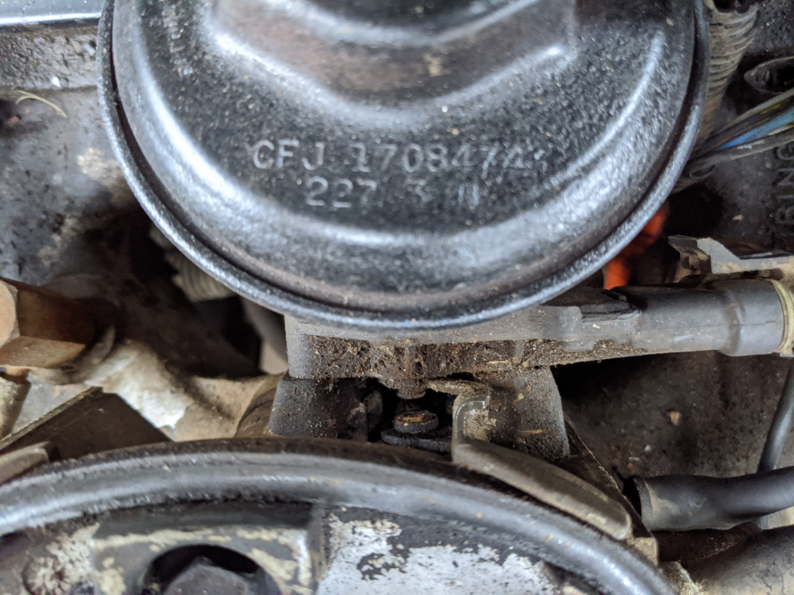

I had unplugged the vacuum line from the MAP sensor and the idle had decreased to approx. 2000 rpm. Every time I reattached the vacuum line it immediately shot back up to 3000 rpm, and when I unplugged the MAP sensor all together the engine died.

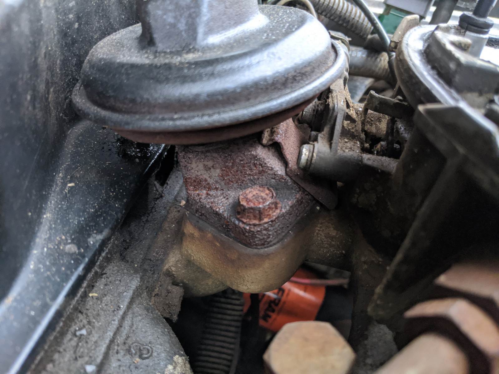

Also with the vacuum line from the MAP sensor unplugged I also unplugged the vacuum line from the EGR valve, which made no difference. I had previously replaced the gasket and checked to see if it moved under vacuum and it did.

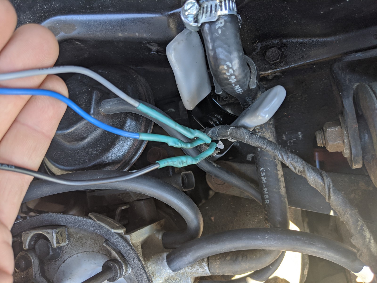

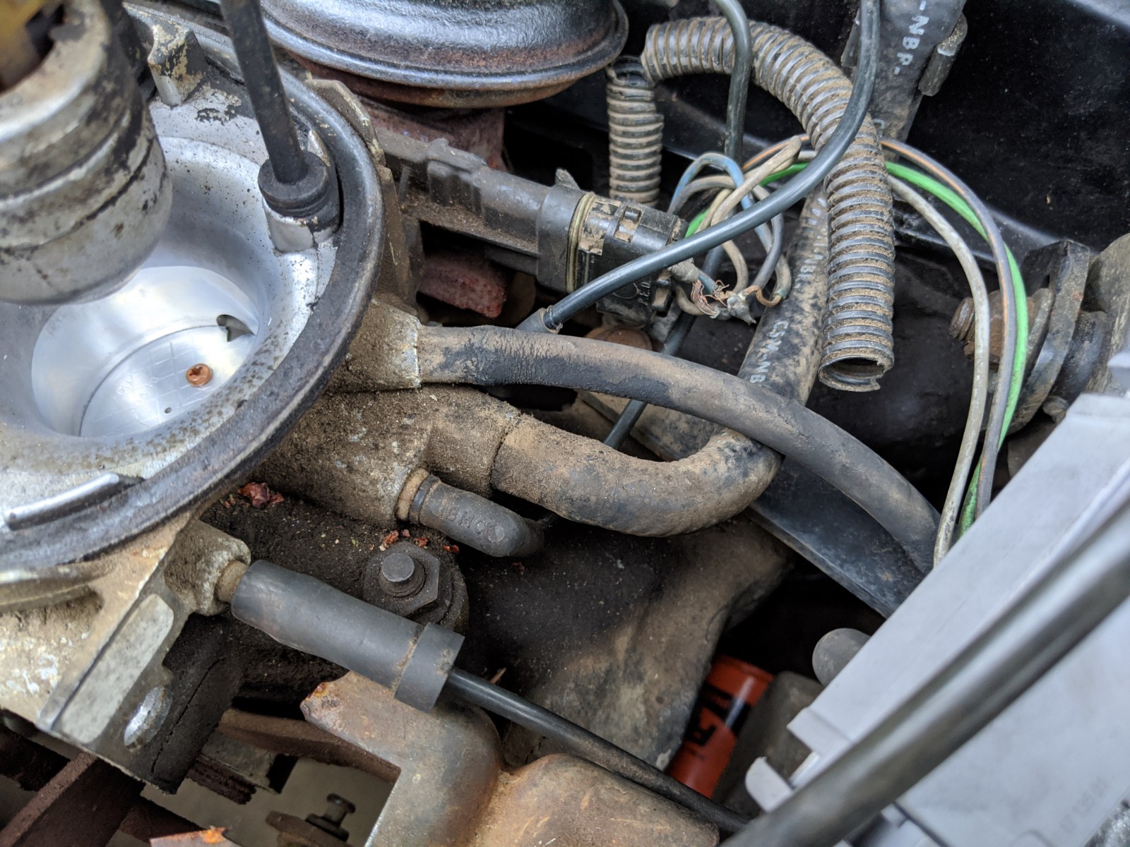

I also played with the TPS, and idling if I presses the sensor arm in it idled more roughly. I know the connection to the TPS is sketchy but it seems to work for the time being. When it's completely unplugged it doesn't do anything, whereas when it's plugged in it seems to be working properly.

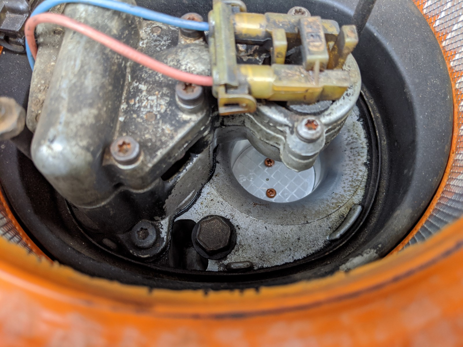

I also took out the IAC Valve entirely and it didn't seem to make much of a difference. While it was running I unplugged the IAC Valve and re-plugged it in and could feel it slightly vibrate, but the end didn't particularly shoot out or retract.
I also checked the vacuum lines for any obvious leaks, which they seemed okay. I also checked the line from the break booster and that was fine too.
So the only thing that's actually decreased the idle for me is to unplug the vacuum line from the MAP sensor, which clearly isn't the correct thing to do. Maybe someone with more experienced eyes can spot something that I wouldn't think to look at or pay attention to.

I just retried starting and got a code 22 so maybe the TPS isn't working the way it should, which makes sense looking at that god awful connection. Would that cause the high idle though?

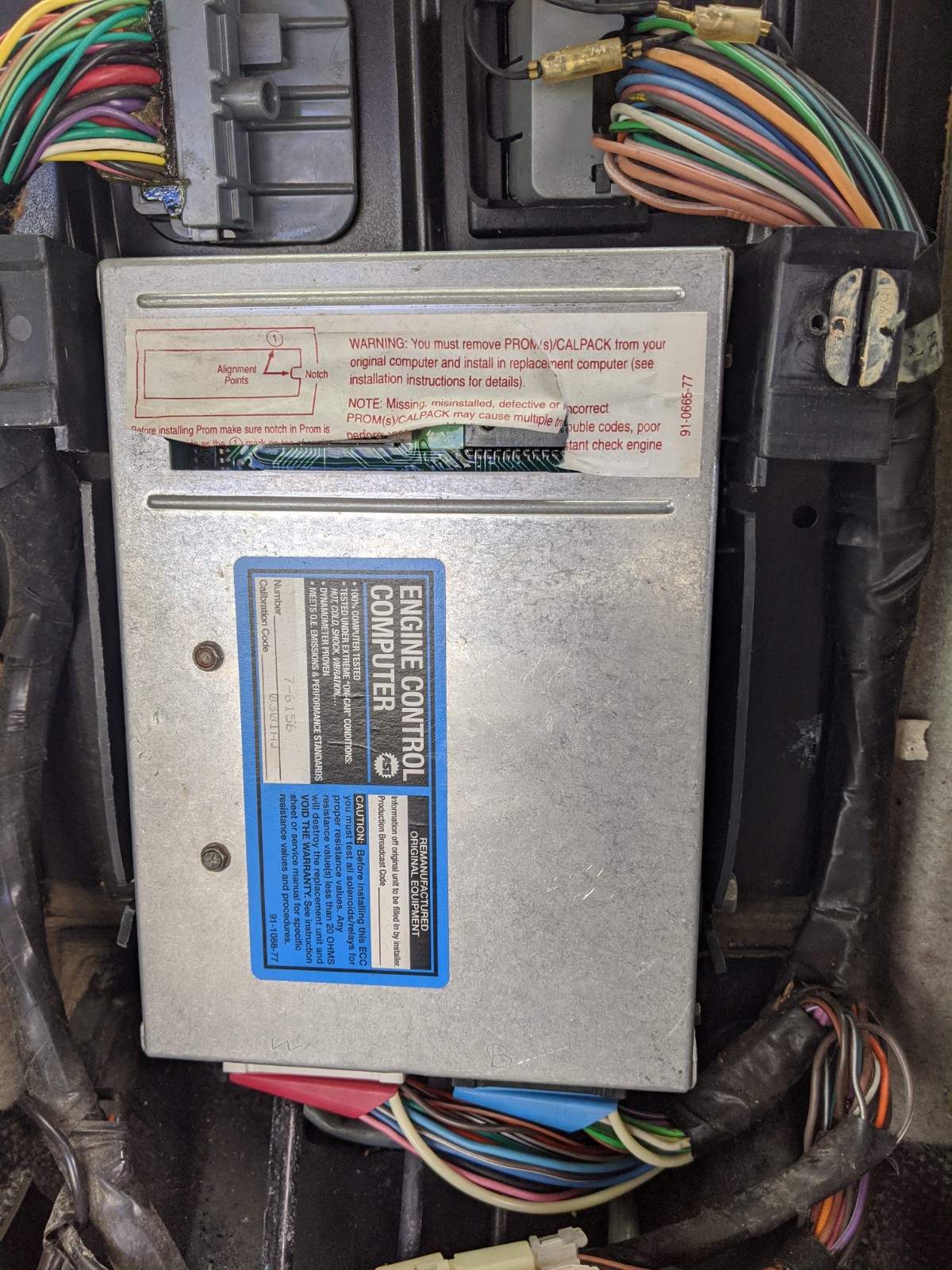

This may sound odd but have you verified you have the correct ECM in the car? When I got my 84 it had strange issues that didn't make sense. It drove fine but on startup or coming to a stop the idle was 2800-3000 rpm before it would go back down to 1k. Turned out the previous owner put an 85 automatic ECM in my 84 manual Fiero.

That wiring at your TPS needs to be fixed. Even butt splices would be better than whatever is going on there. Edit: it could indeed cause idle issues.

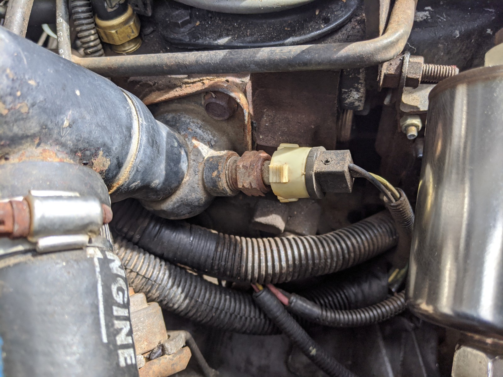

Also I noticed in the picture you still have that plastic cover over the temperature sensor in the water neck which makes me think it's ancient. Have you ever replaced the temp sensor?

So first thing today was to replace the TPS connector.

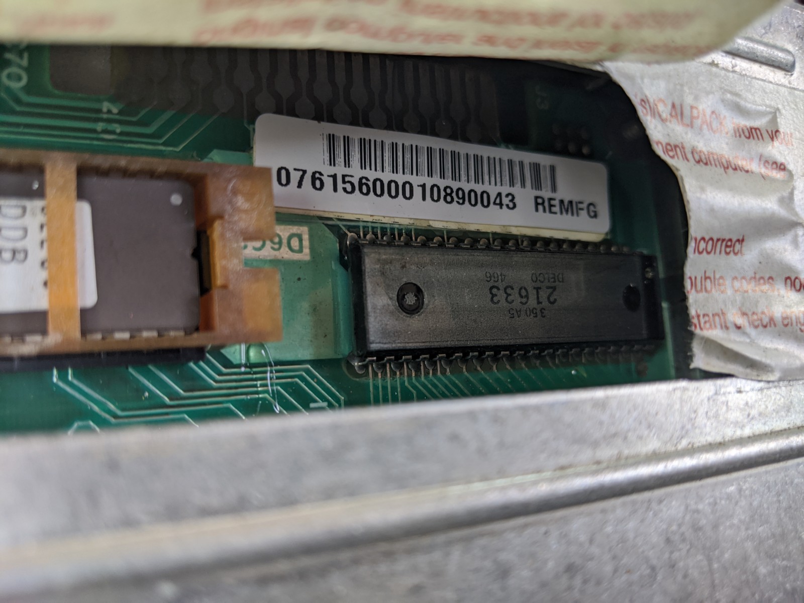

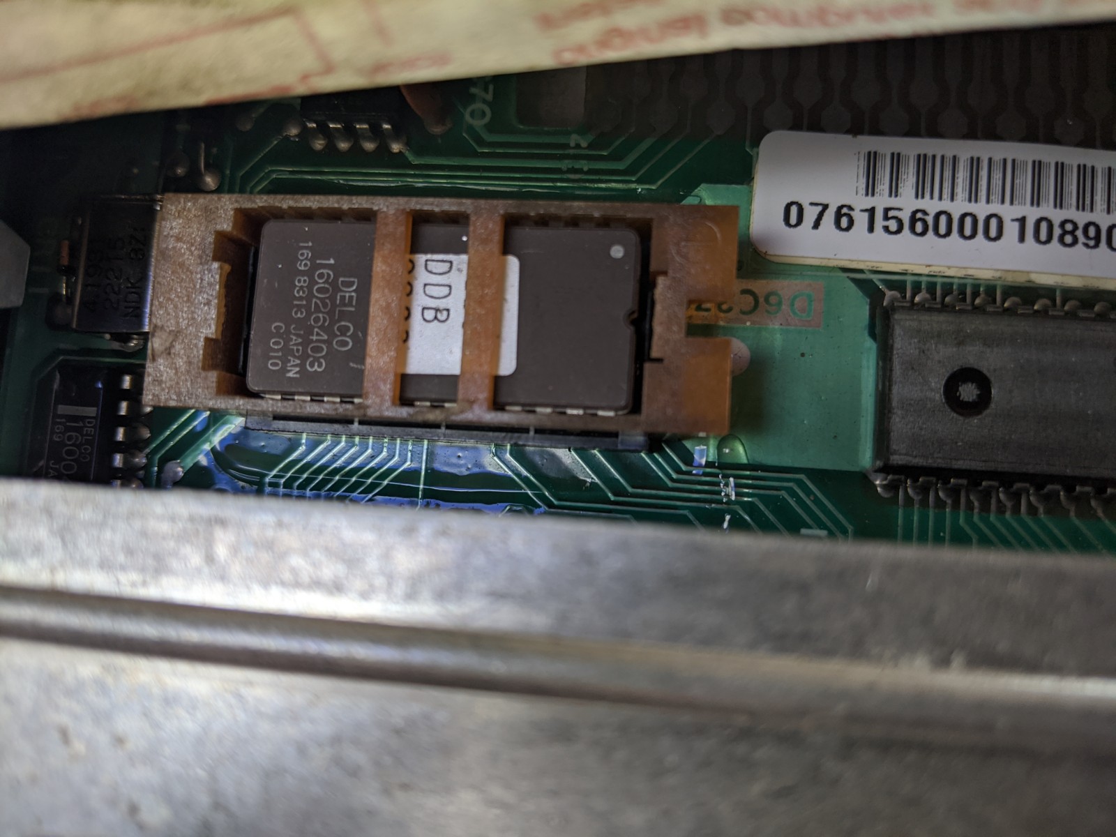

I took off the center console to check the ECM. From what I saw the ECM number is 7-6156, calibration code 0301HJ, which from what I can tell doesn't correlate to any of the Fiero ECM numbers. I noticed the paper being ripped at the top and saw the PROM, and it looks like from the serial number inside that this is a remanufactured ECM but from searching the internet I can't seem to figure out if this is right for the car.
I haven't replaced the temp sensor with the wiring to the ECM but I had previously taken it out and wiped it clean on the end. Also last time I was messing with it when the car was idling correctly I had unplugged it, and the car ran slightly more rough, and when the idle was high I also unplugged it and it didn't seem to make a difference in the idle. I'll likely end up replacing it anyways just to know that it's new.

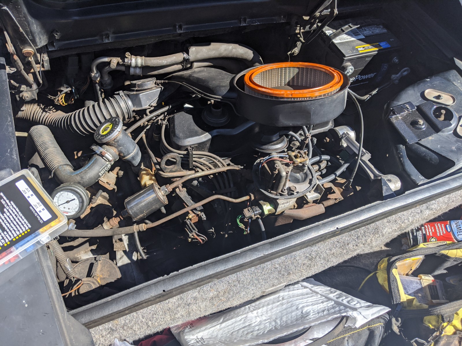

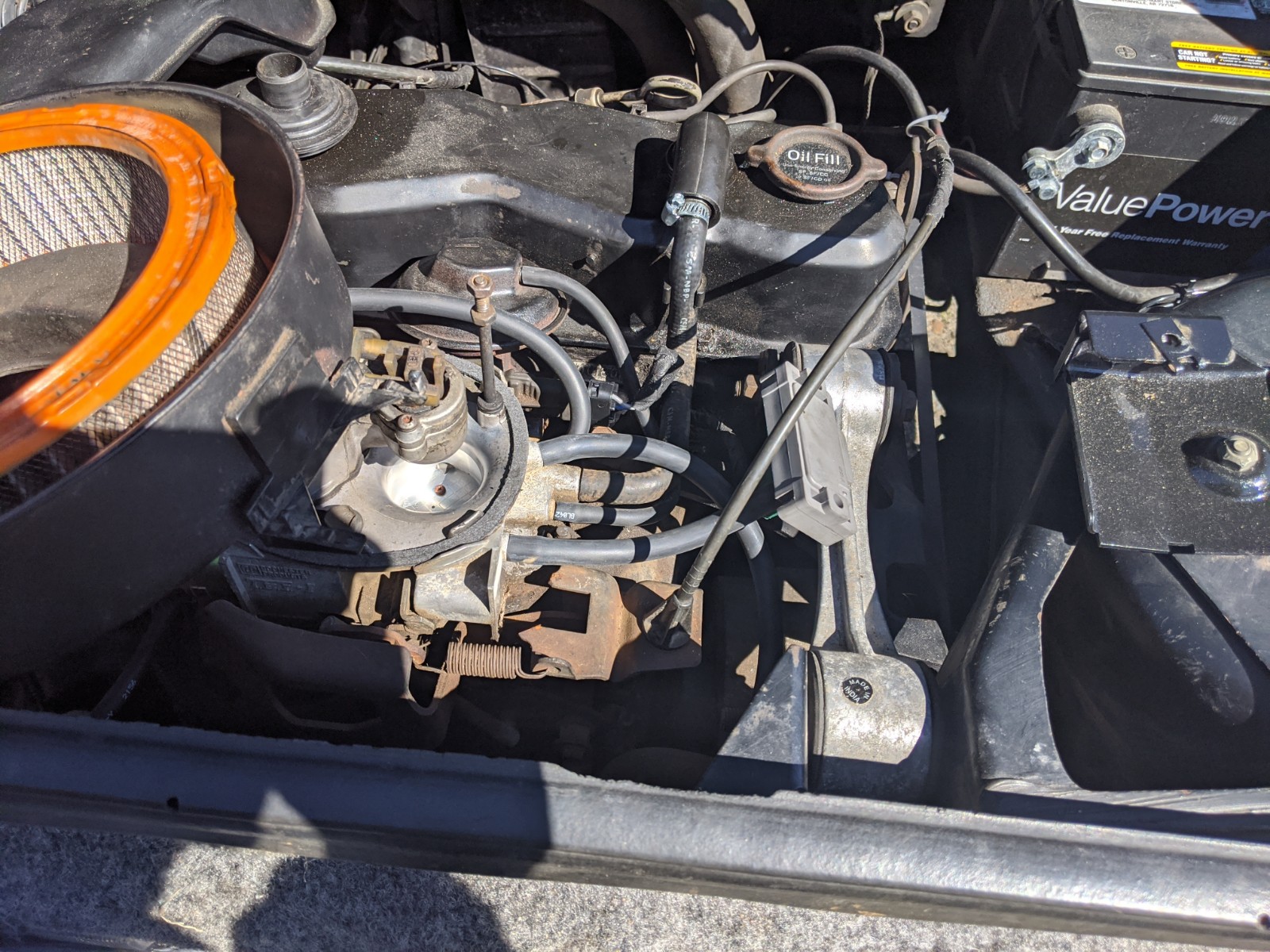

And that's the latest and greatest. Here's the engine bay as it stands now, a slight amount cleaner but not great.
AsaBergman MAR 15, 06:31 AM
Correct PROM and computer.
That temperature sensor looks to be ancient. I don't even know if you can get them with that connector anymore. Without using a scanner to see what the ECM is reading(like Patrick suggested) the only option is to just replace it. Note that the 84 has three coolant sensors: the one in the water neck is for the ECM, the one further back on top of the head is the gauge and temperature light, and the last is on the back of the head near the exhaust is for the radiator fan. The other two wouldn't cause the idle issue. You'd want to replace both the sensor and the connector with one like ACDELCO 21352 or a cheaper version.
