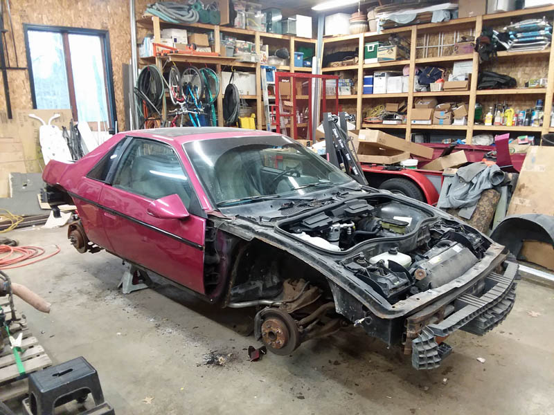

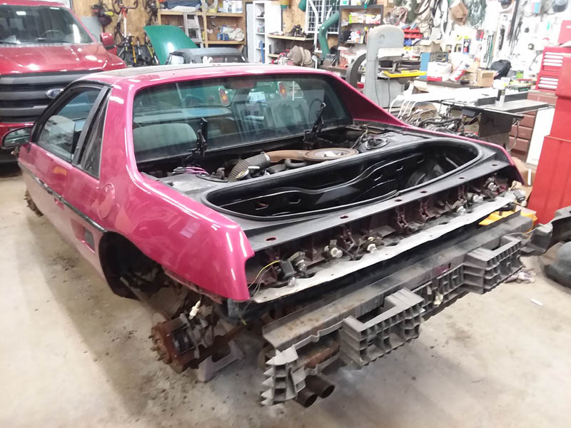

JAN 09, 04:10 PM
I'm starting to get into this and finding some oddities. This is a base model 4 cylinder automatic, but the rear fascia, according to the shop manual I have, is a GT. It has two exhaust cutouts, small tail lights in the lower fascia and it fastened at the top with vertical fasteners into the space frame. (See the photo above) Now I'm wondering if it got hit in the back at some point and had the fascia replaced.
Is there any trick that allows removal of the plastic blind fasteners for the body parts or do they just have to be cut off and replaced?
I'm finding a lot of surface rust, as expected, but the only damaged part currently seems to be the plate that runs under the radiator.

The blind fasteners have a centre pin that you pry out(about 1/2",not all the way out) and then you can just pull them out. If they are the ones I am thinking of. There are also plastic rivets that are not reusable. Maybe you have a rear fascia from an 85 GT ?

The rear fascia on your car is from and 87-88 coupe or Formula, not the GT. If the car is an 88, that is the original/correct rear bumper. You should be able to access the fasteners after removing the tail lights, they should pop off with a screwdriver or pliers if they installed it with the same fasteners as what it originally came with.
If the car was originally blue, it's an 87. The VIN will tell you the year for sure. The RPO code sheet will also give you the original paint code.
Frame rot on Michigan cars typically starts at the upper rear frame rails

Well, some progress on this. The frame is rusty, but nothing like rust through. I've got it far enough apart to get a decent look at the upper rear frame rails and they are solid. It looks like the only rust throughs are the pan under the radiator, the battery box, and both sides of the trunk. All that looks like relatively simple sheet metal weld in, so it's all doable. Next step is to drop the engine cradle so I can get to everything.
I've adjusted my plans a bit. I'm going to proceed with the frame derust/encapsulate, the suspension rebuild/upgrade and the body repair. Also the interior repair. Since the 4 cylinder engine/transmission are OK, I will probably reinstall it after everything else is fixed to get the car on the road. Then I will start working on the 3800SC swap. I've got the 3800 but it can sit in the corner until the rest is taken care of.
