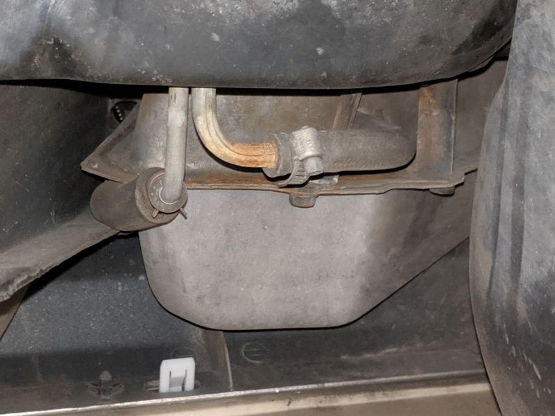

James_GT
NOV 29, 07:40 PM
87-88 Fuel Expansion Tank - as seen from underneath the car, ahead of the rear-right wheel
I've been looking into this lately, as the source of my fuel vapour leak

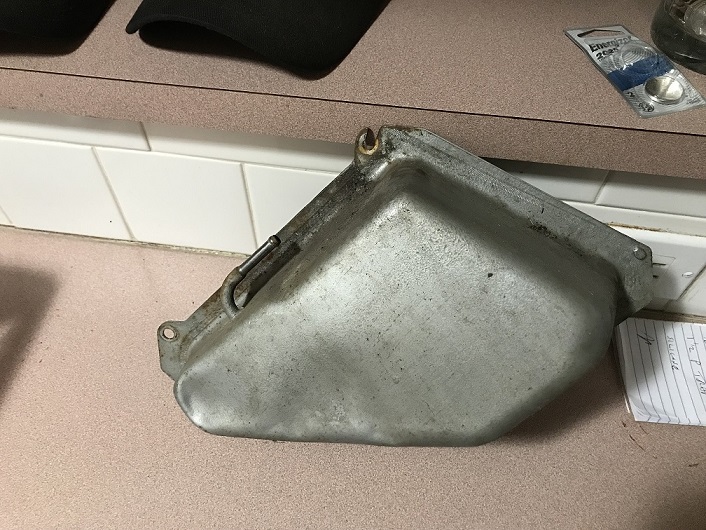

TXGOOD
NOV 30, 09:52 PM
Thanks for the comments. I pulled the tank out today and probably tomorrow will try to clean out the lines. Tank looks good and someone must have had it out in the past because the front mounting hole has been notched and I saw a thread that showed someone had done that very thing to be able to slide the tank onto that front top bolt without having to try to get the bolt started, which would almost seem impossible without taking the rear clip off. I don`t think the tank has been used for a long time as the vapors smelled really old.
