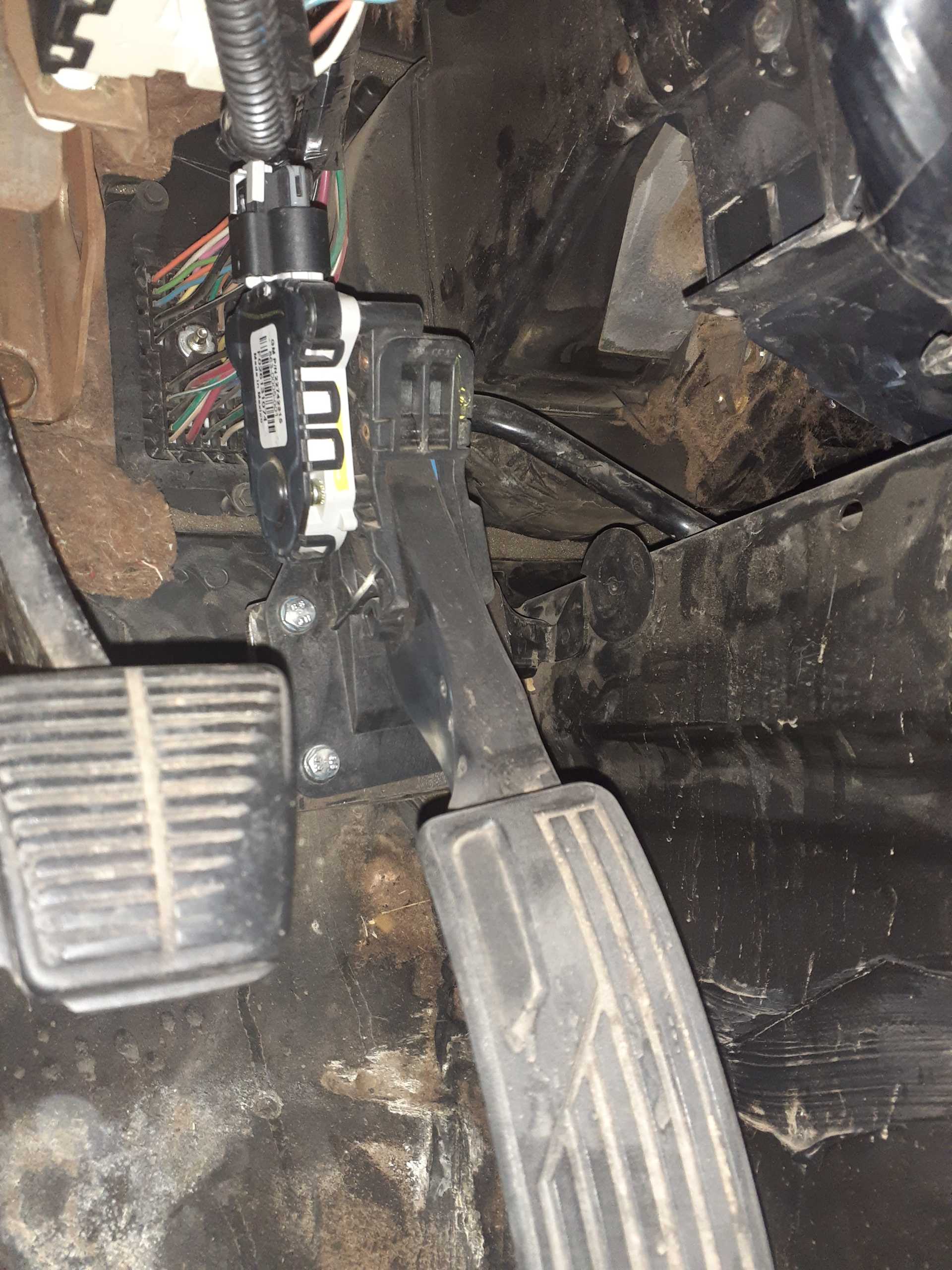

This sounds like a great project. What transmission are you planning on using? I imagine your accelerator pedal will look similar to mine. It is from a 2013 impala, my donor car.[This message has been edited by Daryl M (edited 07-21-2020).]
