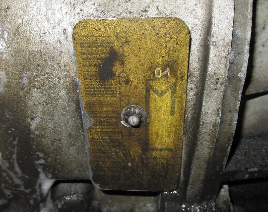

Gee, no technial discussion? Took the car to 4 shops today and got no 2 answers the same. First said clutches, but I said the car works in 2nd very well when manually selected. He said the clutches for the gear might be fine but maybe not the something-something clutches (maybe he said CT clutches or something?). That exceeds my very limited experience. The 2nd place I can't even remember what he said; maybe it was you probably got a bad unit. The 3rd pulled the stick with car not running and said it was low being the problem. I explained it has to be running to even read on the stick, but it was still low when I started the car. Added 1 quart. No changes at all. Took to the 4th and he said look at the electrical connections, or a flattened pin in the connector. Possibly a solenoid. My orig trans data plate is ML. The STS is VL. Not yet sure if that means anything to the issue. But the DeVille Y VIN eng/trans sets I have are marked VN I think.
My original trans data plate, ML, and the replacement one, VL. Comparable data tag codes appear on Oreilly's site for compatible transmissions, so with reading that I'm reassured that the trans is compatible.
