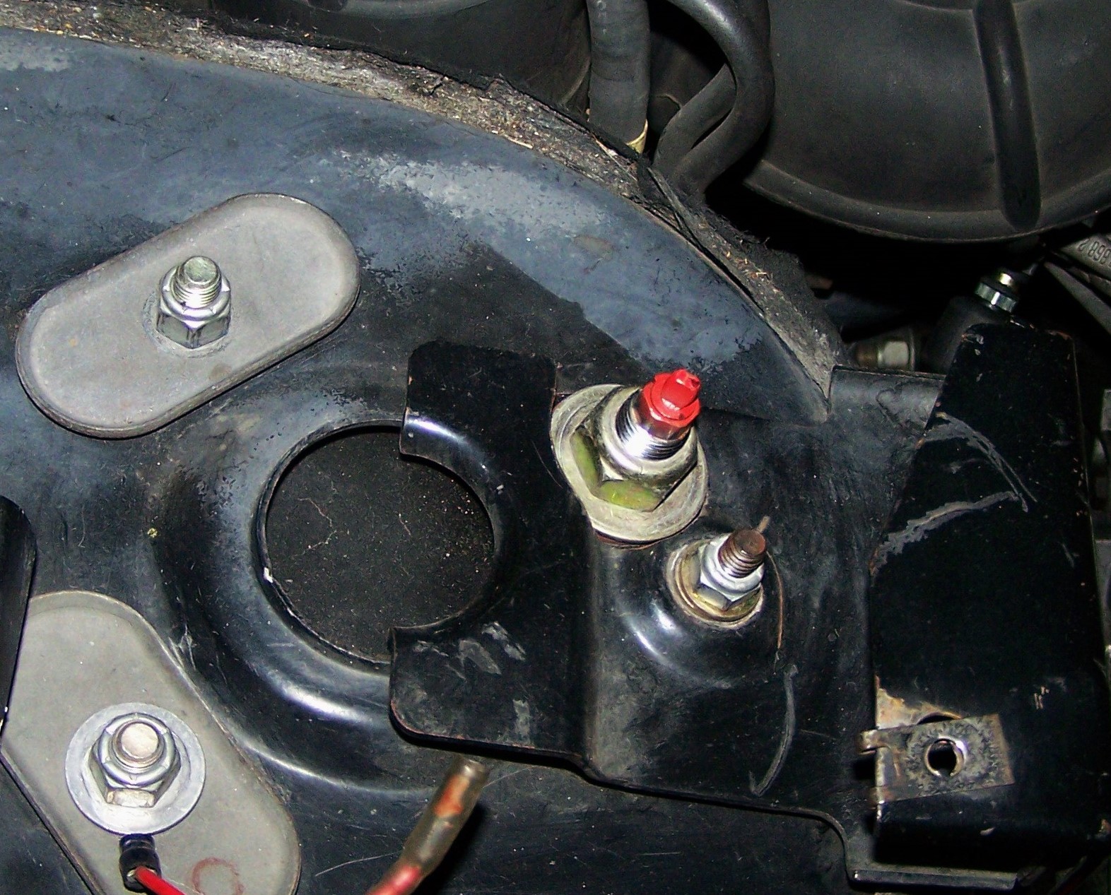

I bought a set of these from Arraut back ten years ago or so......A simple plate with three studs and the bushing holder and spring holder welded on...Not rocket science. No 88 rear subframe/suspension should ever go to the crusher! this is a great upgrade.
Why someone isn't making these is beyond me.....At least get a Template that people can print out with the offset that is needed. I have two friends who could weld something like this up with quality. But some people don't have access to a good trusted welder.
A few people don't want to make these because they don't look "Show quality"....Come on, this is the best driving upgrade you can do to the Fiero beyond HP increases. I carefully cut and ground the opening for this in my shock tower- A piece of 1/32" metal will fit between but nothing wider- all the way around. If you want show quality then make a cap that mounts on the top.

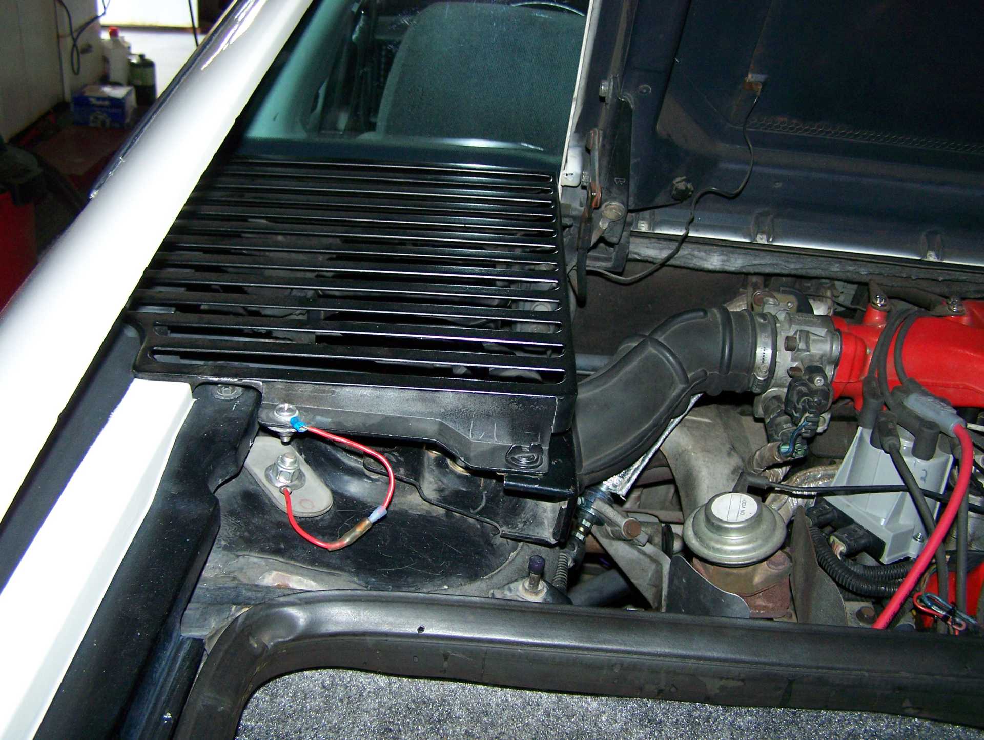

What is the purpose of the red wire in your photos? Is it a ground for the grill? If so, why?

Move the decklid ground from hinge to the vent/strut tower?

What is the purpose of the red wire in your photos? Is it a ground for the grill? If so, why? |
It is a ground- I have static sometimes on my radio and thought it might be because of ignition interference....

Do you have the shield plate on your decklid?

First, yes I have the shield plate but recently I tested it for ground and I suspect the ground clip is not making a good connection- I am considering how to solve that above and beyond cleaning/grinding the interfaces.
Two, thank you for the measurements, Arbakken.
Guru, I know what you said, and I was trying not to get personal....I even agree with you to some extent- I have spent the time since your original message trying to figure out some kind of strut-tower cap that could make it look really good- and I am apparently stumped. I will keep trying but if you smell smoke, send the fire department!
