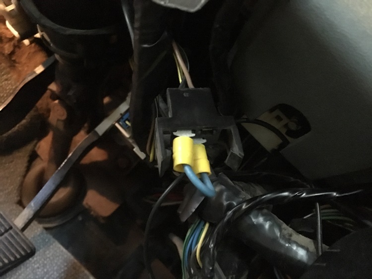

To find the relay, take off the lower valance that covers the steering column.It is on the right side of the steering column. Remove the relay and run a jumper from the yellow wire to the black wire. If your switch is still good it should now operate the trunk latch. If the switch is bad, remove it and momentarily jump across the switch wires. If that still doesnt work, the trunk solinoid is not getting a good ground and your will have to butcher the lock to get in the trunk.this is the connector with a jumper installed:

wftb, if the problem is that there is no ground to the latch solenoid, one can be provided as I described by using a key inserted into the lock, attaching a jumper cable to it and the other end to the frame. My brother had a garbage bag get over the latch hook when he closed it. He didn't have a key for the trunk and the jumper cable method is what I used to make the system work.

That is a good solution for no ground at the solinoid. I think all the bases are covered now.
