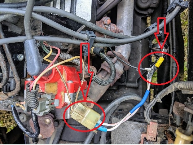

Ok, verified I do not have spark. What is this pig tail? it does not look stock. It looks like a capacitor that has been added to the coil power supply line. It is also grounded via the black wire to the exhaust manifold. This was covered in heat shrink. The white connector looks like it may have been stock, but this pig tail is connected via spade connectors. If this is a add on then I plan to remove it as the wires were burnt. I went ahead and covered the burnt spot in a new piece of heat shrink in case this cap is needed here. I also found the connector plugged into the coil has broken insulation right at the connector, so I will be replacing the entire connector. I plan to replace the coil with an OE coil as well.

I have no idea what is going on there.....a grounded capacitor?[This message has been edited by Gall757 (edited 08-06-2019).]

So I take it this is not supposed to be here? I mean it was running with it before, however if it is not supposed to be there and no one can tell me why this would be here and it is not a stock item then I will take it out of the loop.

So I take it this is not supposed to be here? I mean it was running with it before, however if it is not supposed to be there and no one can tell me why this would be here and it is not a stock item then I will take it out of the loop. |
It looks like a home-made tach filter.....but let's hear from the wiring experts...(which I am not).

Well between the coil and new pig tail there is life in my "Hiccupp". It fires up at a key bump like it did before and is running like a top. I did eliminate the odd grounded capacitor set up but I did keep it in case another problem arises, but if it is a tach filter like you suggested then I will order the correct set up from the Fiero Store. I will look into the fuel pressure issue as well, but now that i can drive her I can get her to a lift which is always preferable to my gravel drive... Thank you all for your help in figuring this out! I will reset the ECU codes and see if the 33,34,42 codes come back. It does look like the MSD coil was again the issue here. This did give me the opportunity to clean up the previous owner's wiring job. Now that I have my Fiero running like a top again I get to tackle the power steering on my truck... No PS in a 2800 pound car is a lot different then driving a 6000 lb truck.

Gall757 is 100% correct, the yellow cap is somebody's idea of a tach filter. The factory filter contains two capacitors wired between ground and the signal wire from the coil to the tach (those two wires going to the factory connector you've circled). There is also a inline resistor between those two capacitors on the signal side.
