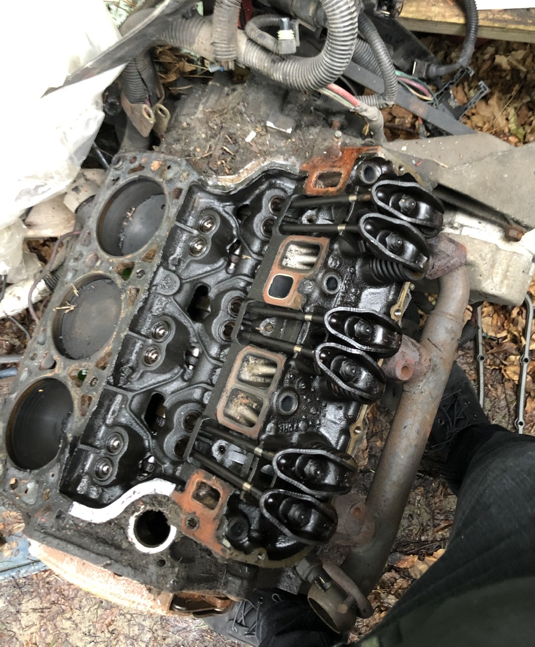

I learned first in an old engine that I bought cheap.

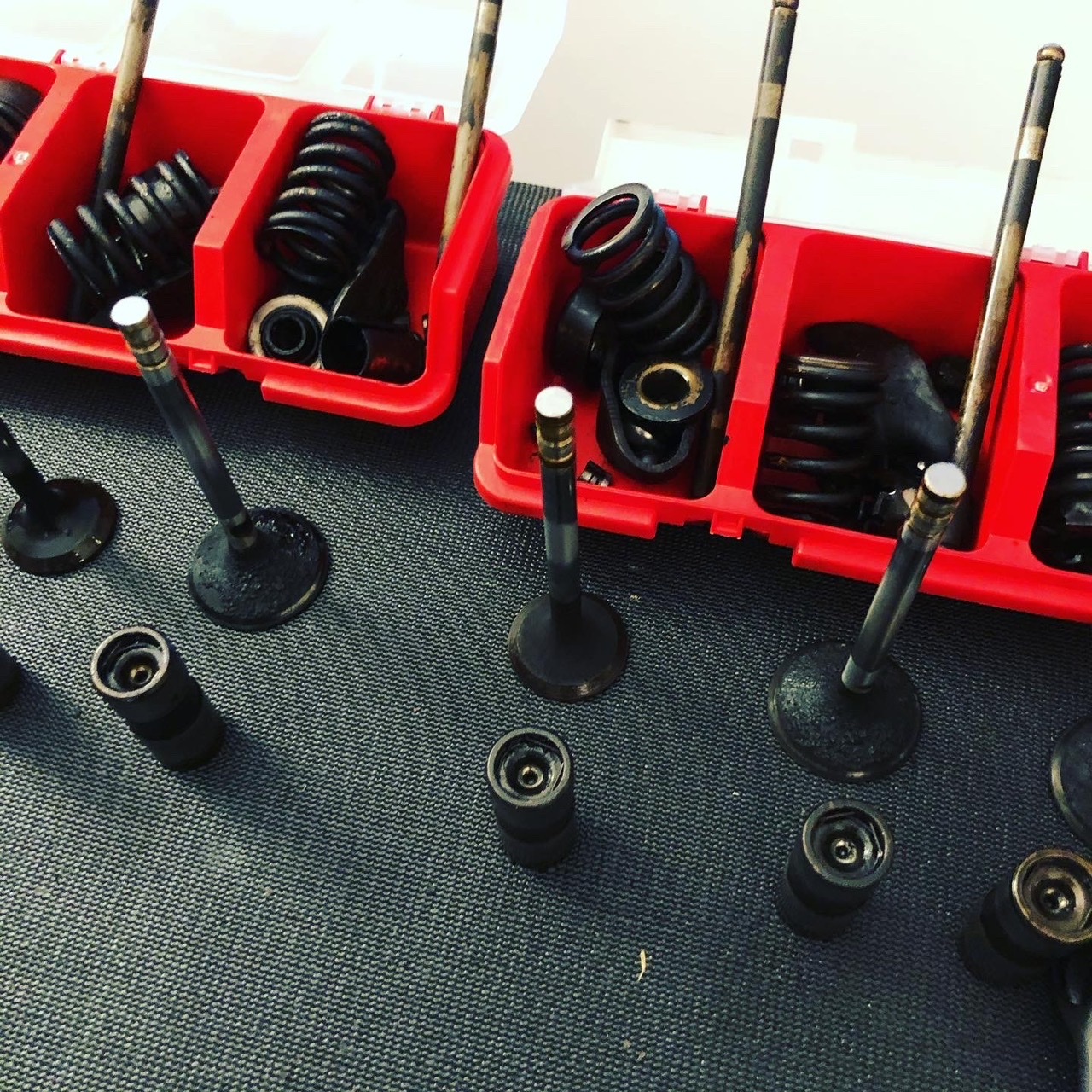

Here I am now: Cleaned the valves (none damaged), valve-lapped them, replaced the valve seals. Sent the heads for inspection and removal of a broken bolt. Cleaned the engine block with gasket cleaner. Checked the lifters. Replaced the fuel injectors seals. Prepared the valve covers for fresh paint. Cleaned the lower and middle plenum.

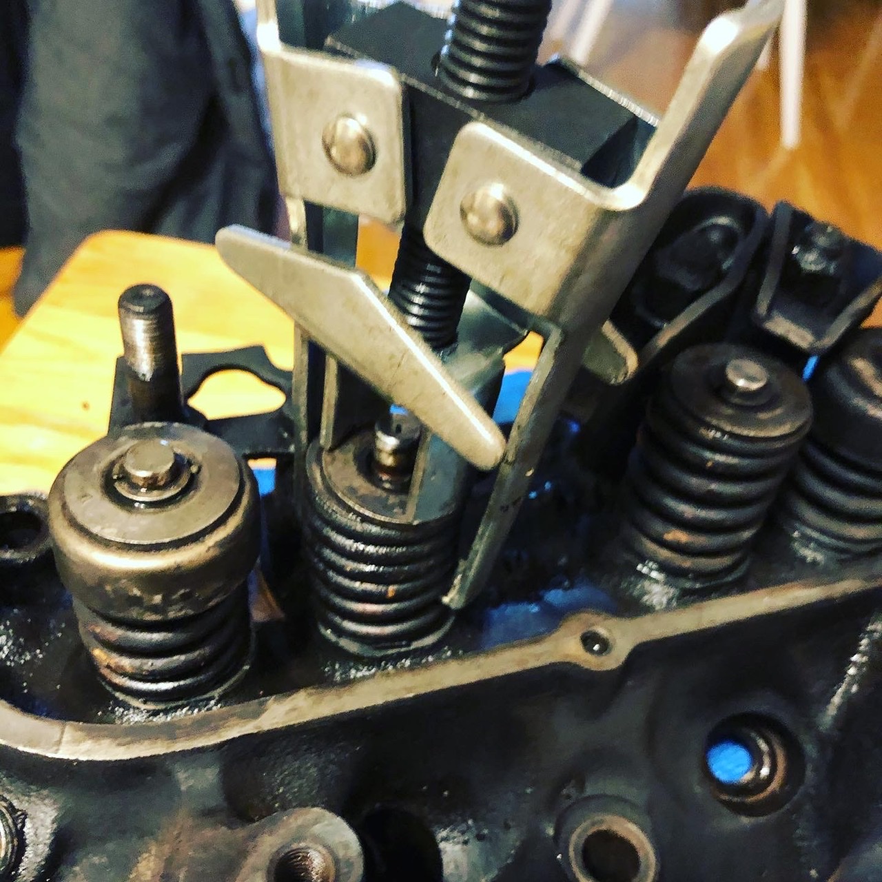

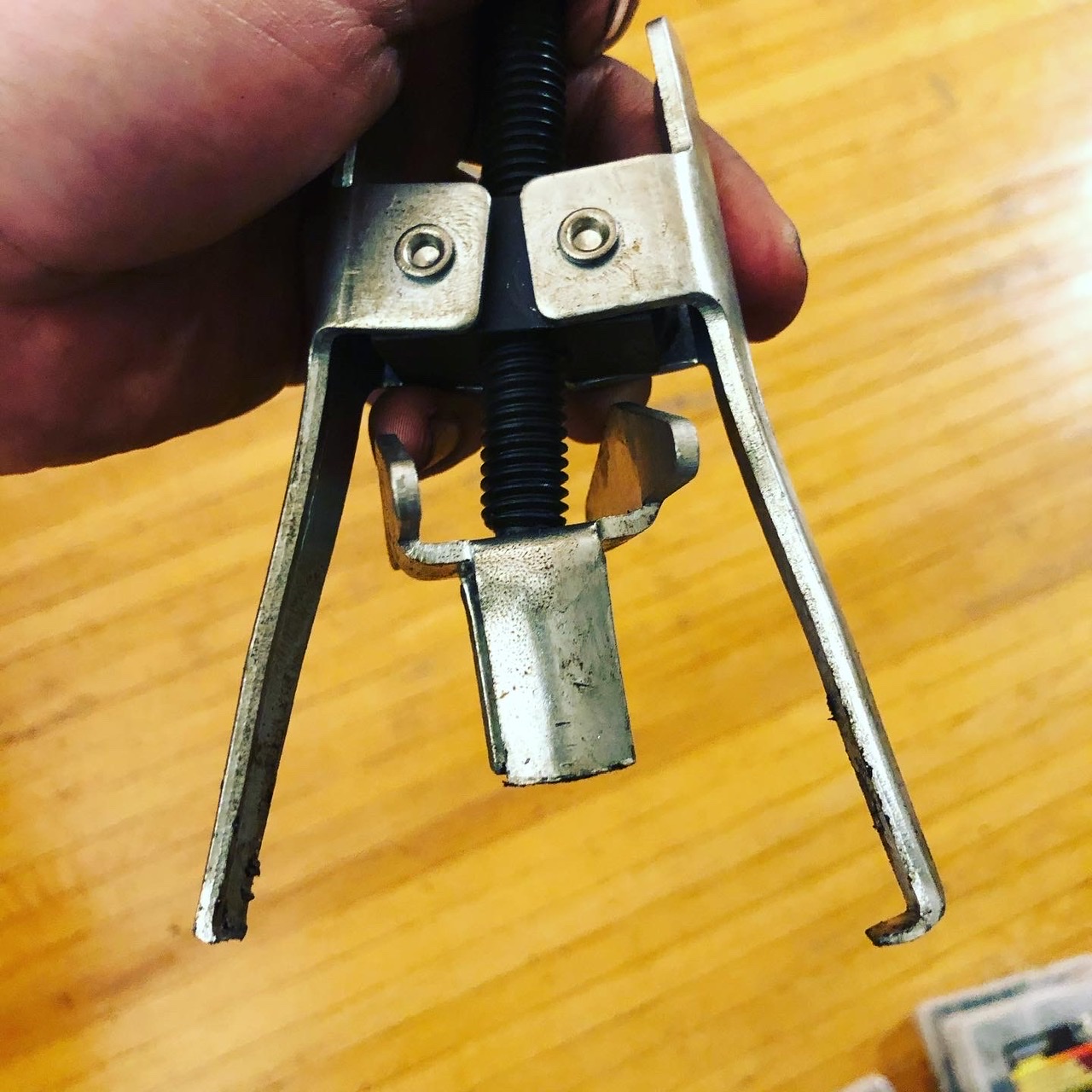

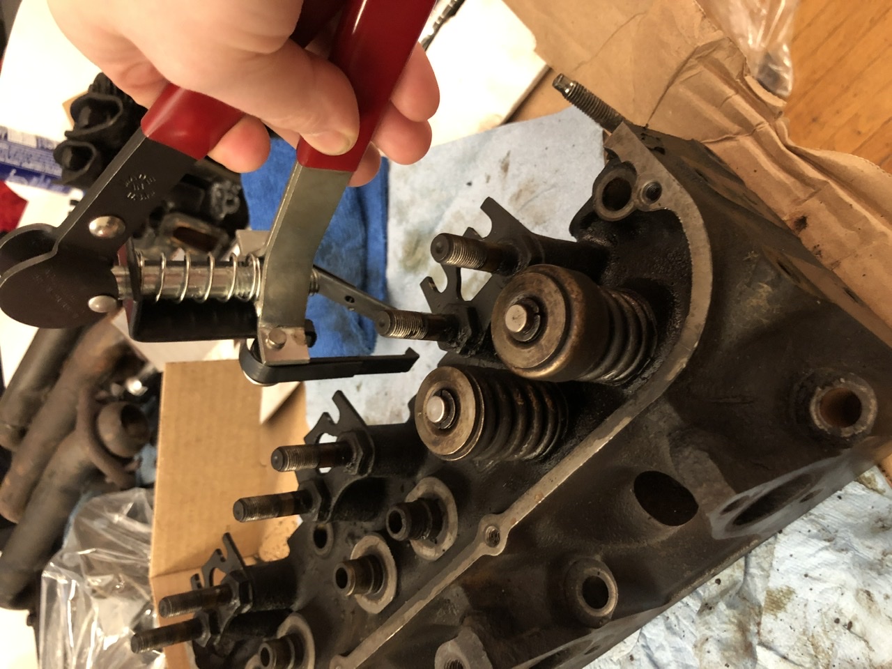

The thing that took most of my time was removing the springs, maybe it was not necessary, but I was already there, and with the same idea of learning, I decided to do it. The first time alone it took me one spring a day. That's why I hesitated to work in the car again...
Yesterday I did it again with a friend and we did the all the springs in one hour. But my hands are sore of using the compressor.
Chasing the threads was almost therapeutic, did it 3 times in each hole. I didn't want to make a mess in the cylinders so I didn't clean the carbon build up. I feel that once the heads are back in the car, the next of the steps will be easier (I hope).

It was a very good practice tearing down the old engine, having it on the floor and with the chance of working from any side helped me to get it disassembled in one hour. Then, in the car I could remember where the bolts were. Now I am using the 86 as a guide to reinstall everything.
