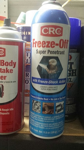

Try some of this stuff. A few weeks ago a friend of mine spent hours trying to get an O2 sensor out doing all the things you did to the axle nut except heat. I told him to let me give a try. I sprayed this magic formula on the sensor and timed it for 90 seconds like the instruction said, maybe a little longer. Grabbed a Harbor Freight breaker bar and a socket and it came free using 1 hand. I know an axle nut is torqued much higher than an O2 but rust is the common problem with both.
I got my Freeze online at Amazon.
