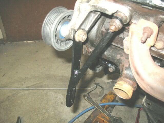

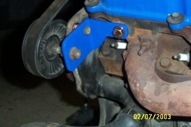

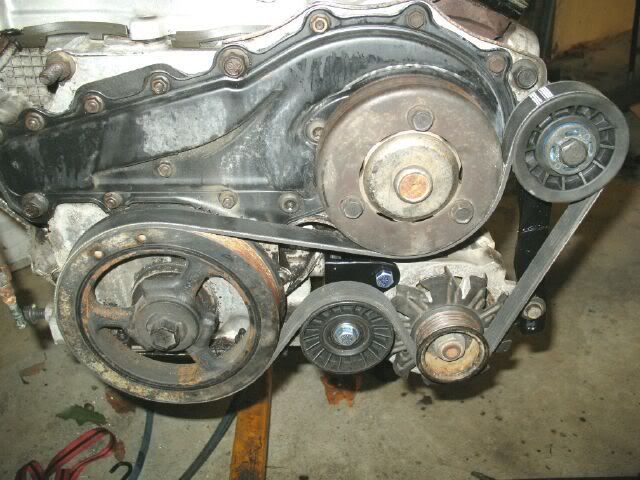

fieroguru, After looking at that idler bracket again, I agree with you about it being too weak. I think a steal bracket is a much better idea, good call. I think I will fab one up before I hit the track. As far as the belt path, looks good but it would hit the front of the water pump housing. Yeah, I tried at least a dozen variety of paths and brackets and the front of the water pump housing always gets in the way! Very frustrating. So I agree its not ideal but it is with in the physical limitations of the water pump housing. So as "much wrap as possible" is limited by the configuration of the water pump housing in this situation. There is still a lot of trial and error with this set-up. If it becomes a problem I will address it them. Thanks, man! Cheers
I broke one in a N/A application, which is why it is suspect for booster application. On one swap I made a new steel bracket, on another one I reinforced the back side as part of my alternator bracket.
Here is another belt path that might work. It takes a little trimming around the timing tab and scope tube, but I used a similar belt path on another 4.9 swap:
