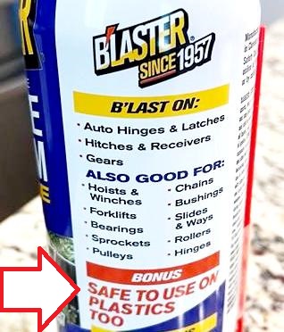

Thank and Blaster High-Performance White Lithium Grease has great reviews...
However, I didn't find that it was "Use on Plastic" - until I saw a can on the internet:
Sweet!
