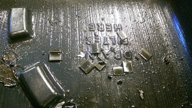

The 20w50 did not raise the oil pressure, so I am going to pull the bearing caps and check them. In the oil pan, I did find these little pieces of metal. Not sure what they are.

Those bits and pieces definitely look like rod or main bearings.
You are gonna have to do a rebuild.
Once the bolts are off the caps, you have to gently tap the caps and they will work loose.
I have heard of people replacing these with the engine in car. They are able to reach around and insert new bearings. But, if you spun a bearing then you crank is scored and needs refinished, and then fitted with the appropriately sized bearing.
