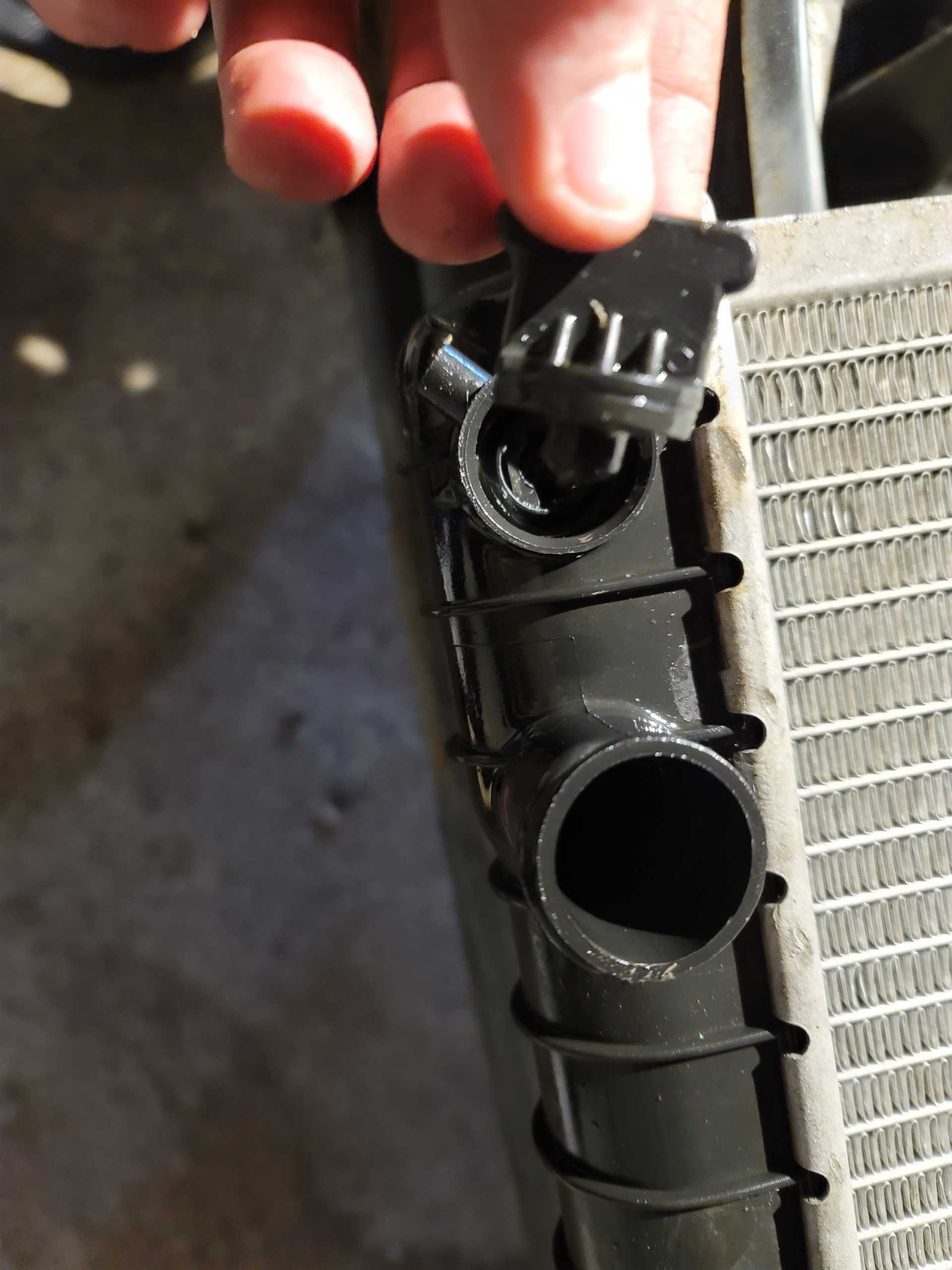

Well I found the culprit. The leak was indeed coming from the drain plug. Funny how things break a few weeks after the radiator's 2 year warranty. The drain plug is two pieces and the clip that the plug screws into was cracked causing the plug to be unable to thread in and tighten. Unfortunately, the clip is a very odd plus (+) shape and none of the parts stores had anything that would work. On the bright side I was able to contact the radiator manufacturer, Spectra Premium, and they are sending a replacement drain plug to my house for free. If all goes well I'll head back home next weekend and install the new plug and put the radiator back in. Gotta love plastic parts!!!

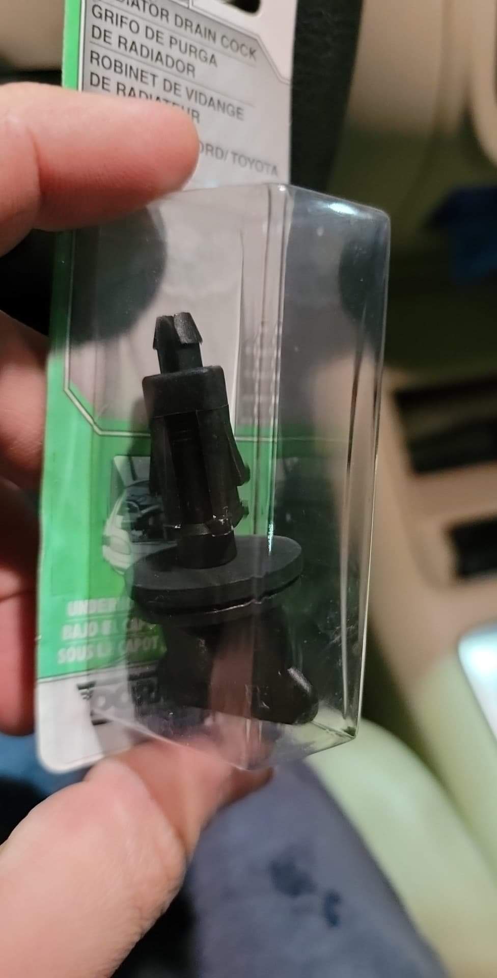

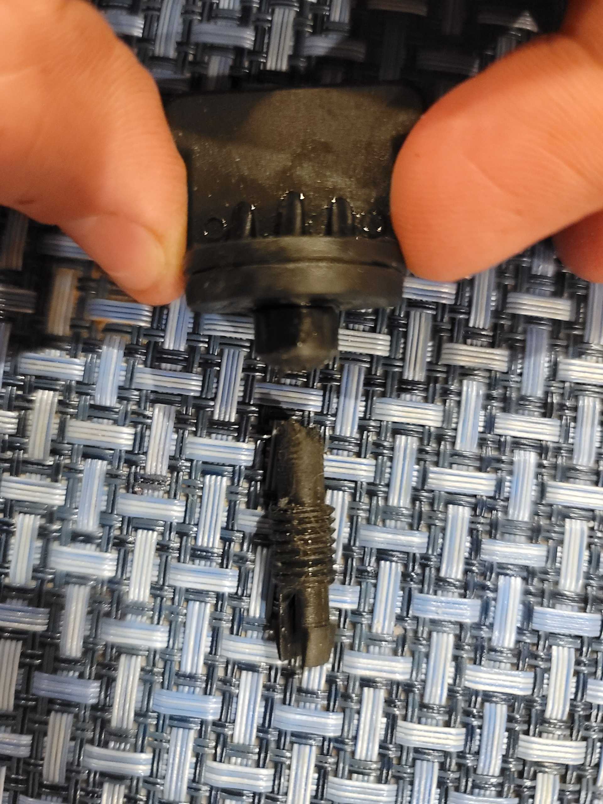

Agreed, ogre and reinhart. I've never touched the knob, but while working on my front end I noticed that the plugs handle was bent and broken. Touching the thing revealed the plastic was cheese - apparently from glycol penetration into cracks in the injection molded silcock ends.
Luckily, I was able to fish out the 'bits' of goopy plastic, flush the radiator a bit to remove any lost solids, and replace with Dorman 61109 - dimensions were identical to the old plug, and installed fine!
Link to the one I bought:
https://www.autozone.com/co...-plug-61109/1049_0_0
