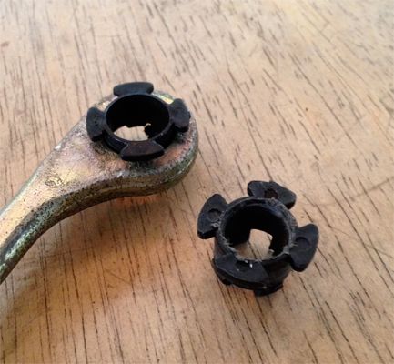

I'll take a look again, but I couldn't find any kind of clip holding the banjo in.
The new banjo eyelet hole was plenty big to fit over the pin, but the plastic bushing was just slightly too small to fit over it... can I get a bushing that will fit on its own?
Plastic? Rodney's adjustable banjo (and the new master) comes with a brass bushing.

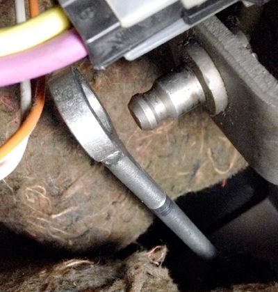

What's odd is that the pin on my clutch pedal has a lip on it and looks different from the ones pictured on rodney's site. There isn't a hole for a retaining pin or cotter pin. I'm not sure what the correct bushing for it is, but the one that was on there already was plastic with 4 little tabs sticking out.
My Fiero: 1986 Pontiac Fiero GT, V6, 4-speed manual
FieroCat MAY 09, 07:07 PM
Here's a pic of what the pin on my clutch looks like, and the plastic bushings. One slightly smaller than the other, though only slightly:
fierosound AUG 29, 01:12 PM
I was having a similar problem. The brass bushing fits the stud fine, and it fits in the banjo fine.
But trying to get all three parts together hasn't worked so far because of the offset - they will line up when it's together.
Even light tapping didn't help. The bushing is too precise - an extra 1/1000th of an inch clearance on ID and OD may help.
I took off the nuts securing the Master Cylinder. Once clear of the studs, it can shift 1/2" toward the fender.
The the banjo and pedal line up enough to go together and you can shift the Master Cylinder back onto the studs afterwards.
(should have thought of this earlier)
