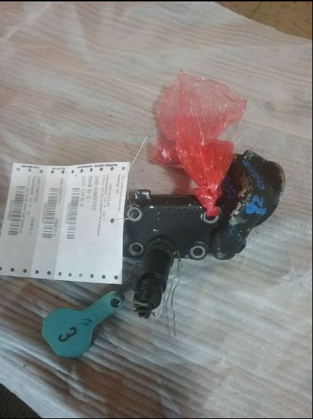

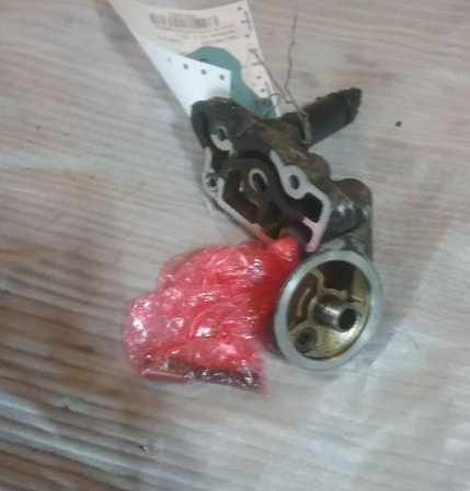

Is this what you are talking about?
Thanks
jon------------------ Astronomy says we will find a coded signal from outer space. Then we'll KNOW that life exists there, for coded signals aren't by chance.
I'm the original owner of a white ' 84 2M4 purchased Dec 10, 1983 from Pontiac. Always garaged, no rust, 4-wheel drifts are fun!
APR 24, 01:10 PM
| quote | Originally posted by longjonsilver:
Thanks
jon
Don't believe that's it. IIRC, thats the one that pushes the filter back on an angle to the side. Never used it but don't believe it will clear the axle.
