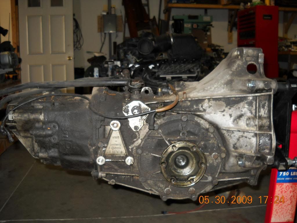

The next thing was the engine. I almost bought a Cadi with a 4.9, but I really wanted a all aluminum NorthStar 4.6. I passed on that car and continued searching. I found one in a U Pull junkyard. I wanted to keep the computer and wiring harness intact and didn't want a hack job in removing the engine from the car by the yard crew so I did it myself. It took two days, about 6 hours total. Here is the engine.

The next thing was to take lot of measurements to determine how much a strech I would need to fit the engine and trans. I figured that I only needed 10 inches of strech but rounded it up to foot (12 inches). I removed the old Iron Duke 4 banger, then blocked the car up and made a frame cradle to keep the back half car from falling to the ground. I marked the top frame rail 4 inches from the firewall and the bottom frame rail 6 inches from the firewall. With a new blade in the trusty swazall and the car on blocks and the frame cradle it was time to cut it apart. Here are pics of the results.
