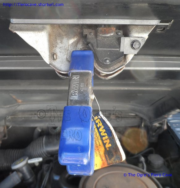

JUL 13, 06:37 PM
Can remove the bulb...
86+ Trunk lamp and Dash Ajar is on w/ black switch on the latch.
Can just make something to push up the arm on the switch w/ or w/o closing the latch itself. Spring Clamps 1" or larger works. You "clamp" the latch to pushing up/in the lever not "clamp" the switch.
OE trunk lamp for Fiero is some of the worse designs. A lot of better ways and won't blind you at night.------------------ Dr. Ian Malcolm: Yeah, but your scientists were so preoccupied with whether or not they could, they didn't stop to think if they should. (Jurassic Park)
