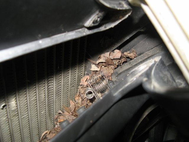

Here's what I found in mine. This is an original 23K mile car that spent most of its life in a garage.
.jpg)
If this car has it, your car has it!
Now, how do we stop it from happening again? Stuff foam around the front trunk latch?

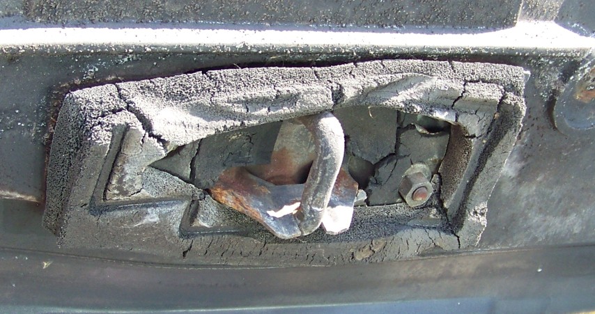

The area around the latch is just one way for the debris to get into the cowl area. After that it has to jump a little wall and fall through the hole that sits rearward of the latch. The latch does not sit over the hole to the air inlet. I'm thinking of adding something over the actual hole. Would a sceen or some kind of very low density foam be better to cover the inlet hole? Maybe a combination of both?

I think it all depends on where you park your car a lot. I figure mine took 24 years for the stuff that was in there to accumulate and now that I have moved, my car is always under a carport. Plus, wherever I drive it, to work and most places, I don`t park under any trees. I think if you periodically check it and maybe vacuum out through the resistor hole before it has a chance to get caked on, it will be ok.

Watch wiper pivot when that is on... pivot assm and the link moves plenty. Careful... wiper trans can cause damage to anything get pinches.
Latch casket will help. (Assuming all other parts are good too). Any trash/leaves/etc falls in the latch, can work into heater inlet. Whole leaves above means need a gasket or trim under windshield has issues.
| quote | Originally posted by TXGOOD: I think it all depends on where you park your car a lot. ... I think if you periodically check it and maybe vacuum out through the resistor hole before it has a chance to get caked on, it will be ok. |
Yes, I've clean mine once last month any not much really found... And old house had Maple next to driveway. See http://www.fiero.nl/forum/F...HTML/123258.html#p10
Just look into heater resistor opening... A mirror will help. A piece of bent wire will move the junk and vacuum can suck it up.
