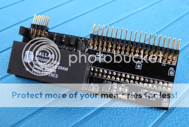

Here's the guts of the 1227165 with NVRAM installed - this makes it real-time programmable.
The 7165 has the same processing power of the 7730 with a lot less rewiring to install it.

Well, we can't get the 7165 ECM to flash any "Check Engine" error codes or communicate through the ALDL with any programs.
The ECM will run the fuel pump at "key on" so the ECM IS getting power and I guess it's not completely dead.
I think either the NVRAM board has a problem, or the jumpers on it aren't set right. Looking for documentation right now...
This thing replaces the stock memcal that the ECM would have originally come with. (this is picture of earlier version)
It looks like you can install the original memcal as well. Not really sure what the purpose of that would be.
I've tried this board with and without the memcal. The ECM still doesn't respond to anything.
[This message has been edited by fierosound (edited 04-21-2014).]
chetw77cruiser APR 21, 07:07 PM
Based on the information you have been providing, there is a good chance the NVRAM is at fault. I have been having issues with the new batch of nvram boards loosing their data. I have one in my car and ran into the same problem upon initial install. The NVRAM chip does ave a battery internal that has a finite lifespan, but this is to short of a time to be a dead battery I do have a different NVram board that works but without the setting jumpers. It is set up strictly for use in a V6 application and does not have the header for the memcal. It does have a battery that can be replaced.
The memcal installs on the side pins of the NVram board to provide the redundant fueling calibration. Basically this is the limp home mode.
