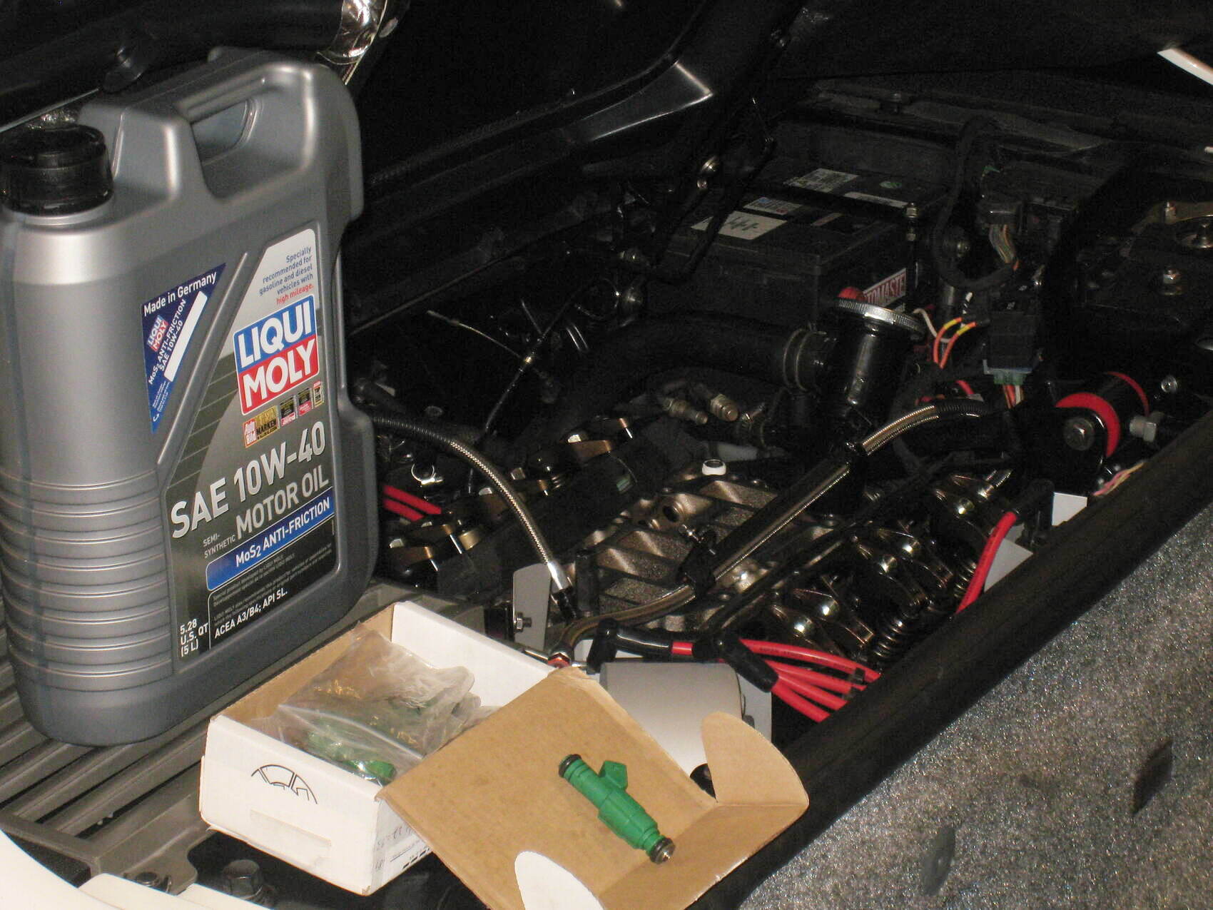

Spinning the oil pump with my priming tool, I see oil coming out of all 12 pushrods.
| quote | Originally posted by La fiera: The more pressure is exerted on ZDDP the more drag it develops between the sliding surfaces and that drag can induce overheating of parts |
From the oil coking near the pivot (and blueing of the rocker), we see that there was overheating due to excess friction. Everything goes downhill once there's overheating, so anything to reduce friction (and therefore heat) will help.
The other key element that affects the overheating is RPM; I am not sure if my tests in the 5000+ RPM range are too much for ball-pivot rockers.
I guess you don't add any extra additives to the Liqui-Moly oil in the picture? You use it straight from the bottle, or you still add your WS2 to it? This oil seems to be available in Canada.
I'm not sure if I should retry with brand-new rockers (the same as what I have now) and better oil, or if I should look into roller rockers right away.[This message has been edited by pmbrunelle (edited 07-05-2020).]

If I were you I replace all the new rockers and balls. With this Liqui Moly you don't have to add anyting else. It has 1100ppm Phosphorous and 1200ppm zinc and about 900ppm Mos2.[This message has been edited by La fiera (edited 07-05-2020).]

Nearby garage Momentum Motorsport will have a bottle of 10W-40 with MoS2 Anti-Friction ready for me tomorrow morning: https://mmsportmtl.com/
Grease loaded with MoS2 saved my butt with a wear problem at work (versus grease without it), so I have faith that simply changing the oil could make a big difference.[This message has been edited by pmbrunelle (edited 07-06-2020).]

After a long time in the mail, today I received higher flow fuel injectors from La Fiera. Thank you. In the spirit of sharing parts, tonight I will be carefully packaging a Fiero part for ericjon262.
I got the Liqui Moly oil today. It is expensive compared to Canadian Tire stuff. Cheaper than new rocker arms though... those haven't yet arrived.

I installed replacement rocker arms and the car is running again, for now!
I did not use the Comp Cams break-in lube that cam with the rocker arm set. From its MSDS, the Comp Cams lube contains (non-exhaustive list): ZINC DITHIOPHOSPHATE PARAFFINIC PETROLEUM OIL ANTHRAQUINONE DYE
If it is true that my rocker arms failed due to excess friction from a ZDDP overdose, then I should avoid using the Comp Cams lube, like I used during the initial engine assembly.
Anyway, repeating the same procedures and expecting different results doesn't make sense, so something had to change. I primed the oil pump with the drill until I saw the gray Liqui Moly oil flooding the rocker arms. I did not mix any additives into the oil. Three hours after priming (I didn't want the Liqui Moly to drain away for the first start), I started the engine and went on a half-hour ride, keeping the RPM between 1500 and 3500 RPM.
I will keep the RPMs low for the next 500 km or so, to give the chance to the parts to wear into each other. After the wearing-in, friction should be reduced, then I should be able to spin the engine to 6000 RPM without overheating the rockers (hopefully).
If these ball-and-socket rockers fail again I will probably look into installing roller rockers.[This message has been edited by pmbrunelle (edited 07-11-2020).]
