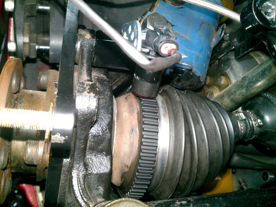

Daryl,
FYI...While coming up with a solution for a reluctor wheel.. I read/found that the E39 ecu as well as my E92 don't like low tooth count VSS signal rates at low speeds. In case yours does the same, I found and am installing one of the 32 tooth wheels from Davis Technologies...just slightly bored out their 1.75" rings to 1.768" for the saab/cobalt axle.

cyrus88
JUN 27, 04:26 AM
I did this for when I needed better VSS for my LT-1 swap. If you're interested in more info, I will be glad to share.
