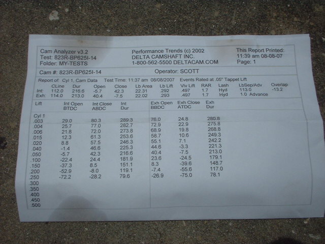

But since you brought the roller vs flat tappet cam wars back I'm going to give an example.
 This is Upson's custom roller cam for his monster twin turbo 3900 motor. His cam is a baby compared to my flat tapped solid. My 370 GTO cam has more lift (.497 vs .550), more duration @ .050 (216 vs 244) and way more area under the curve (faster ramps)! I'll let you guys figure that one out. Overall, my cam is more responsive, revs faster, deliver the power instantly without lag and without relying on altered atmospheres, all naturally aspirated.
I'm not saying I have more power than Upson's monster. I'm saying mine delivers the power way faster without boost. Can't wait to see what kind of power Mr. Upson gets!
I'm pretty sure that Upson's or any cam that WOT-Tech sell does not have more area under the curve or have faster and aggressive ramps than my 370 GTO solid flat tapped. Like I said before, lobe technology has come a long way from the bootlegger days!
