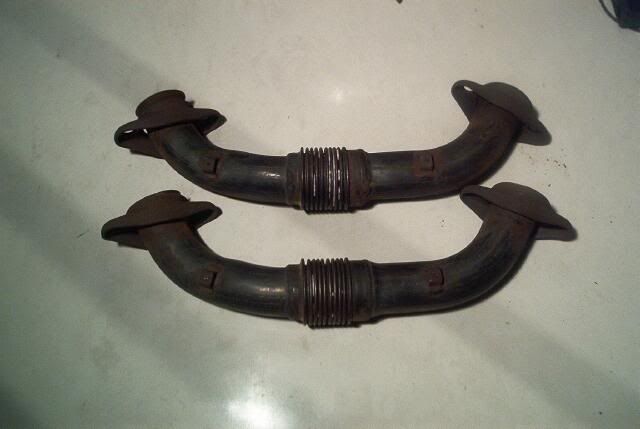

You really need expansion joints between the logs and the turbo. I did not use them on my first exhaust and each heat/cool cycle would bend the exhaust and turbo until things started breaking.
This is the 2nd attempt. It works great now.
This is how I found them in the junkyard. They are found on crossover pipes on front wheel drive GM cars.

Buy the size you need, they're available from the same place you purchased your tubing. Aftermarket expansion joints are usually sturdier than OE because they also have a braided steel mesh around the bellows. Although GM has done a better job with them by adding a sheet metal support underneath, the Turbo Grand Prix bellows had a history of cracking and coming apart. If you want to use OE which I've never had a problem with like what's pictured above, get the crossover from the 3500 and up cars as they are larger than what was placed on the 3400, ~1.75-2.00" if needed, I didn't measure it. You may also find the better joint in the exhaust pipe of some imports as they are usually braided also.
It's 4" long, the camera is bending the picture in auto focus, it also has an inner interlocking liner for smooth airflow through it as opposed to exposed louvers.
