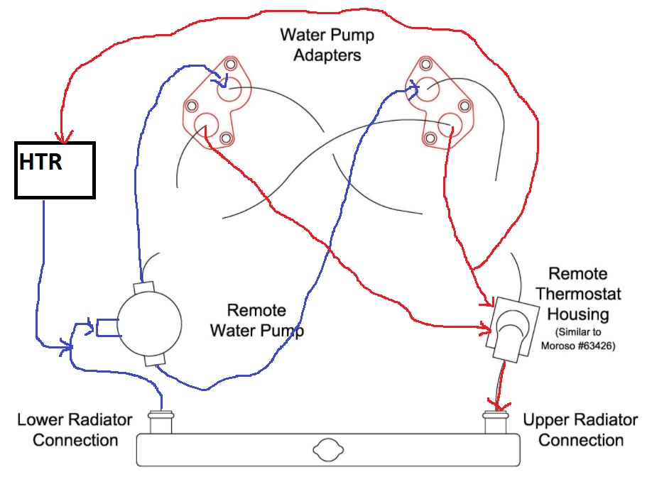

Could I use a T fitting vs. Y fitting (AN fitting) ?
I don't understand the question.

This shows Y fittings ... but T fittings are a bit cheaper .

BTW the LT-1 cooling is "reverse flow."
So, looking at your diagram, the coolant routing from the output of the electrical water pump should go to the top fittings on the engine-block-adapters. The bottom fittings go to the thermostat housing.

| quote | Originally posted by cyrus88:
Here's a quick edit of your sketch: (This is with the CSR water pump)
Look at this diagram I posted a while back. Also don't forget to route heater hoses, or a bypass if you're not using the heater, so a small amount of coolant can circulate through the engine before the thermostat opens.

Great... figured as much on the fittings ... and got it on cool side on top..
