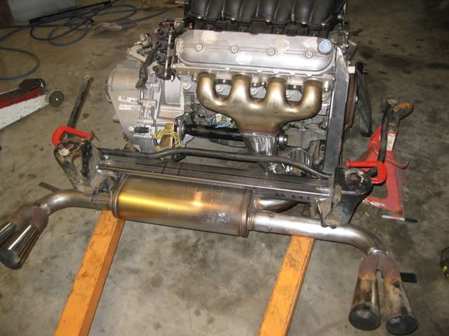

Can the front-bar-on-rear 84-87-style install be implemented on an 88 with really long endlinks to reach the knuckle/strut mounts?

Daryl M APR 25, 11:43 PM
He has a table of contents in the first post.
Your rear transmission mount will interfere with the stock 88 sway bar. It mounts right in front of the rear cradle mount standoffs. You can raise the bar a little higher than stock as well as shift it forward some, but there are limits of clearance. The upper set of bars is the stock 88 rear with the Addco 88 rear so you can see the general shape.
Here is where mine is mounted. It is shifted about 1" higher to clear the 2x3 crossmember.
I like this location, but I have a motor mount in the way. I'm thinking I could drill holes in the cradle tower, reinforce it, and use a sway bar with removable ends like this.
Will APR 26, 08:33 AM
I did that on my '87 Northstar car for a while. I mounted the bar to the bottom of the cradle, and used '88 sway bar brackets on the struts, swapped left for right so they extended to the rear instead of the front. I made rod-end links that were about 12" center to center.
Will APR 26, 08:35 AM
Hard to tell from the photos, but the rear bank catalyst might cause problems too.

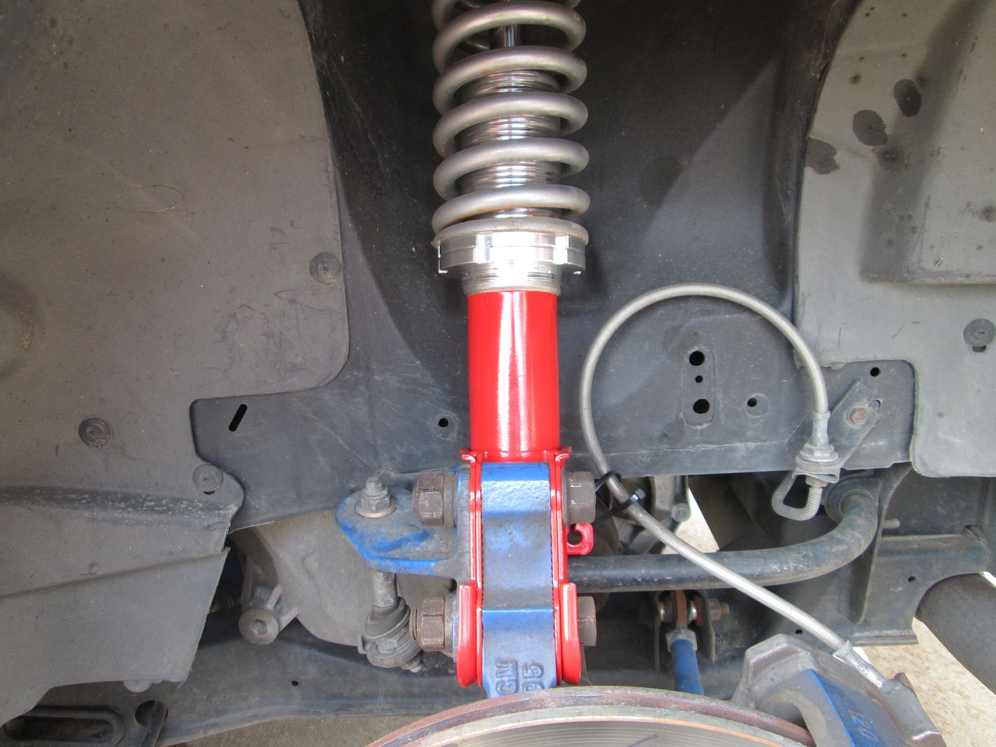

Guru,
This photo shows a sway bar mount attached to the strut bolts. What is that mount from?
Thanks,
Daryl

Will MAY 08, 09:17 AM
That's a stock '88 Fiero part.
fieroguru MAY 08, 05:22 PM
Yes, that bracket is part of the stock 88 rear seat bar setup.
Daryl M MAY 08, 10:11 PM
Any idea where I can find a pair? Are they only from a 1988, or do other years have the same parts?
[This message has been edited by Daryl M (edited 05-08-2019).]
fieroguru MAY 09, 12:15 AM
It is an 88 Formula or GT part. 4 cyl 88 coupes don't have them (unless they have been added).
