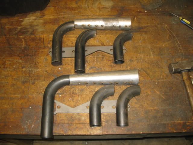

Quick and dirty sketchup of the headers, I was going to do a 3-1 style instead of a log, but these should do fine for what I need, and look good doing it.------------------ there's a Group on 60degreeV6.com for us 660 Fiero owners!

fieroguru
JAN 11, 08:57 AM
Looks good!
You could taper the main tube across all the primaries like this:
ericjon262
JAN 11, 09:16 PM
| quote | Originally posted by fieroguru:
Looks good!
I thought about doing that, but I want a 2" hotside, and the cone I found would end up at about 3.5" for the output, if this was going to be N/A, I would go for it, but as a turbo car, I want to keep velocity higher.
