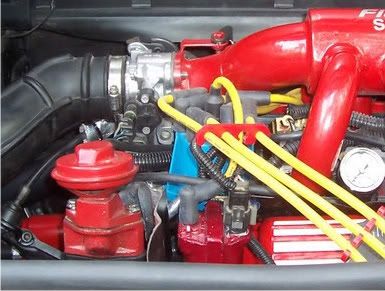

Someday we should change how the coils are mounted. I dont think the spot where they are currently is strong enough or cool enough since its right above the headers to be good for the icm. Also you could try checking to see if there are still leaks in the intake using a propane torch bottle.
When we ship opur headers we provide standoffs that let the customer turn the coild 180 degs and raise up both of which move it away from the Y pipe and EGR. No biggie to do, just lenghten a few wires.

Lou actually has the DIS coils now, since the 7730 swap. So the way i last remember it being mounted was by i think 2 of the 4 possible bolts which puts some strain on the bracket but also traps heat right under them too.
