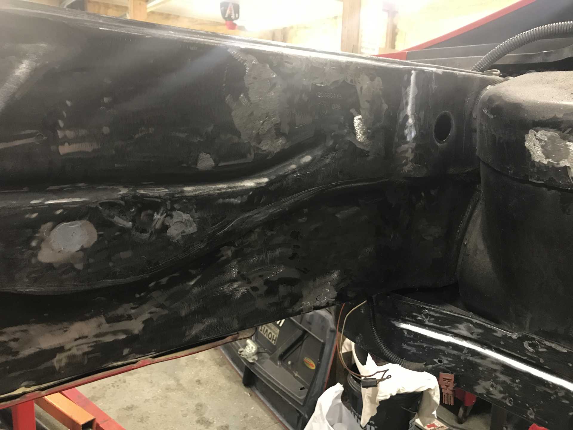

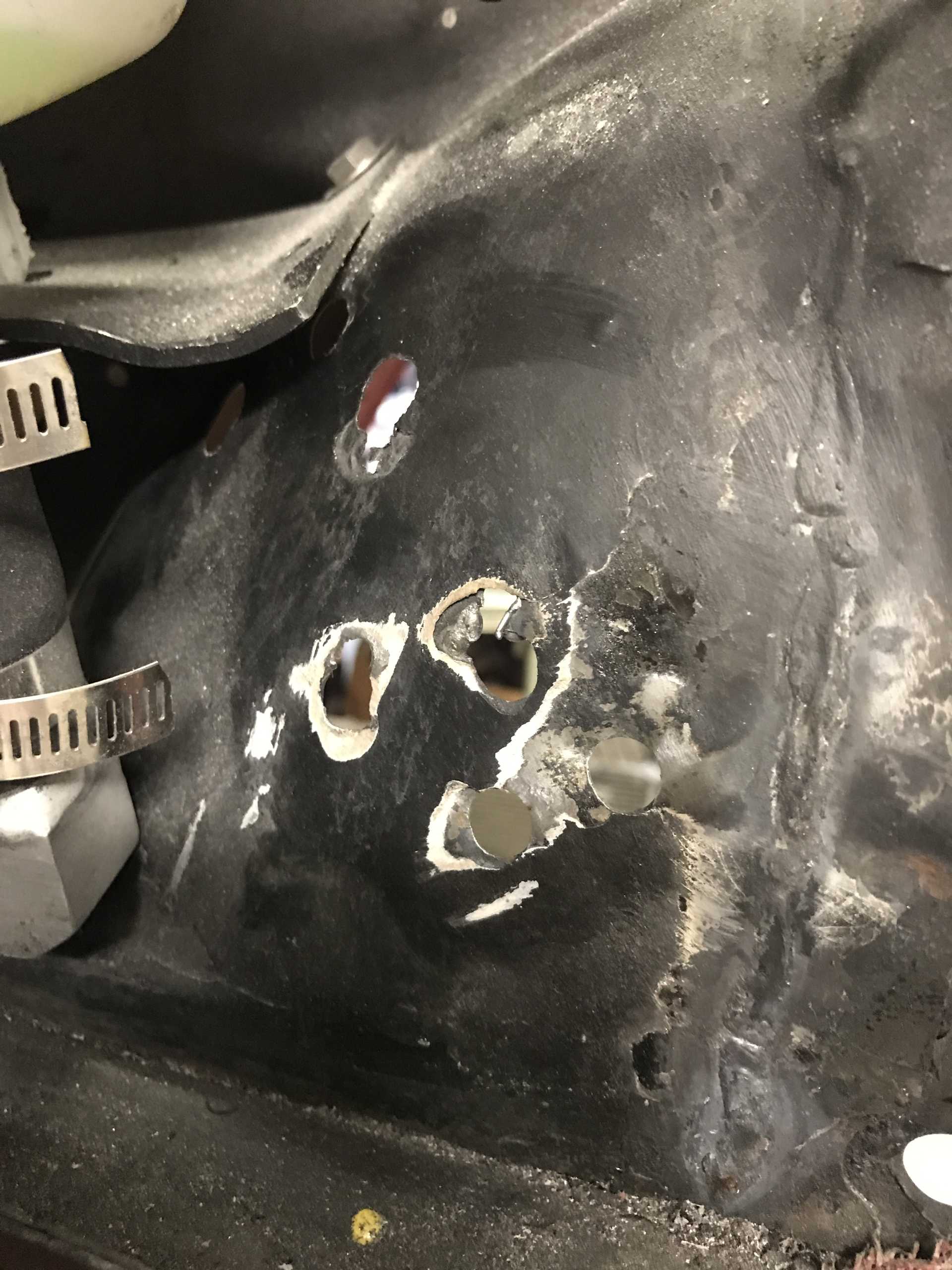

While waiting on things for the motor, I had time to make the engine bay nicer. I neglected doing this before due to time constraints… I was going to sand down and paint it, but I came to discover some bondo.
After drilling out some rivets, I pulled the plate off. Well that’s just dandy. The PO did a pretty good job covering this up with bondo actually. I am not sure what would have caused these rust holes originally. I assume the PO was cutting the trunk out to run something.

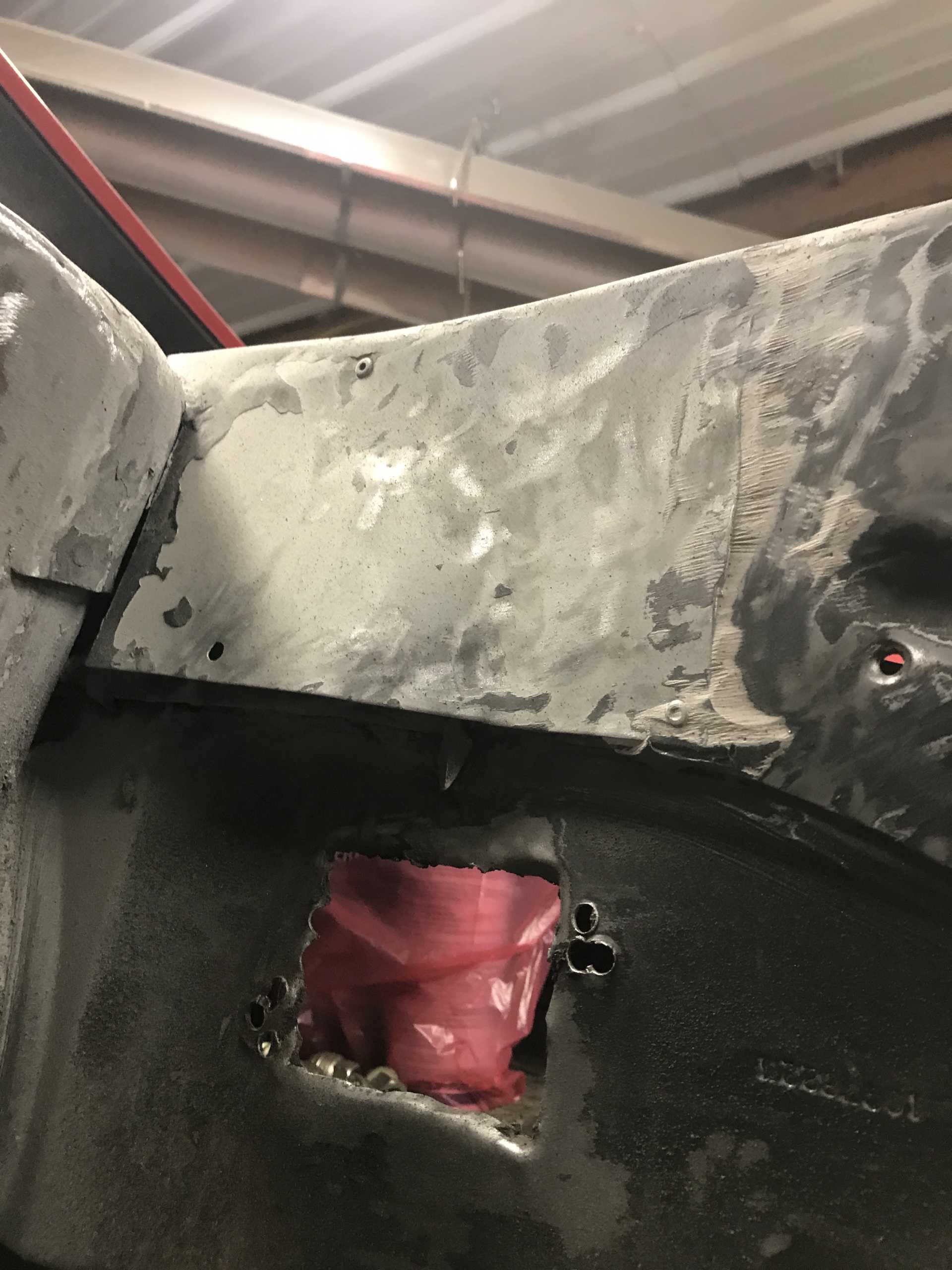

3/21/21

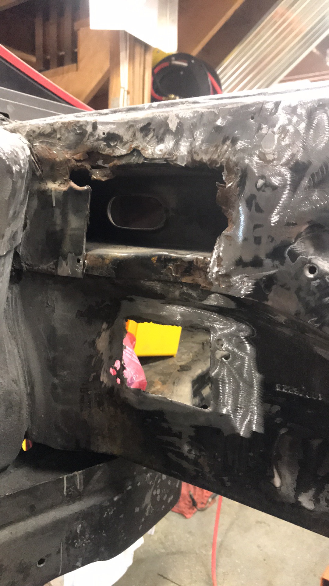

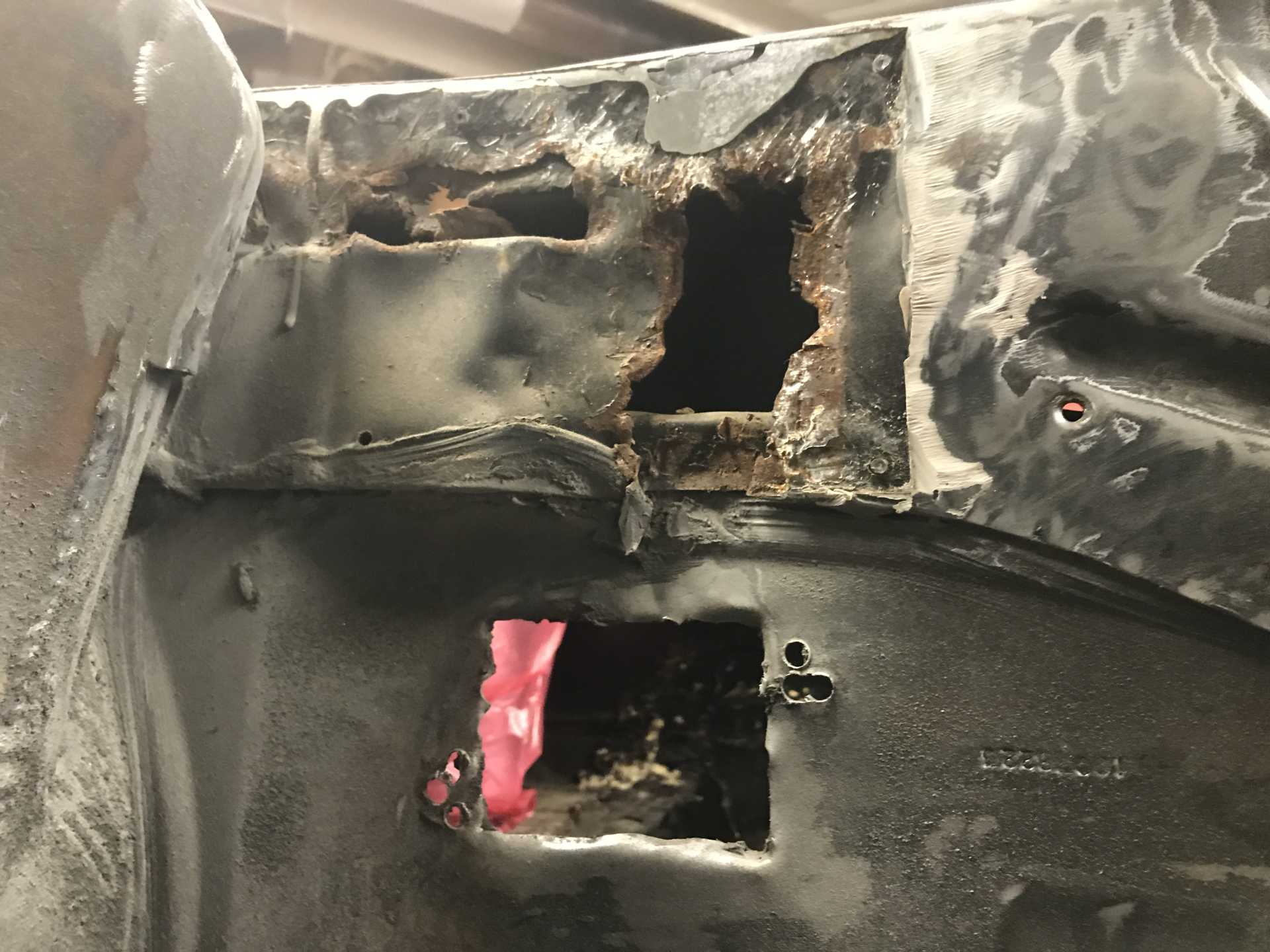

I was gonna take the time and fix it of course. I had to cut out a lot of the bad areas and make it much smoother so we could weld a fresh plate down. The bottom hole was there before, but that was gonna get patched up too.
I started to go a bit crazy with the grinder and delete the cruise control brackets and extra little ones.

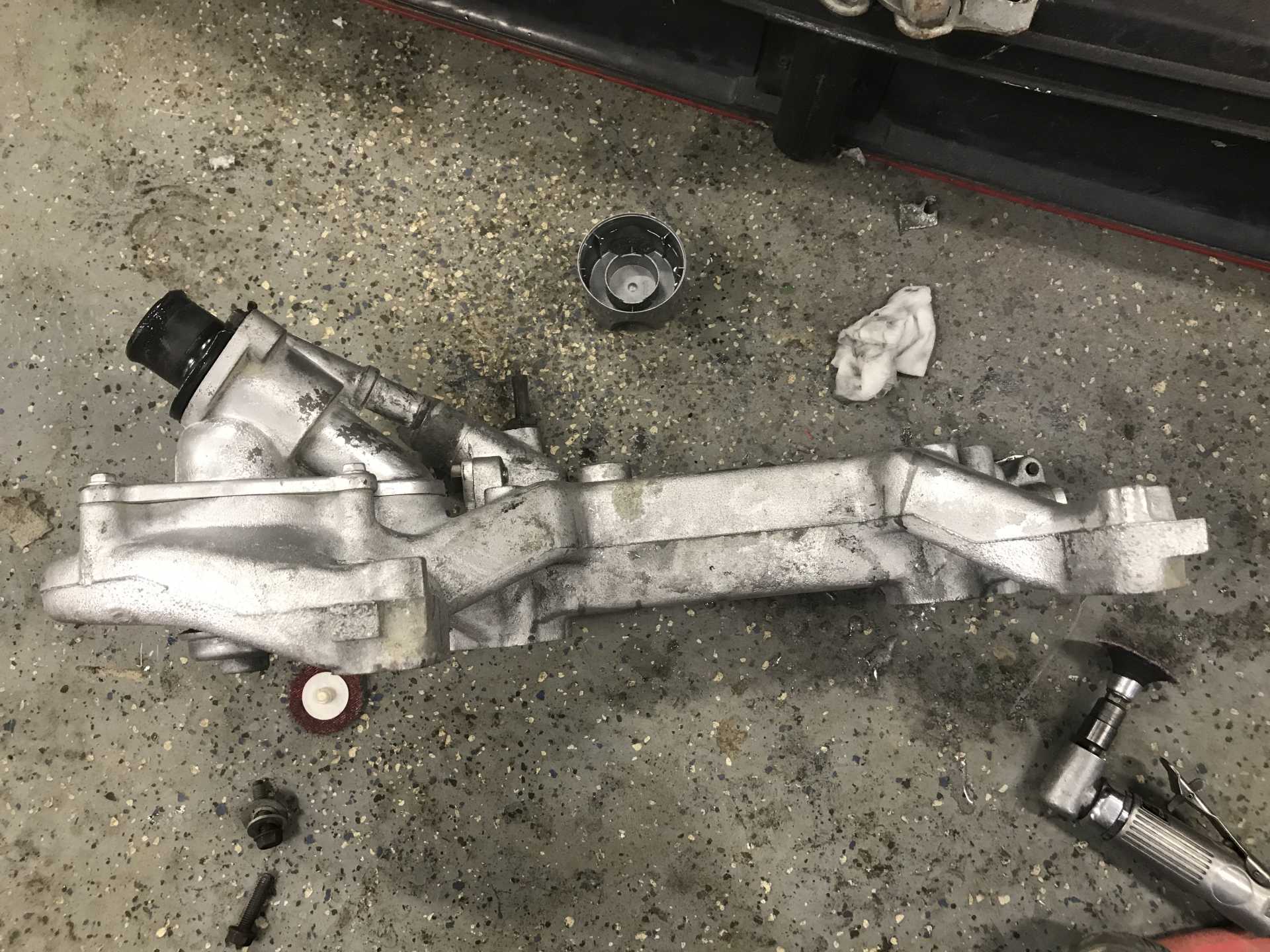

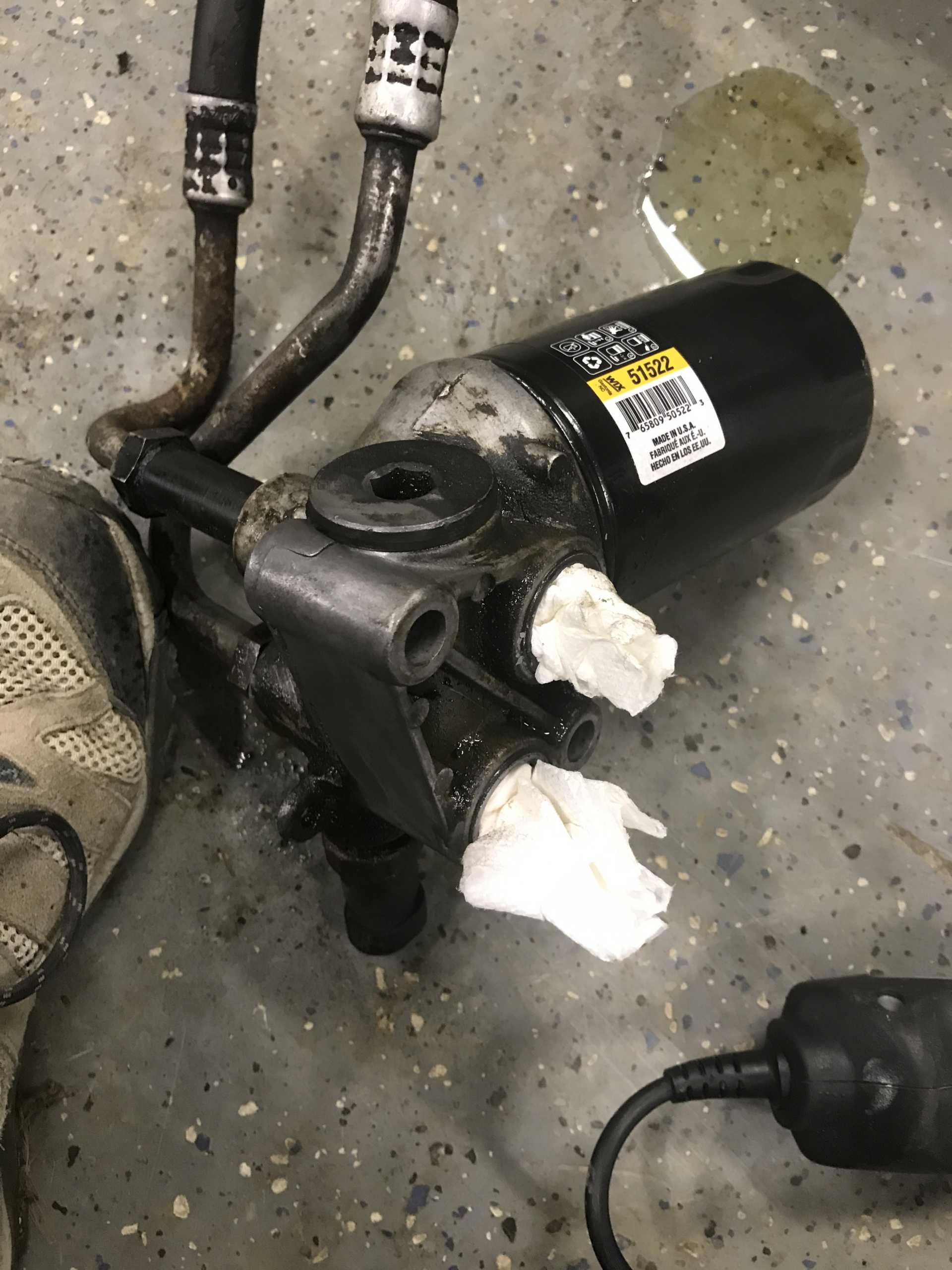

I’m ashamed that I even installed the oil filter housing in this shape.
But I cleaned it up this time.

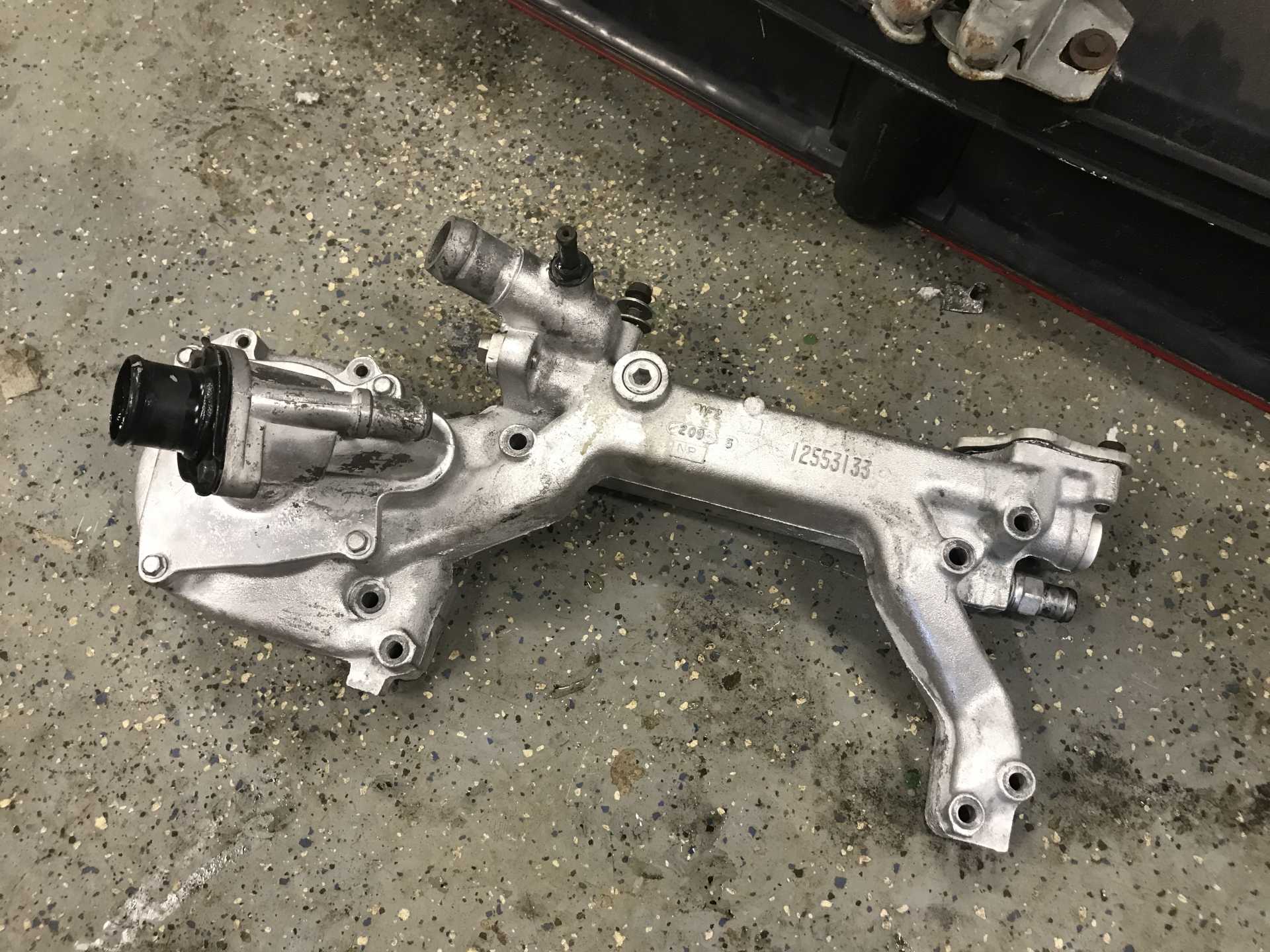

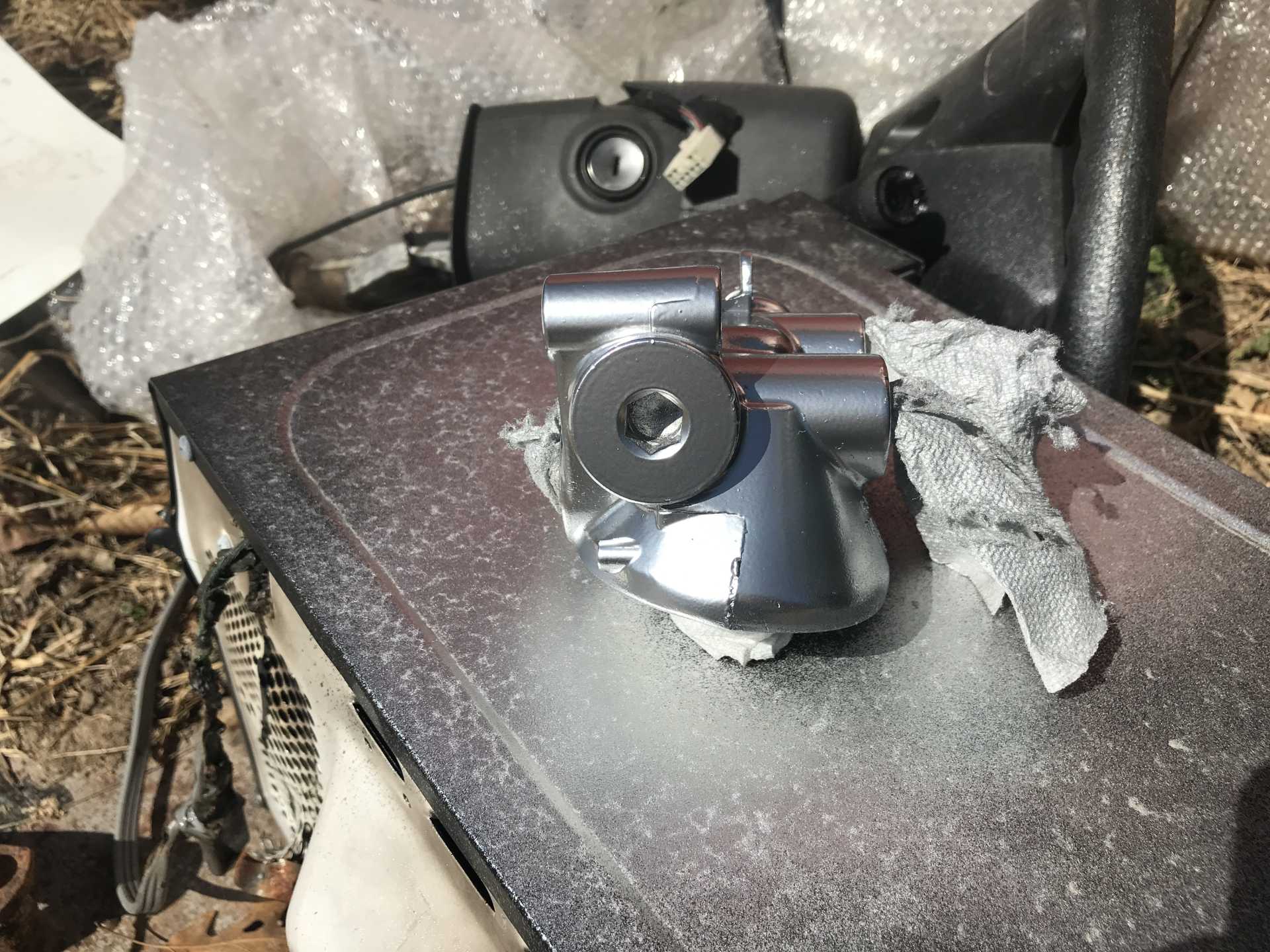

I ended up redoing the water pump again. It was mostly clean but not shiny. I would end up sanding it all down and getting rid of casting marks, and then painting it nice.

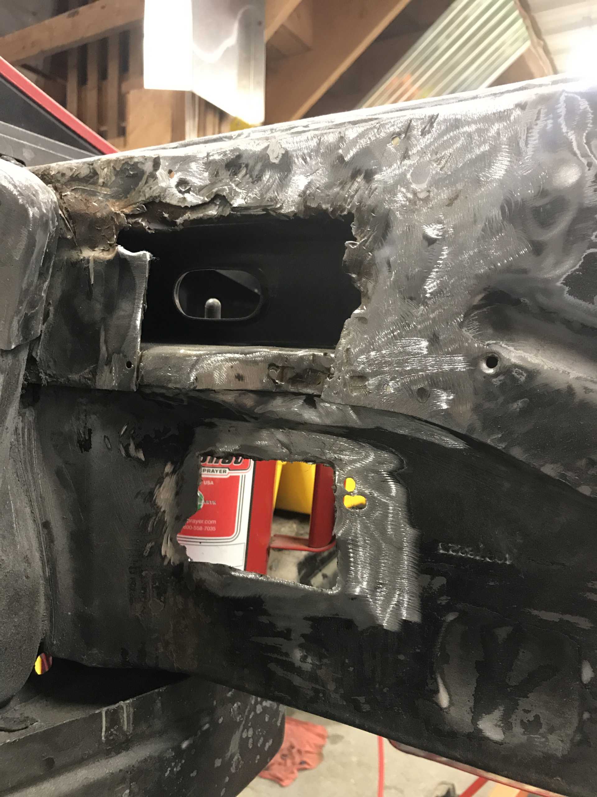

Some progress on the trunk wall. Not yet done of course.
More scotch brite and grinding.
Sanding revealed more bondo! I sanded as much as I felt comfortable to reveal any rust holes and found nothing concerning. I think they were trying to patch these holes here. At one point there was body filler in them I popped out and I never got around to patching them until now. I’m not sure why there were holes here to begin with.

Will JUL 22, 09:07 PM
https://www.fiero.nl/forum/...000121-26.html#p1001
copperhens JUL 24, 01:34 PM
Wow, no need to give me more ideas! That looks great.
