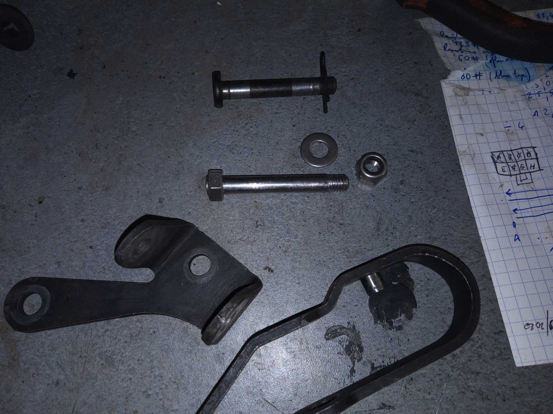

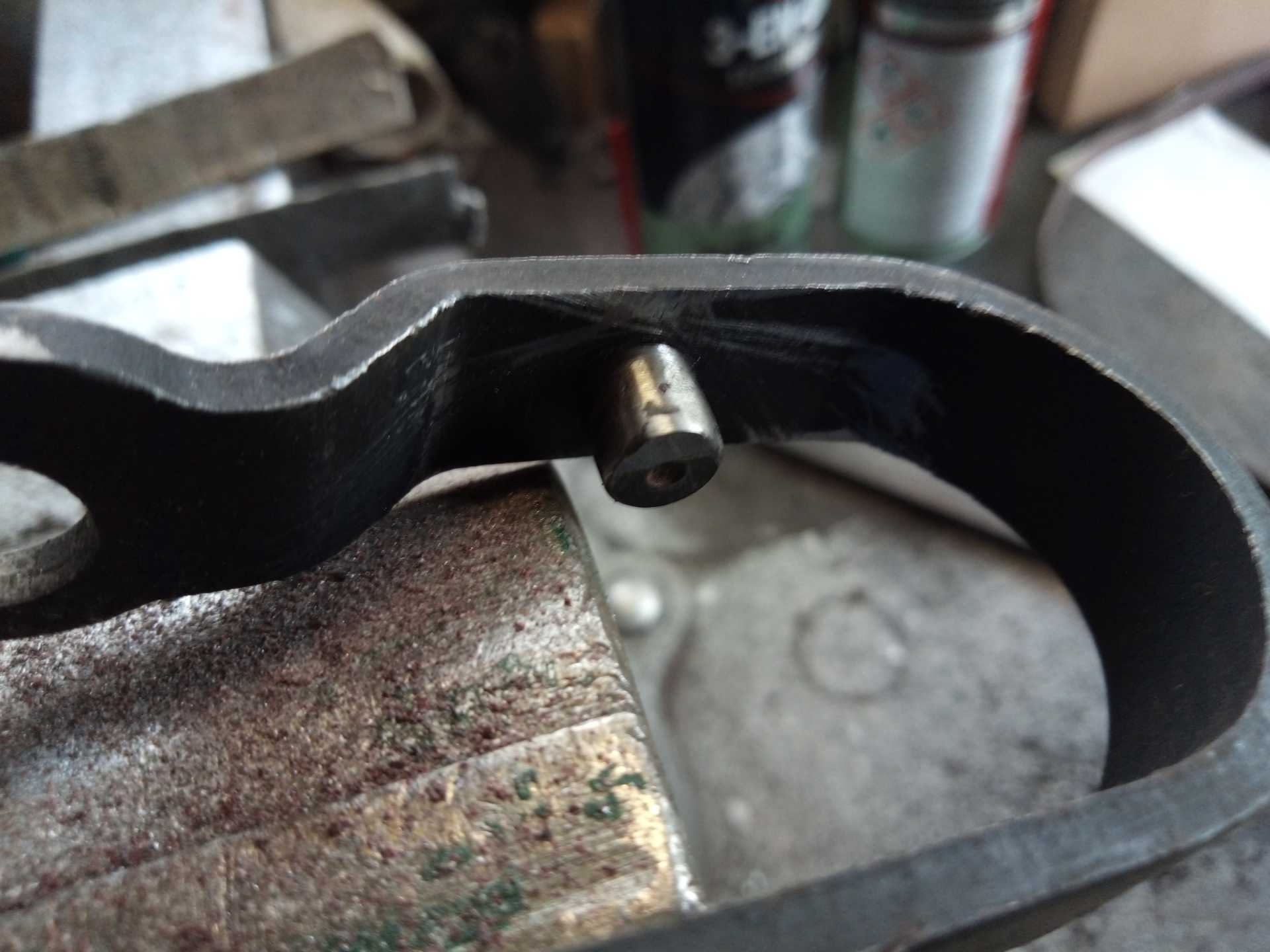

I made a new gearbox shifter mechanism pin from fresh 8mm hard steel bar. The old pin had worn 0.1 to 0.2mm - not much I know, but noticable when moved. I also welded/built up ("rechargement" in French) the small pin on the lever.
Now it's back together but to be honest I can't tell the difference with the gear selection while the car is static in the garage? We'll see the next time on the track if I miss my 2nd/3rd or 3rd/2nd gear changes!
