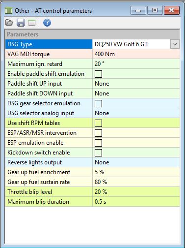

https://www.wiringspecialti...e-engine-management/
These polish ecu guys have the ability to emulate the CAN bus accordingly. Its mostly a mystery if it actually works, as almost nobody has used it but I'm not that afraid.
The TCU isnt that hard to get at either, so I can make tweaks to it directly. I will be using a KESSv2 to flash the trans, and some stuff I found on the internet to modify the software. There are 2600 parameters in the software that I have the ability to modify, oof!

| quote | Originally posted by darkhorizon:
I'm not too sure what I will do with the trans. This was a very not abused trans and while I'm going to clean it up a bit and make sure the fluid and stuff looks ok, the clutch replacement is an expensive and complex job that I might save for later. I want to find out if this thing even works at all before I invest much into it, and honestly its not more than a few hours from being back out and on the ground again once its in the car. |
It looks like throttle by wire for rev matching?
