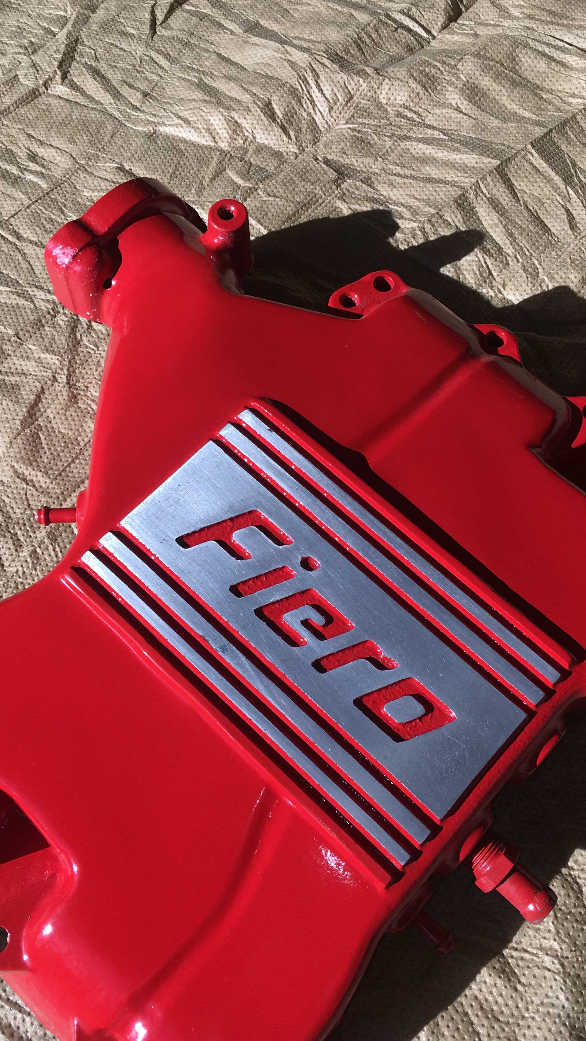

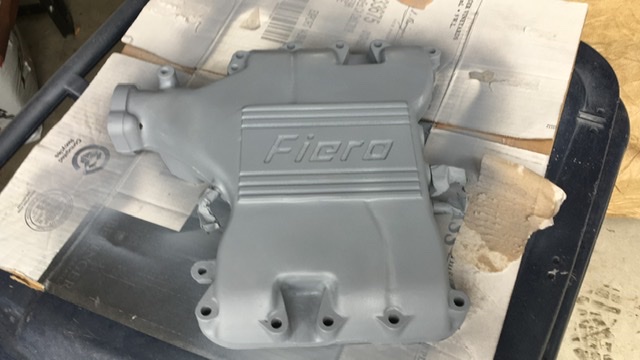

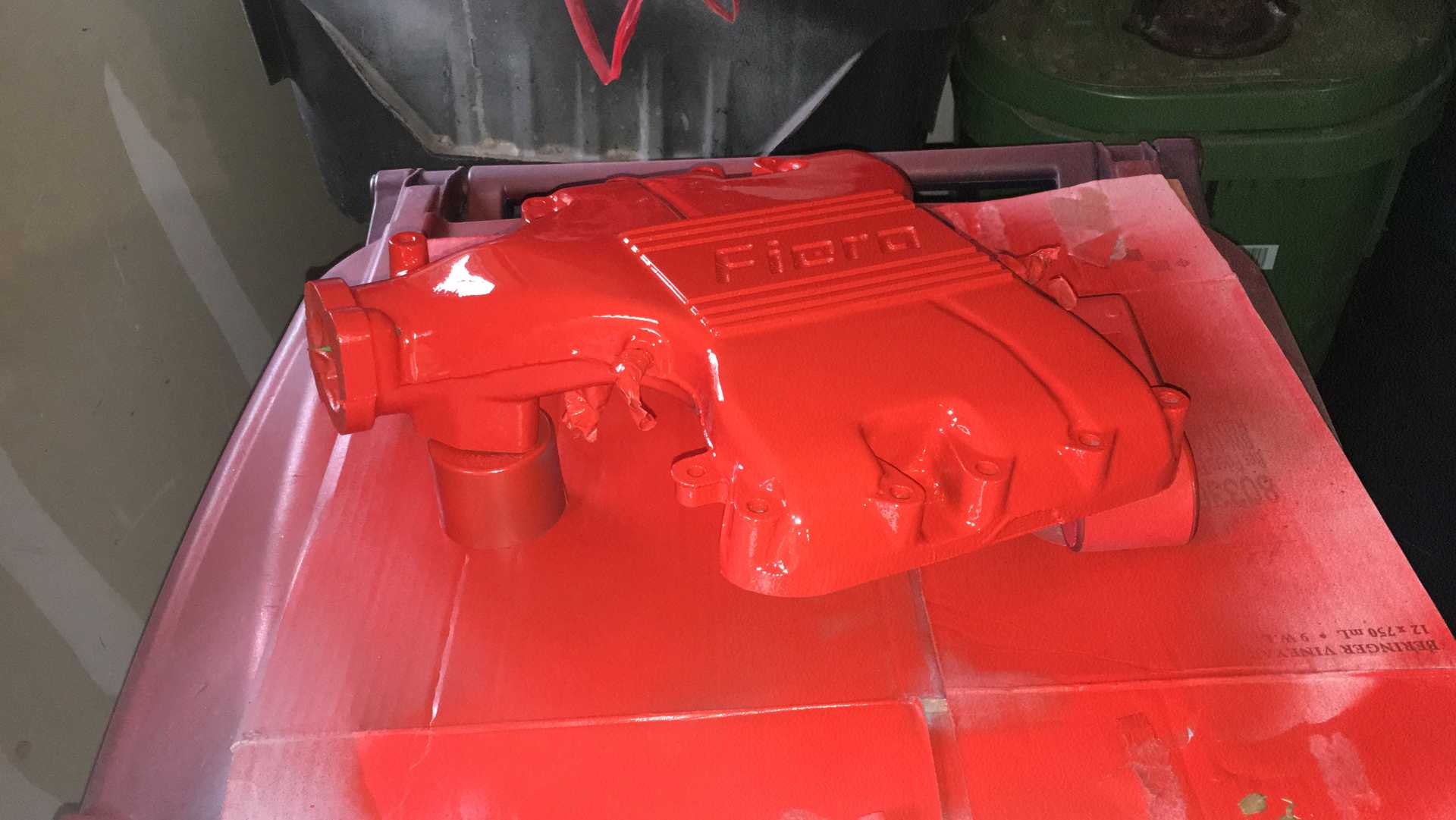

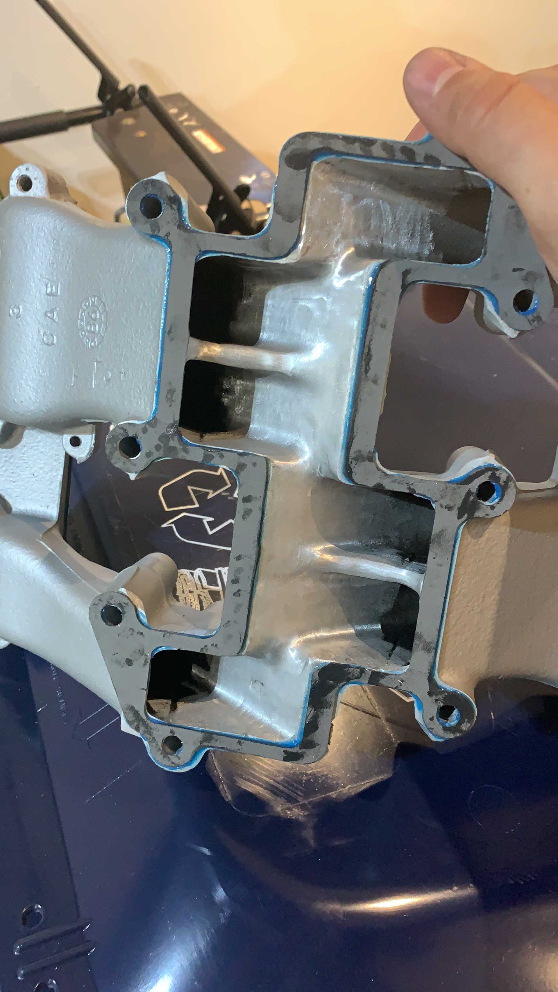

jjd2296 AUG 25, 08:33 PM
K time for an update. I did lou_Dias mod (correction thanks fieroguru) on the middle intake as well as swapped my rockers to 1.6 rollers. That with my modded ppg style plenum and all the other work on my 3.4 ( ported heads sprint headers custom y pipe 260h cam bored TB tuned chip from sinister Etc etc) feels real good now. Fiero Gigi was right the modded middle intake let’s it breath all the way past 5500 rpm pulls through the whole power band now. A little torque lost on the bottom end for more top end speed feels great. Now I need to get it dyno’d. Mental number count from 0-60mph has me at low 5 seconds. Only need first and second gear to get there too

The idea and video on the modification to the middle intake was from lou_dias. I just liked the video to share the info.
