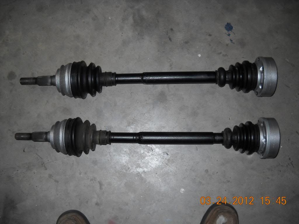

Its back together again and it runs. That was a minor setback, but now I can start going forward. I welded up the axles and the next thing is to get the rear brakes fixed up. Here is pic of the axles, 1/2 Audi and 1/2 Fiero.
A thing that I'm curious about is how is the change in length of the axle taken up as it goes through its arc of travel during compression and rebound? The inner joint on the Fiero allows for this; the Audi inner joint appears fixed, as is the outer Fiero joint, what am I not seeing?

The inner Audi CV joint is NOT fixed and allows the axle to move in and out. I verified the axle did not bind through the full travel of the suspension without the spring.

Excellent. Thanks. Didn't know that about the Audi joint.
