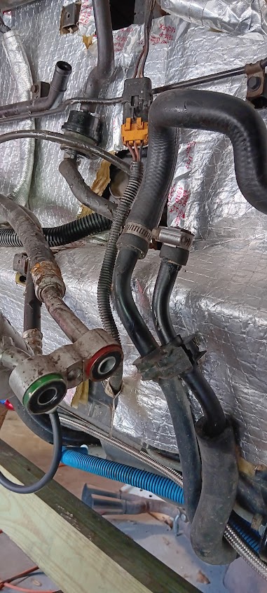

The new fuel delivery system has been installed. Having said that, I will be adjusting the piping once additional AN fittings and fuel pressure gage & sender arrive.
In case anyone is wondering what the 2 blue tubes are, they are PVC tubing that holds 2/0 welding cable to the battery which is located in the front.
Of your heater tubes in this photo, is the bigger tube on the left or right? I don't think I can tell reliably from this photo.
Cajun AUG 05, 05:22 PM
Will,
A photo is worth a thousand words.....
The larger hose is on the left facing forward.
Will AUG 05, 06:01 PM
Thanks! I was trying a set of '85-'86 heater tubes for my '87, but didn't have the positions documented

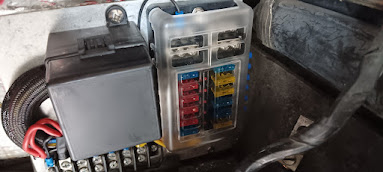

I have installed but not yet wired the new Power Distribution-Fuse block for the 3.5 install:

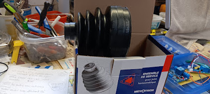

Of late I have been attempting to build CV axles for the build. Lots of information on how to build and what to use. However, all have failed to indicate that one needs some specialty tools and materials for the job. Tools like banding tool, CV booth installation cone, etc.
Currently working on the passenger side CV axle. Again, waiting on an inner CV booth. I found out the hard way that the inner booth on a manual Fiero CV axle is not the same size as the inner CV booth for a 4T65e transmission. Oh well....

The CV booth has arrived for the passenger side CV axle build. Hopefully I will that that accomplished today.
Also, the driver side CV axle arrived. Looks like I will be tearing that one down and building another CV axel? I have ordered another Fiero driver side Manuel CV axle from RockAuto for the build.
