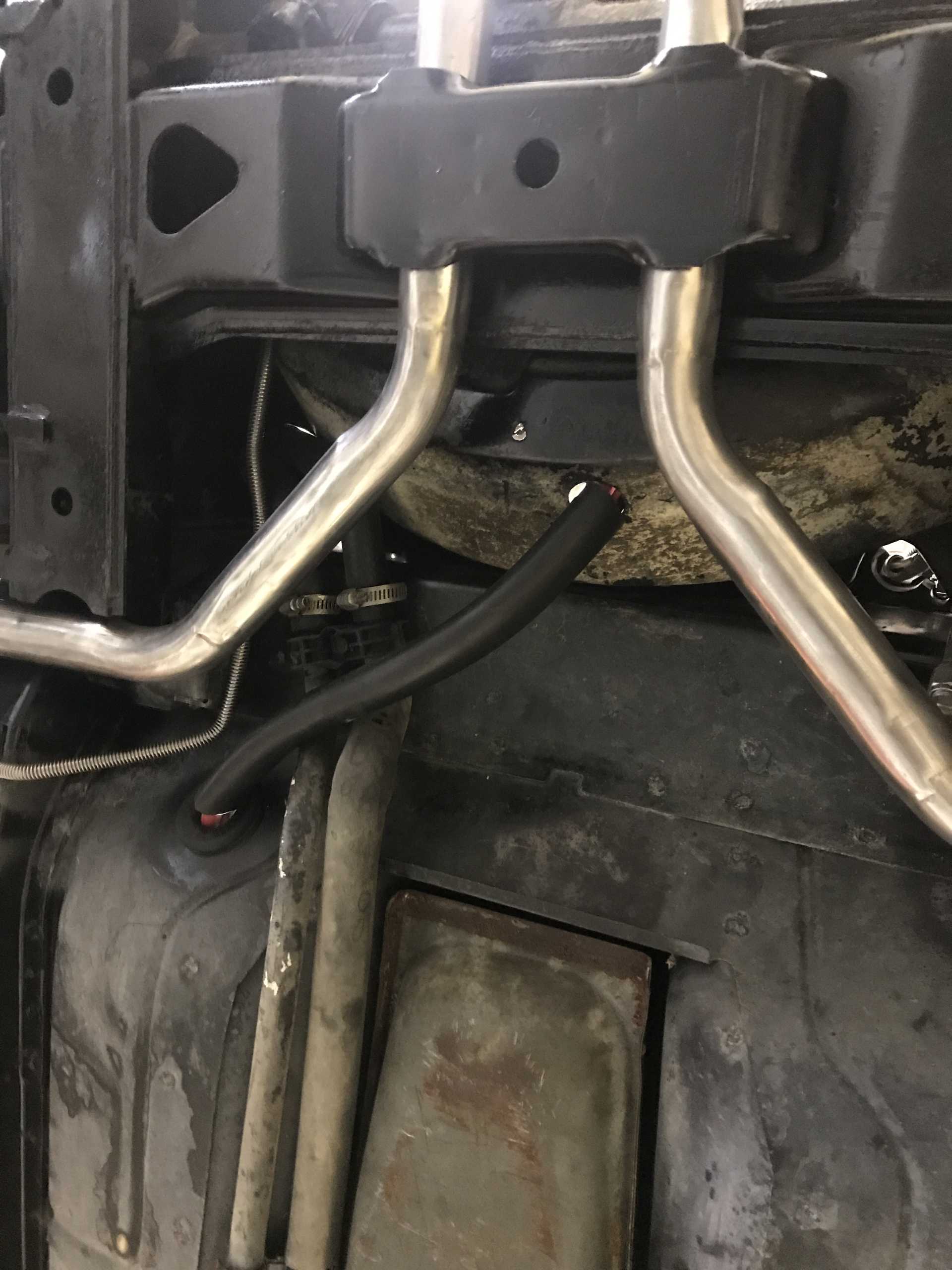

Most people seem to run the battery lines along the gas tank. Unless they are uncovered, I didn’t see a way to do that nicely. So, we ran them under the carpet. I’ve seen people run it through the center console, but not the carpet. So maybe there’s a reason people don’t go under the carpet, but it seems to work for me so far.

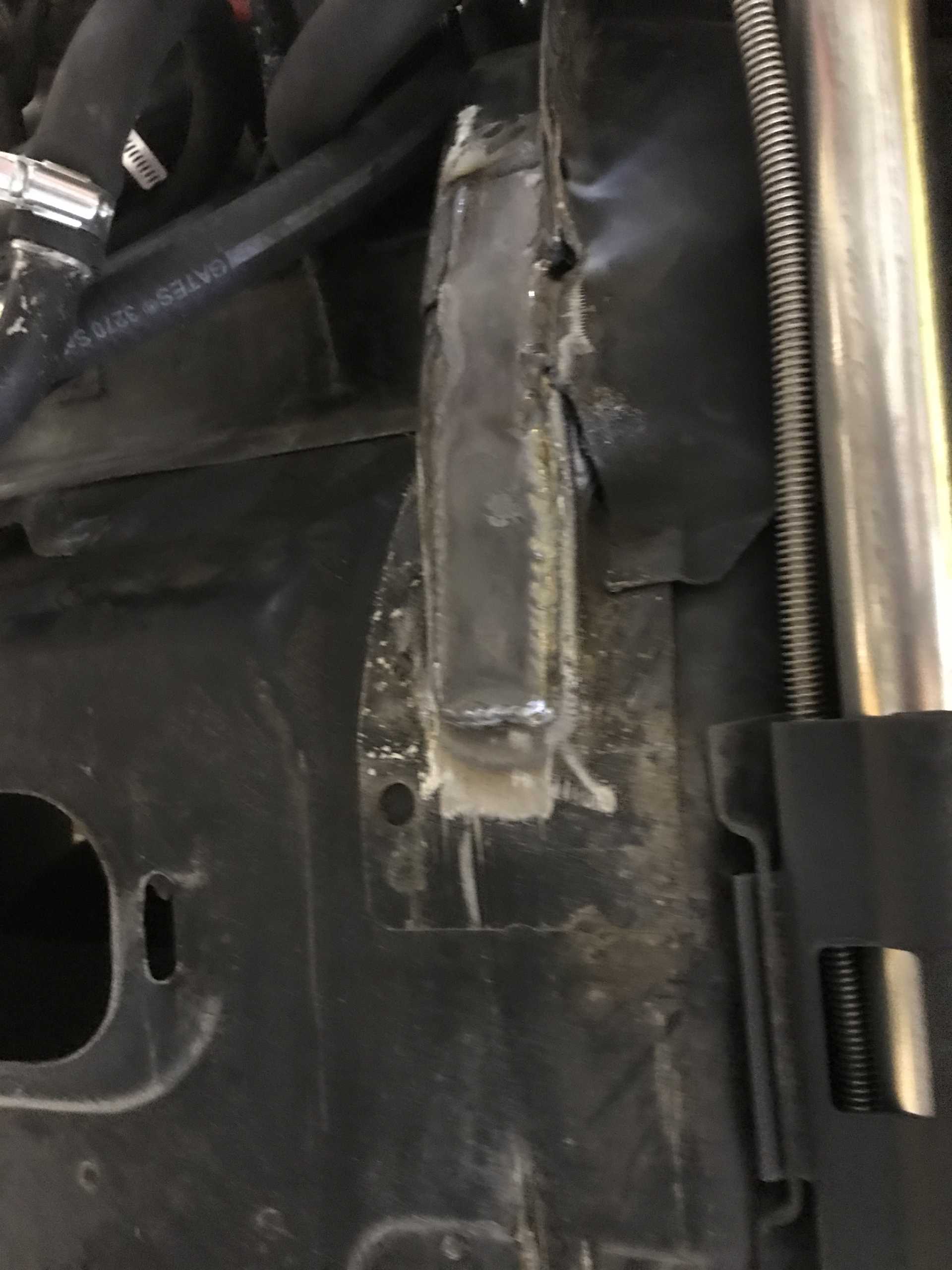

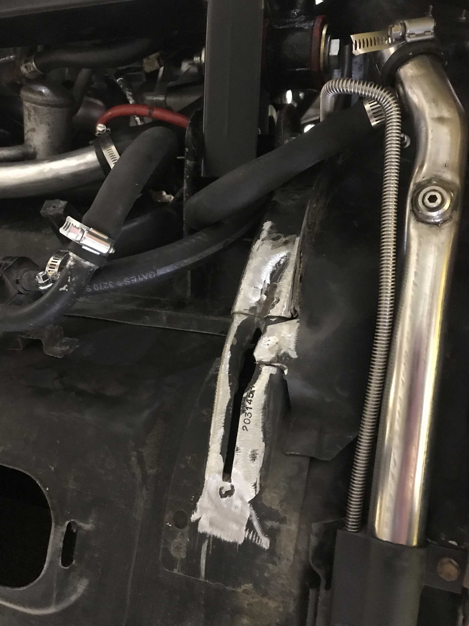

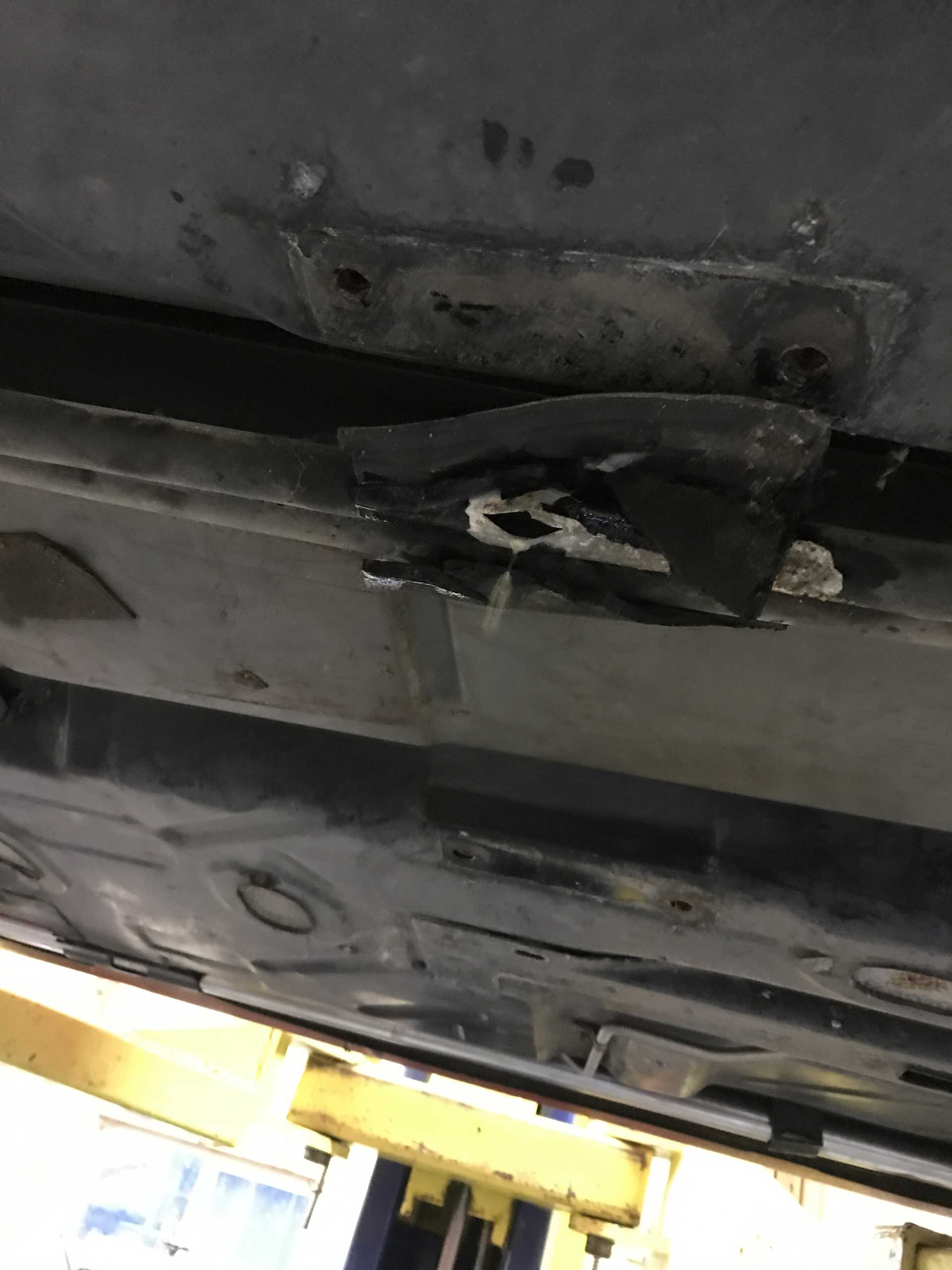

The PO had run over something at some point. There is also a puncture through the main floorboard that’s not as structural as this one that’ll get fixed eventually.
Here is the patch. I painted it after it cooled.

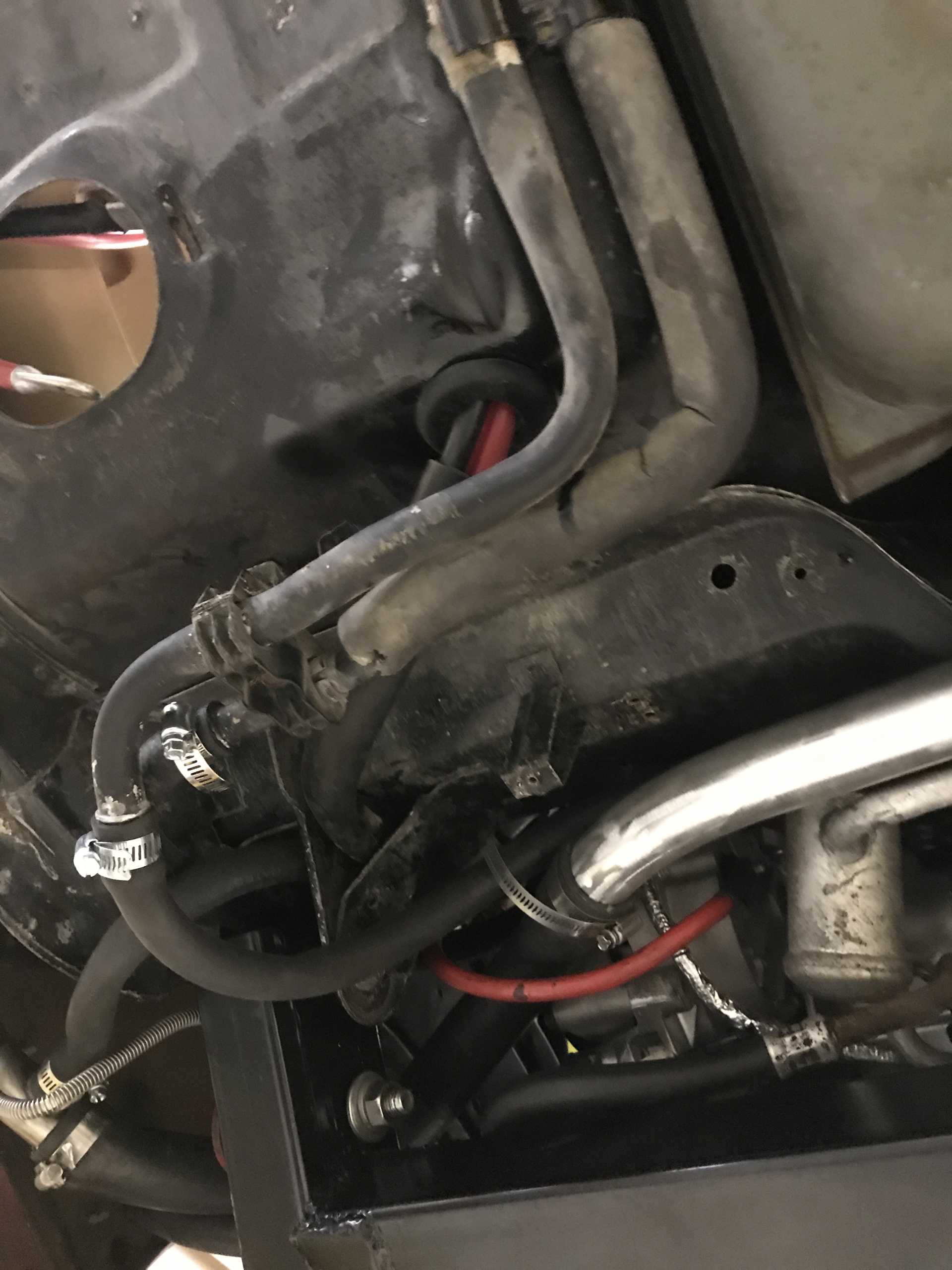

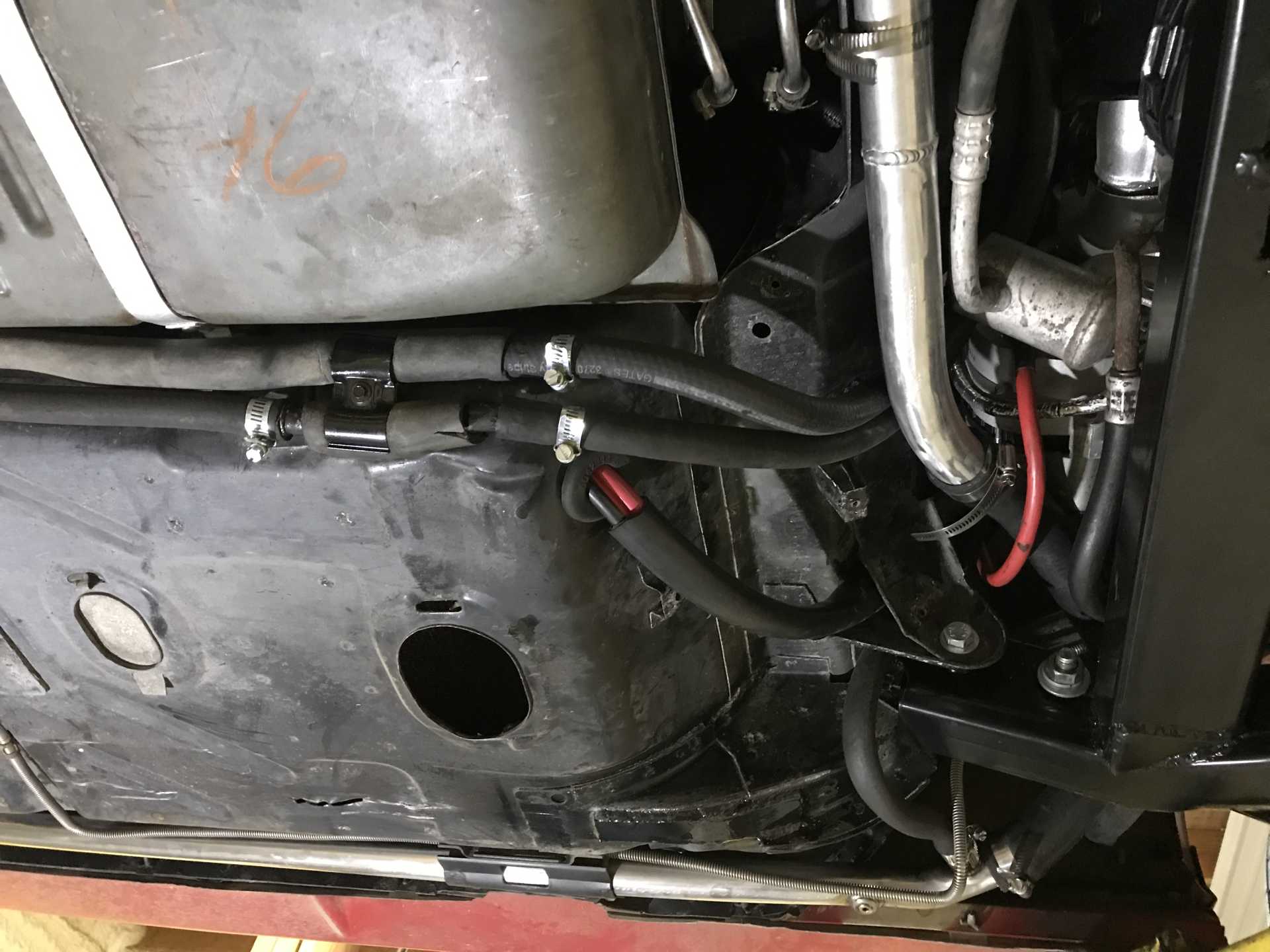

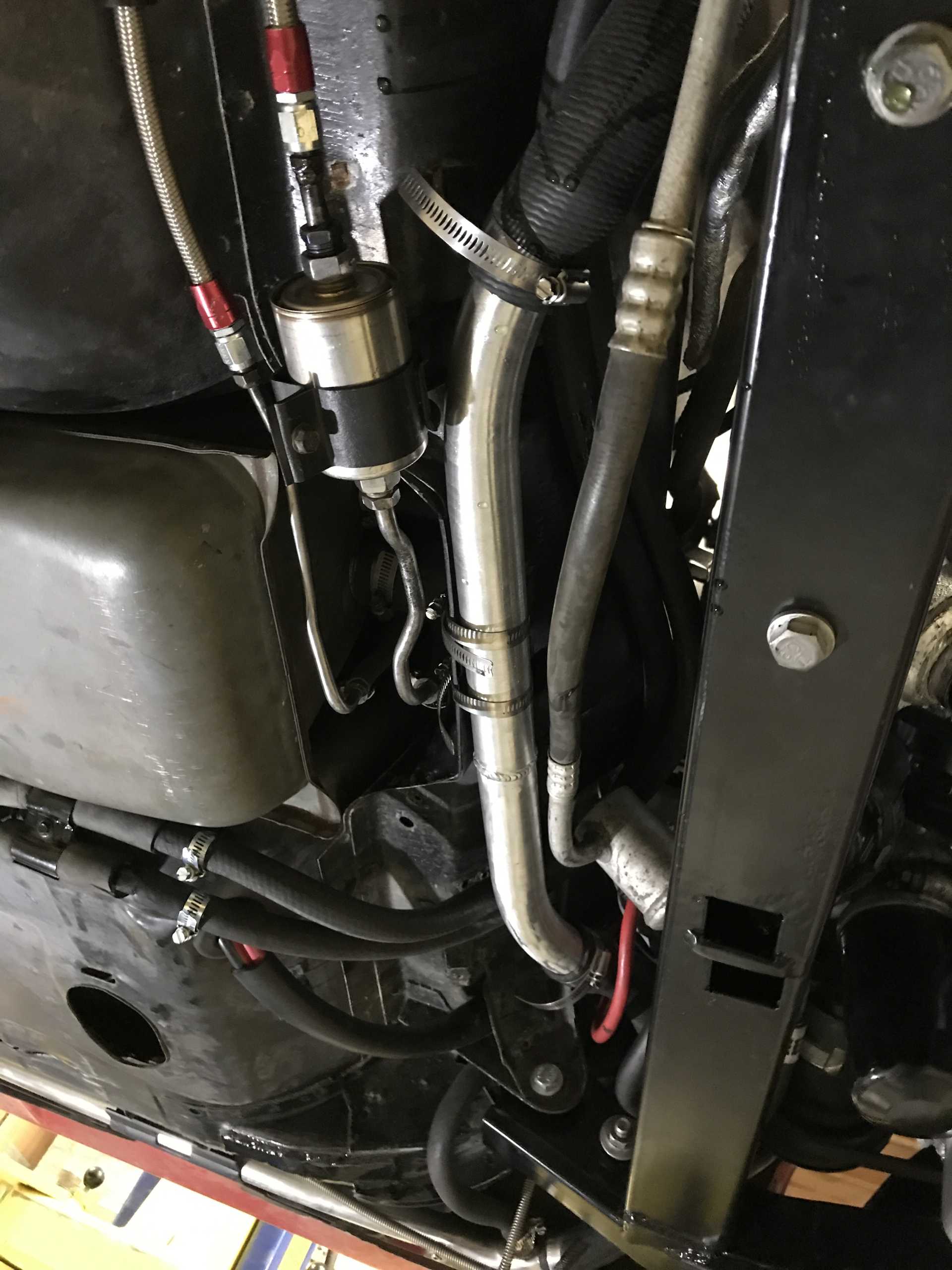

After that, I ran the car for some friends, and found a puddle under the car. Coolant must’ve finally made it to the heater core, and as it was coming down the cool line it showed us this leak. Presumably, water was in the tube and froze, where it burst. It was hidden under the foam. The cool line ended up having several pin hole leaks, as well as a crushed spot, so we cut out the bad section, and replaced it with rubber hose. The metal sections that were kept were inspected, cleaned, and painted. The hot tube was inspected, and because it was covered in insulation it was in great shape with no corrosion.
We then decided to run the heater lines different than what they were. Both lines came out on the passenger side, but since they needed to come out on the driver side it made more sense to cut them shorter and run them directly towards driver side. I’m not sure why I didn’t think to do this before.
Both heater lines now run with each other. I am not a fan of so many clamps, so I hope this all holds. If not I’ll run a solid line.

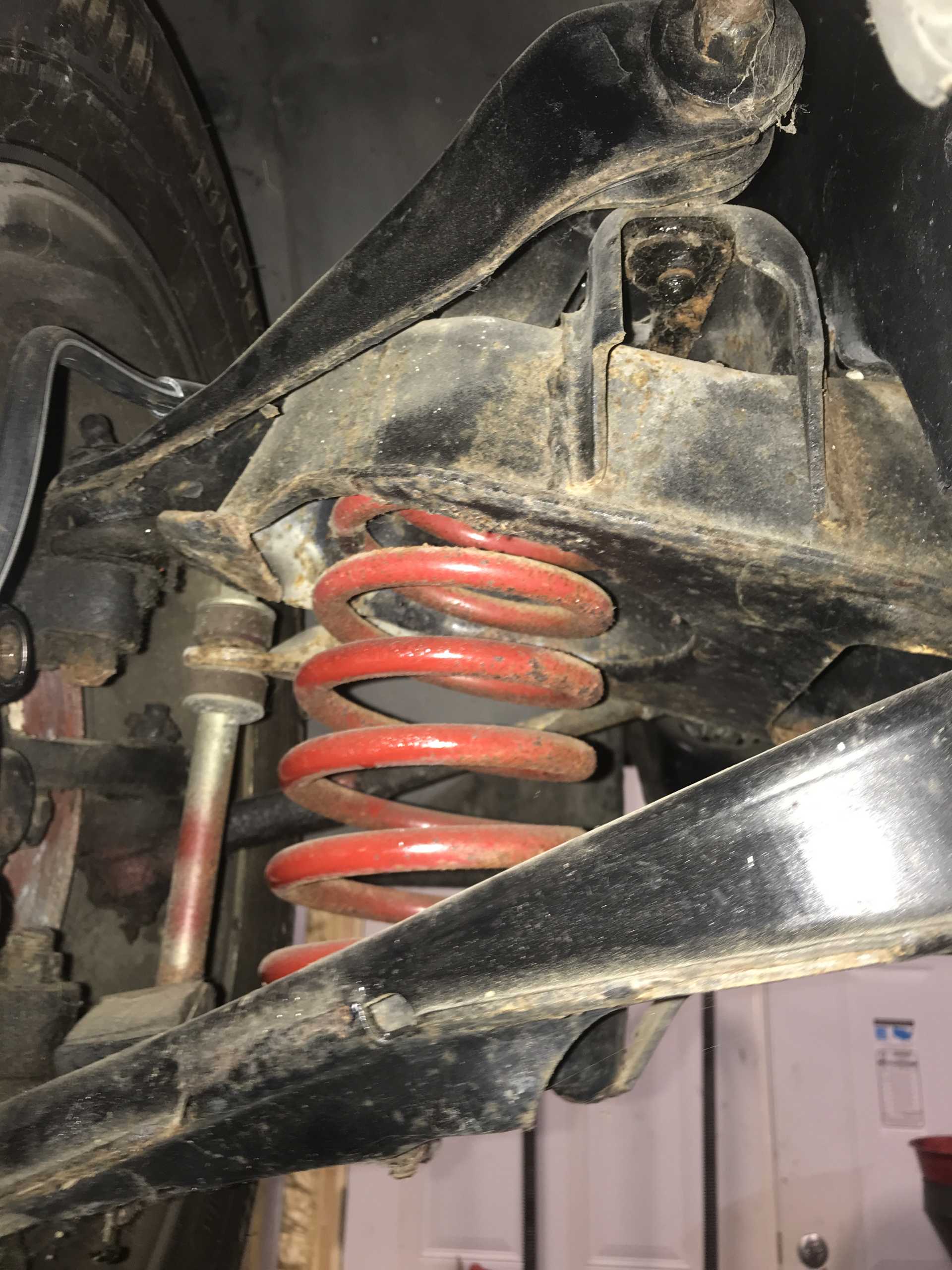

The PO also didn’t have shocks. So I ordered some new ones. The passenger side had the lower mounting hardware, the driver did not. Took some digging to find the bolts online.
These bolts here are an exact match to what should be on the car.
https://www.opgi.com/chassi...DEAQYASABEgJmAfD_BwE
Now both shocks are in.
