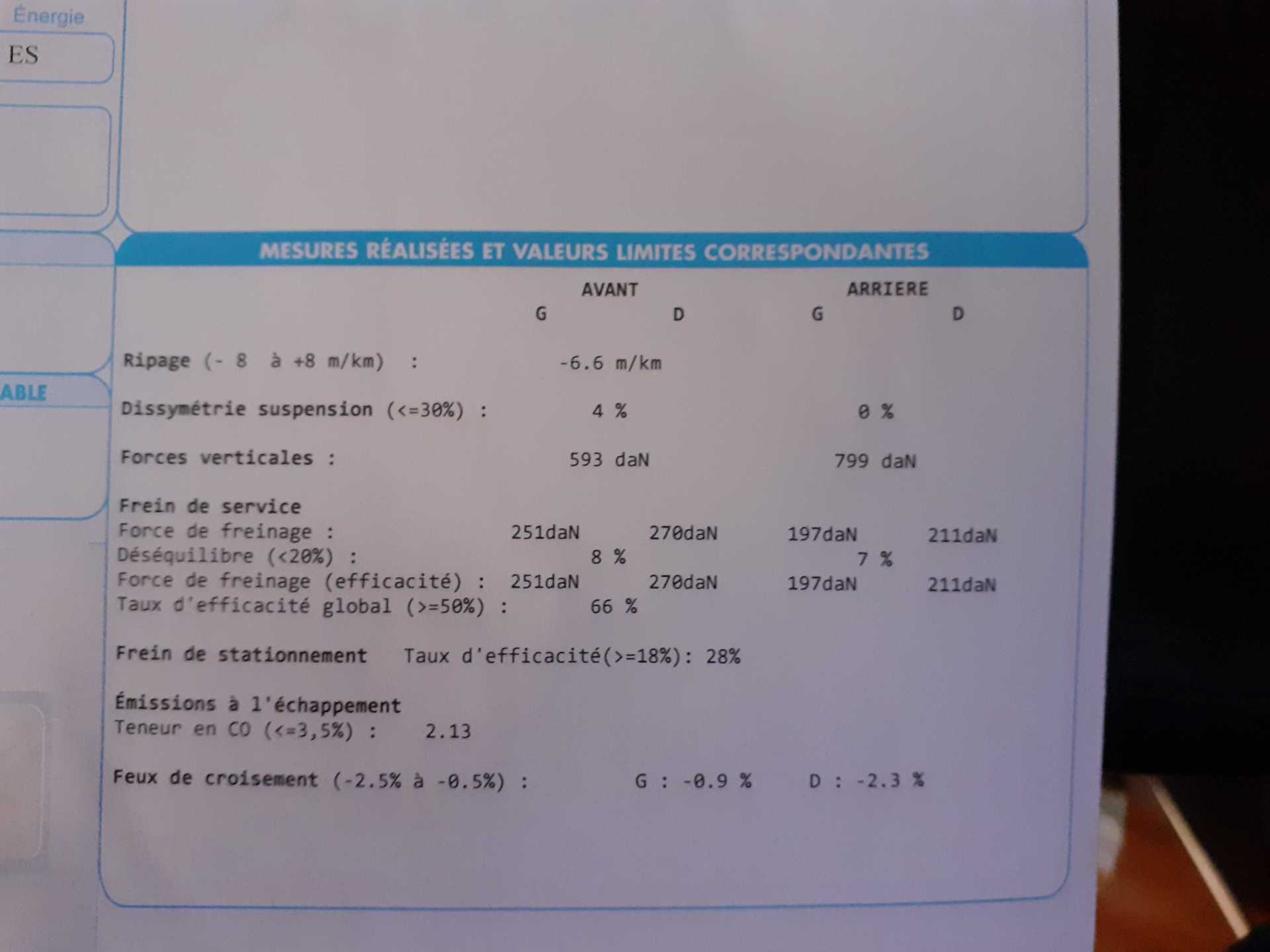

For those who are interested, my weights and brake readings from today:

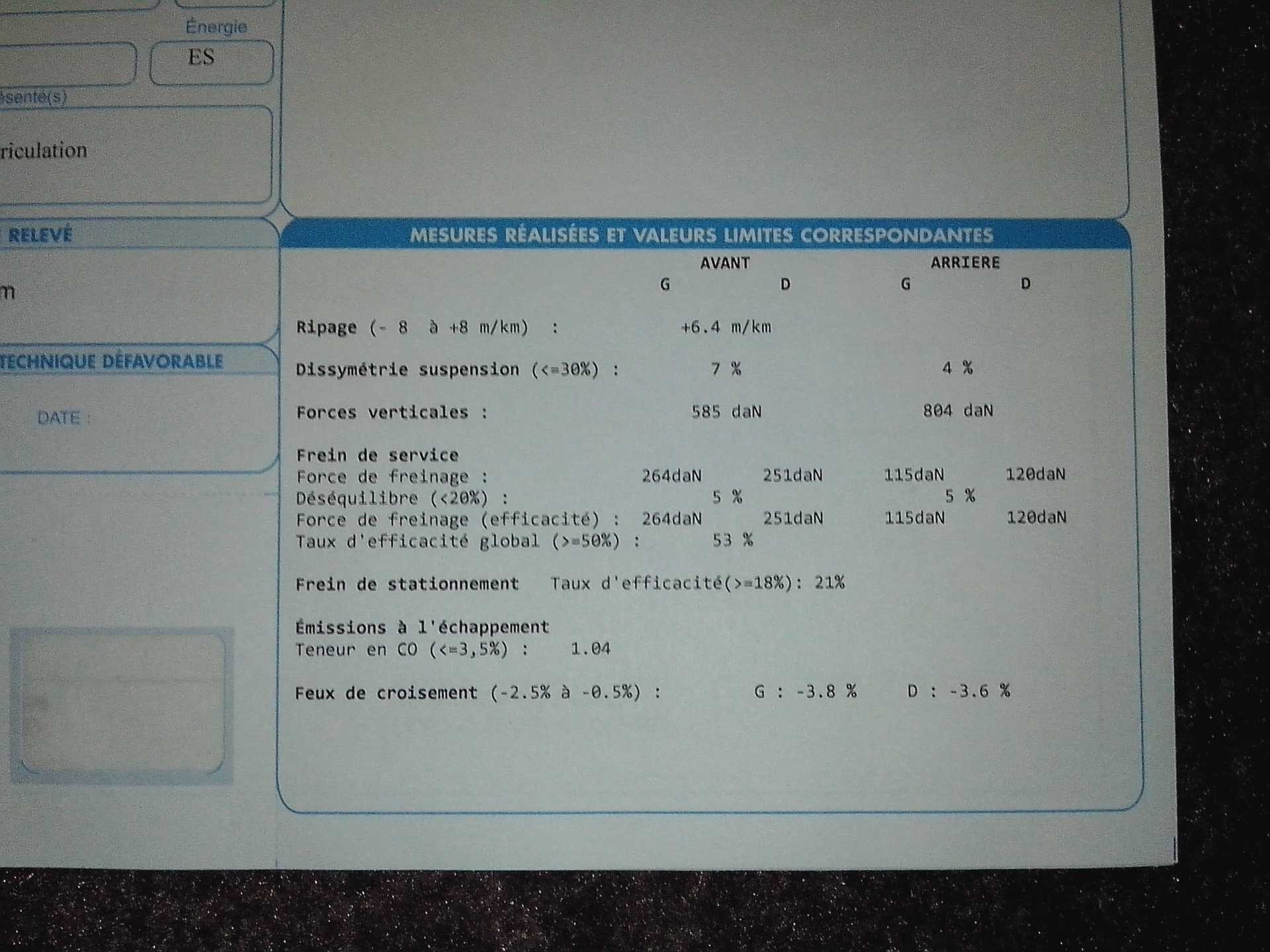

And the same from 2 years ago, before the "Seville" rear brake upgrade:
Even though the front brakes are a little uneven (probably pads), my overall braking effeciency is up 13%! Which is good for balancing the car in harsh track conditions.
We can see that the battery relocation took 5kg off the rear also.
