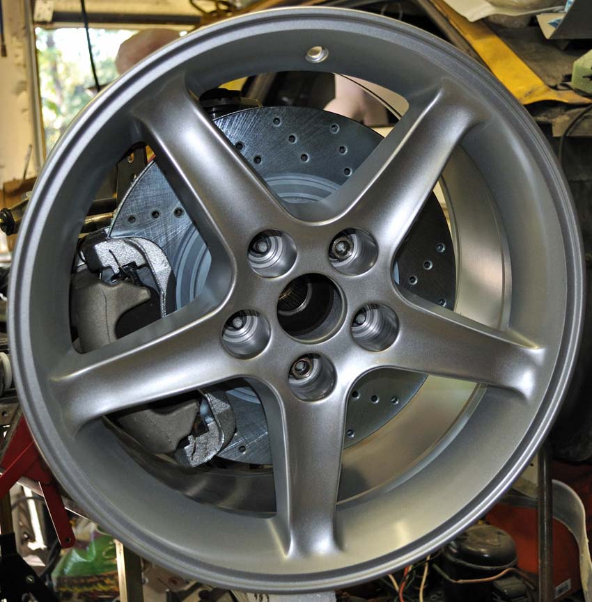

So dumb question, but what is stopping me from using a Solstice/Sky front knuckle assembly? [This message has been edited by darkhorizon (edited 09-17-2020).]

darkhorizon
SEP 17, 09:54 PM
Thats a nice comparison pic, I figured I could raise the upper control arm significantly, and also lower my lower control arm pickup about 1.25 inches without much issues... I wouldnt consider it a big discouragement unless there is something else I'm missing? I already have $300 invested into my steering rack with spherical ends that should make the steering part just fine.
pmbrunelle
SEP 17, 10:26 PM
| quote | Originally posted by darkhorizon: I wouldnt consider it a big discouragement unless there is something else I'm missing? |
Would that fit inside your front wheels?
darkhorizon
SEP 18, 07:56 AM
| quote | Originally posted by pmbrunelle:
Would that fit inside your front wheels? |
Yes, without issue, and it will bolt to them as they are dual pattern.
Will
SEP 18, 09:09 AM
Didn't the Solstice have 18" wheels stock?
darkhorizon
SEP 18, 09:28 AM
looks ok. Pic from that CCfiero guy's ecotec thread.
Will
SEP 18, 03:26 PM
The real issue is control arm clearance
darkhorizon
SEP 20, 01:53 PM
i feel like the rotor will clear the control arms. I will look at the helm arms, but they didnt have any issues with his, and I can shorten the steering radius without any major issues.
