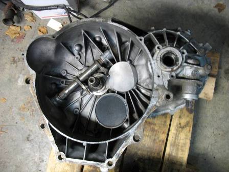

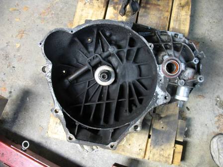

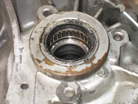

I recently purchased a 5-speed trnsmission from a forum member here. I have not been able to get axle seals for it. The parts store guys tell me that its the same seal for all Fierod, and looking at the pictures herhe, I think that's so.
I posted pics of the tranny and the seal. Can someon explain?
My 86 4-speed tranny:
The 5-speed I just purchsed:

The seals I have are Timken 3543, but they definitely do not fit. (Unless I am overlooking something). The axle area around the seal looks quite a bit defferent from 4 to 5 speed. Kinda like something is missing.[This message has been edited by fyrebird68 (edited 11-28-2009).]

that looks like the Rodney Dickman support bearings.
Rodney
NOV 29, 06:03 AM
I used to sell those bearings. I still have replacement seals for them in stock.

That clears it up! That's whay the parts guys kept coming up with the other seals.
