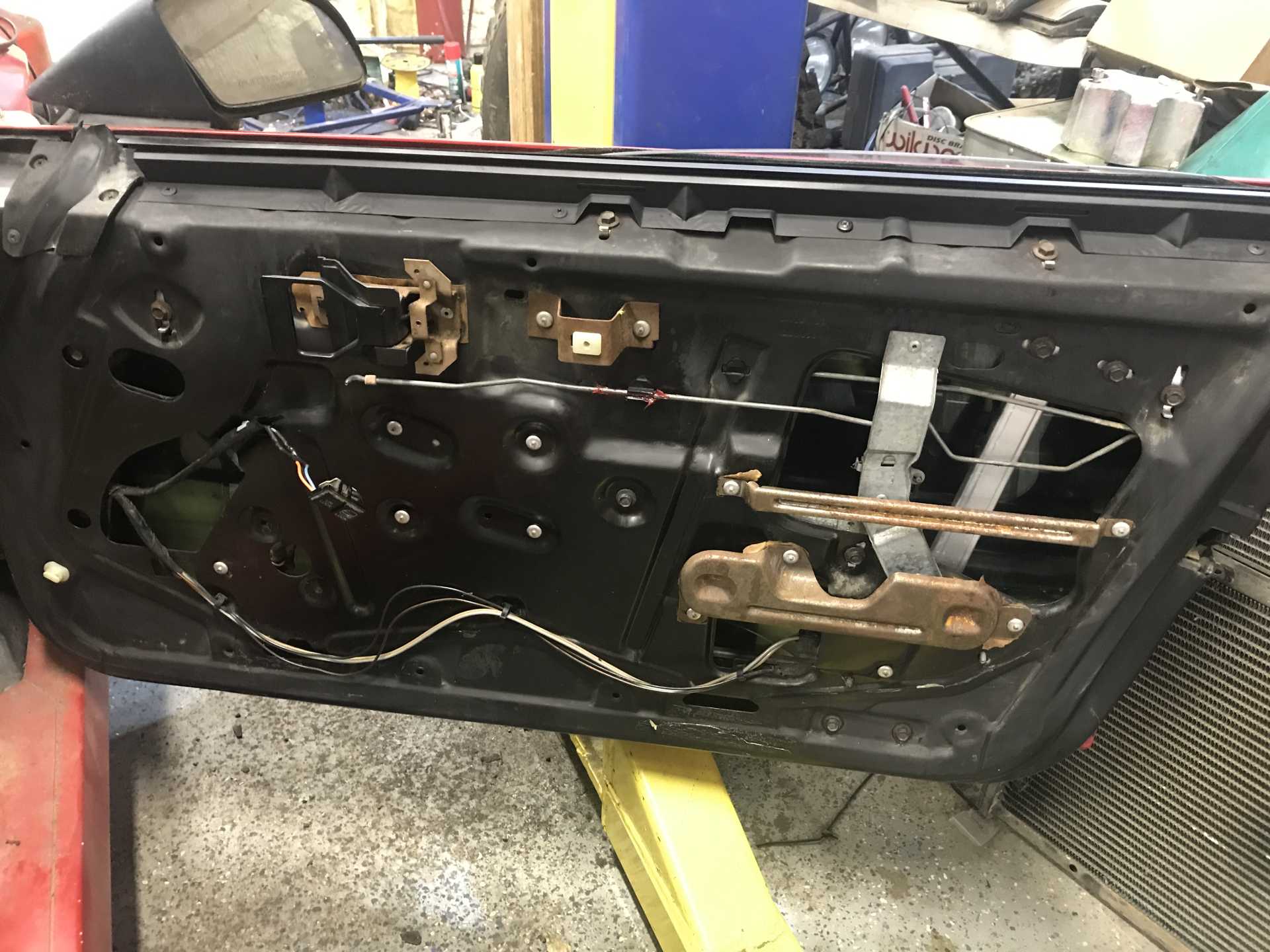

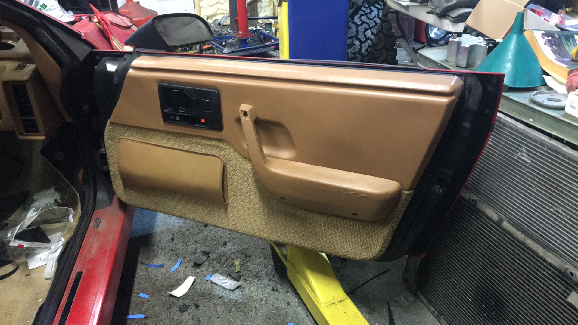

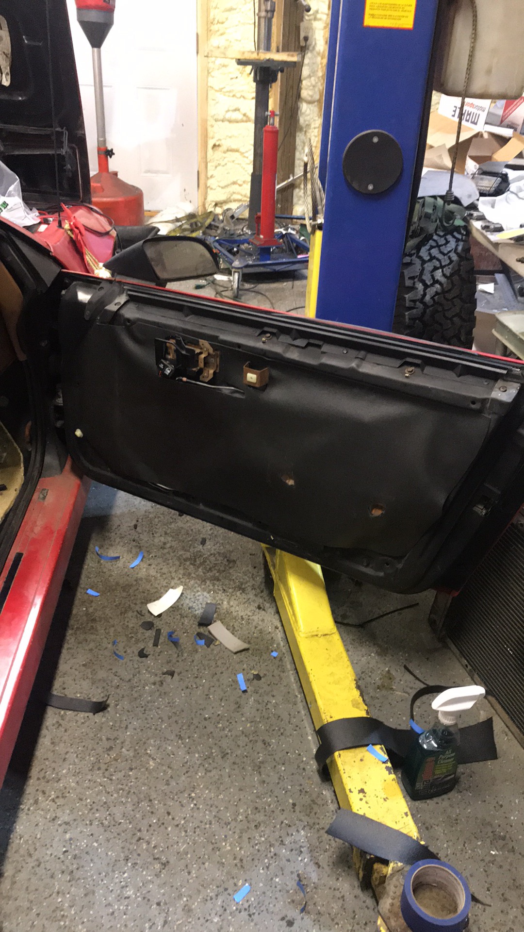

I am missing the moisture barrier. I don’t believe I mentioned it either but PO cut both lock buttons on so I had to wire new ones on which is why they have heat shrink around them.
$8 placemat material from Ace cut to shape and attached with double sided tape.

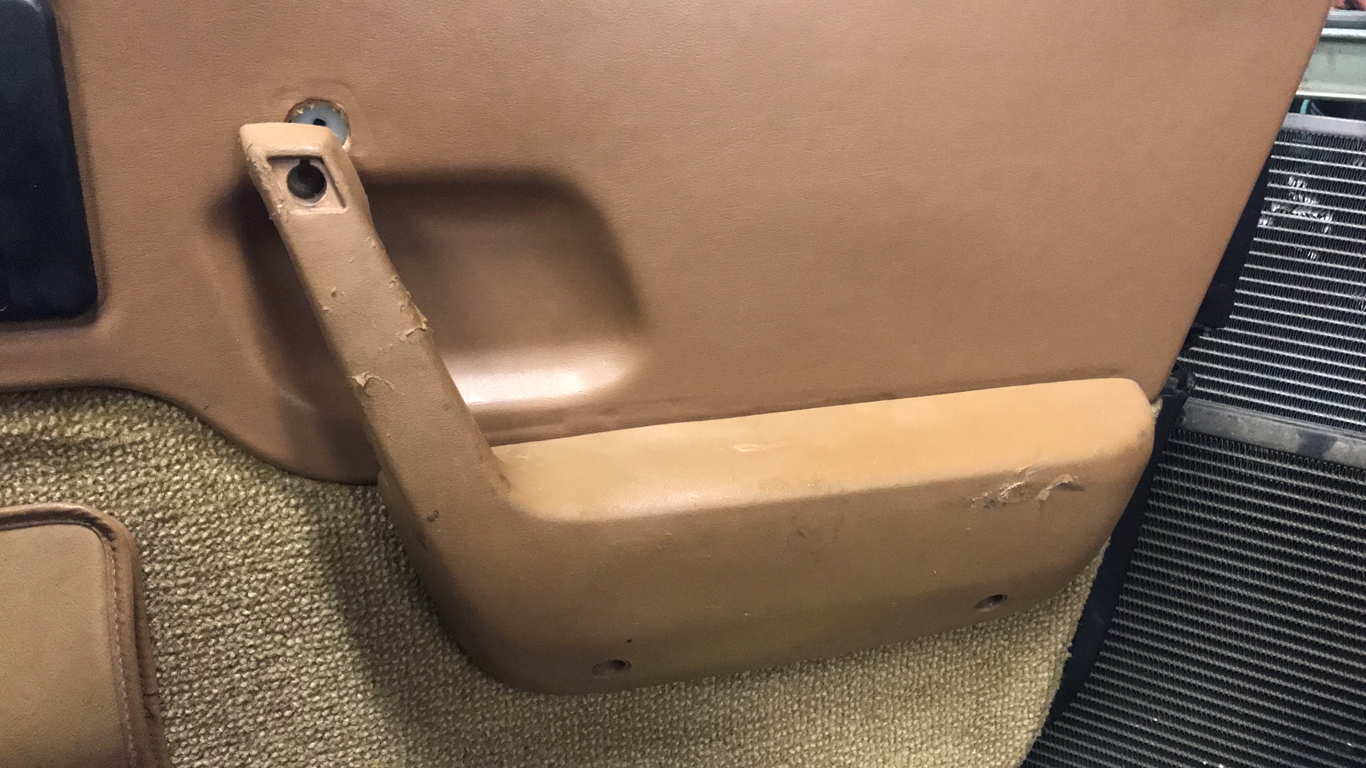

This arm rest doesn’t line up at all with the two bottom bolts in. So I just put in the top bolt and the right bolt and it’s good enough for now. I need a new armrest as this one is beaten up, but am not in a huge rush for it right now.
Door panel is installed just to have somewhere to put it. I don’t have enough clips to even just secure one panel so this one sticks up on the bottom. Driver side will have to wait.

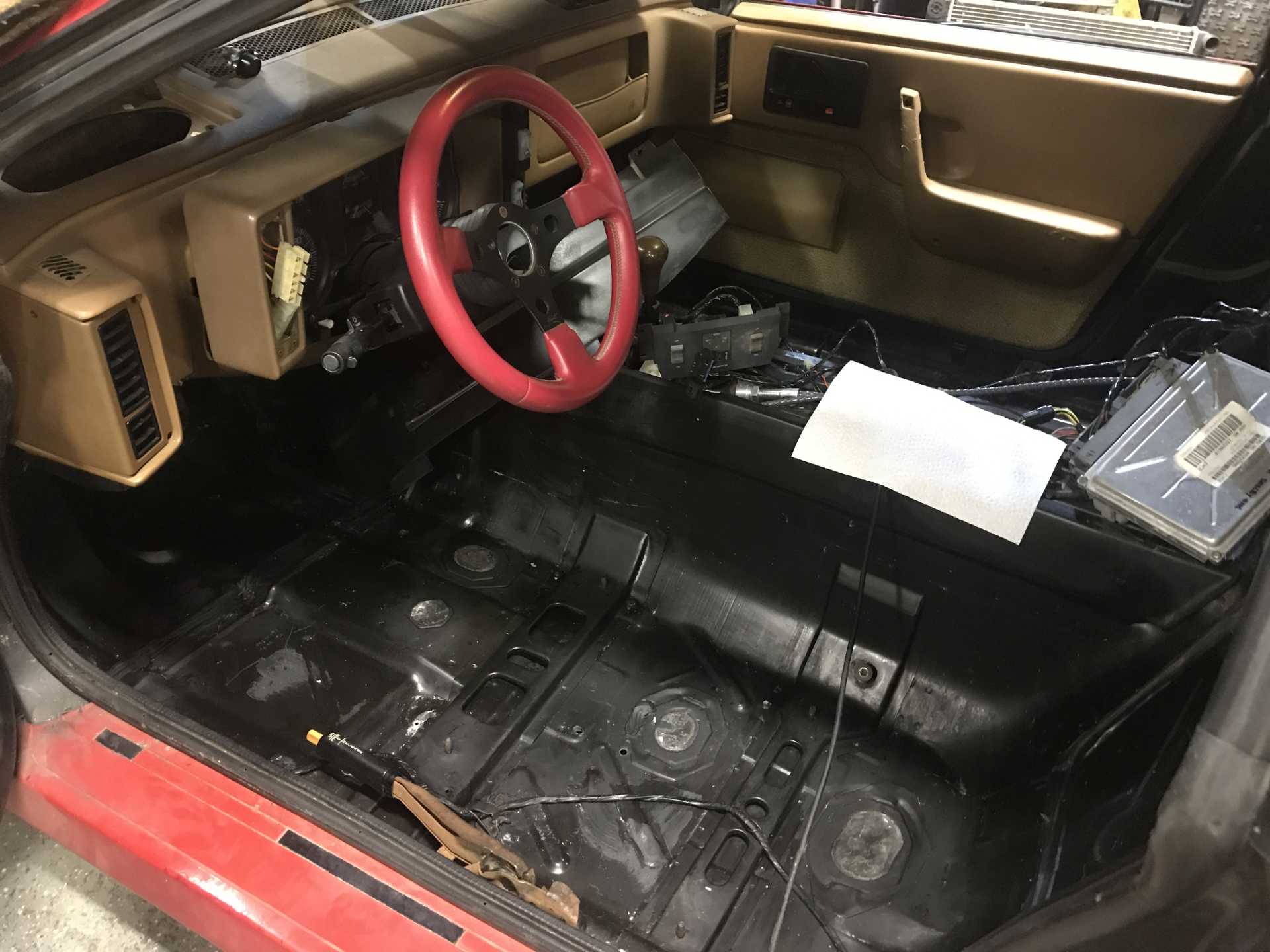

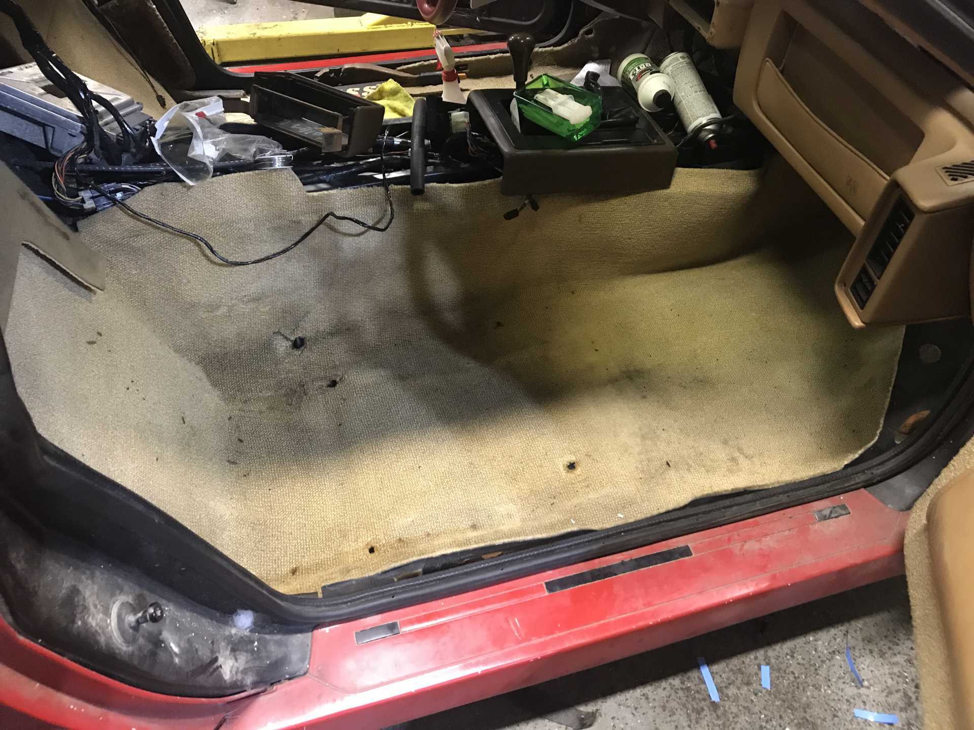

Old carpet.
It’s not very rusty but still a lot of mice droppings. I’ve had the carpet out before but didn’t do a good job cleaning as it was done outside when it was cold.

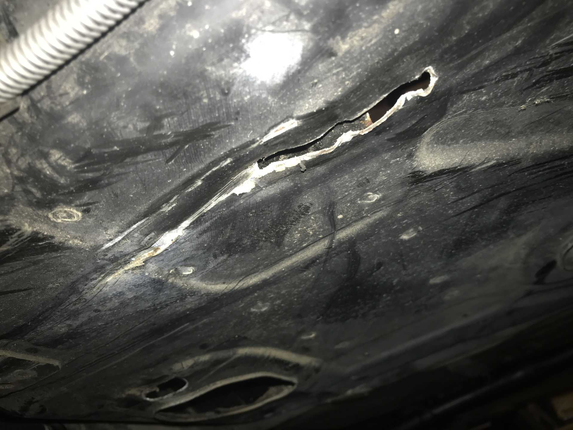

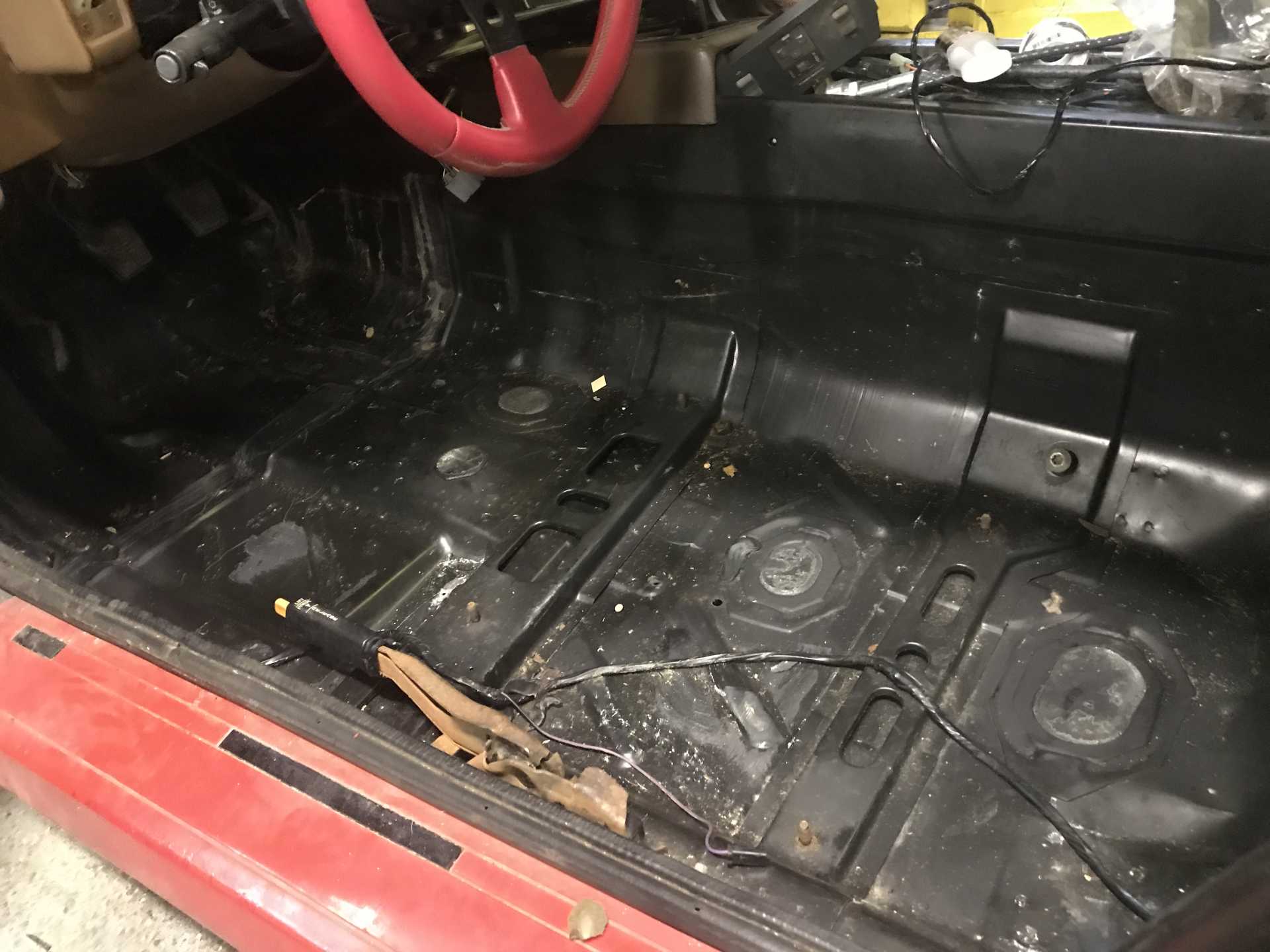

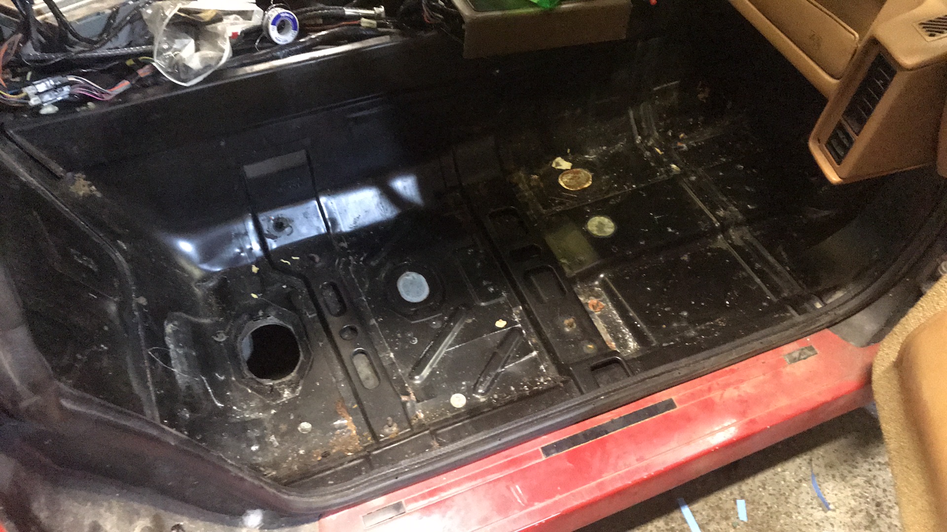

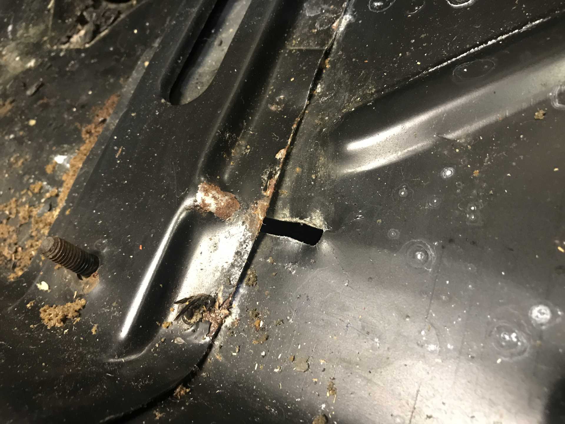

If this car could tell stories... PO obviously ran something over. I’ve known about this for a while but now it’s time to fix it. Also a random hole drilled through the passenger side floorboard towards the from.
It’s hard to see unless you look for it, but the driver side has 3 random holes drilled through that need to be patched as well,

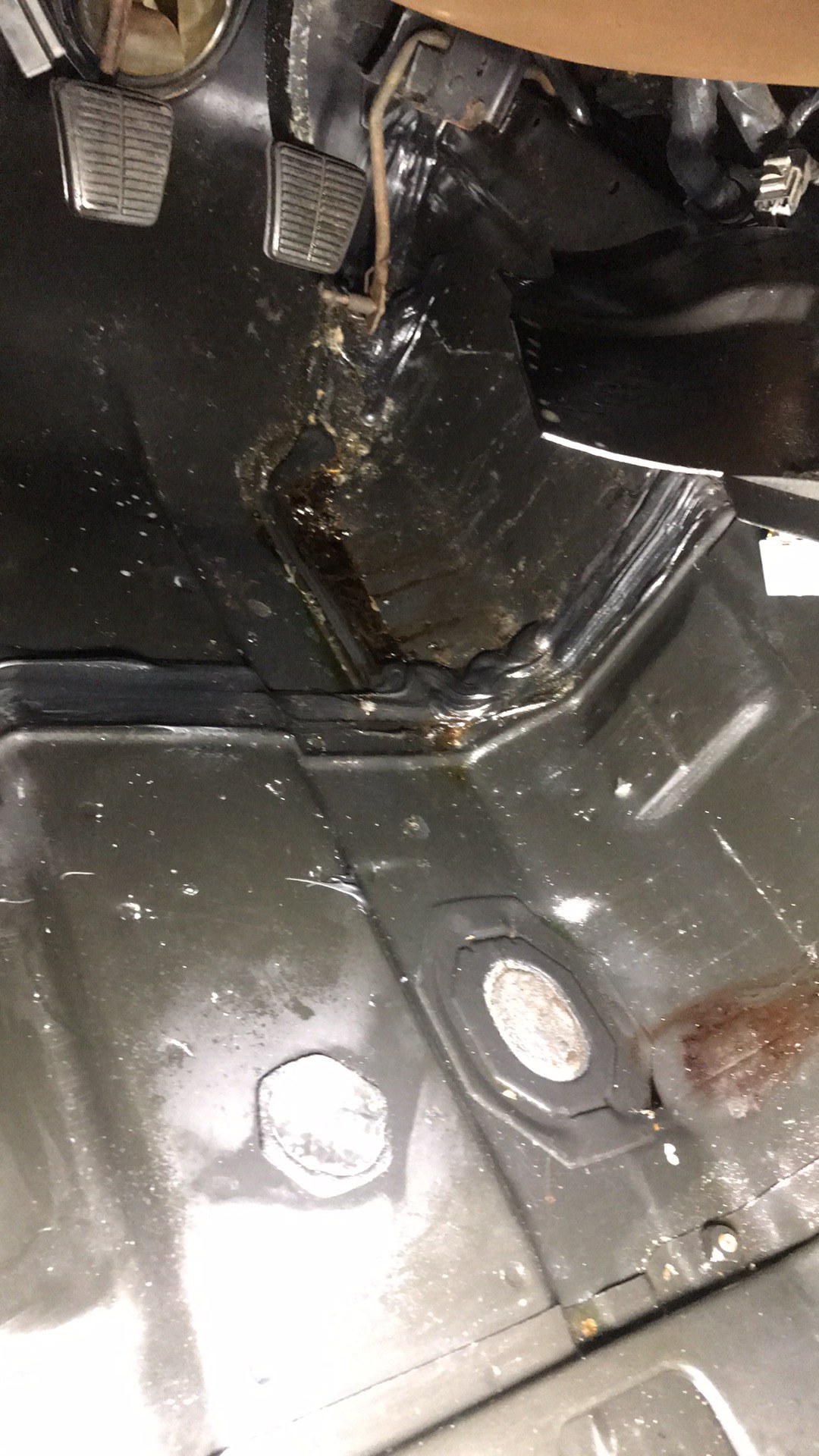

The driver side is in better shape than the passenger side.

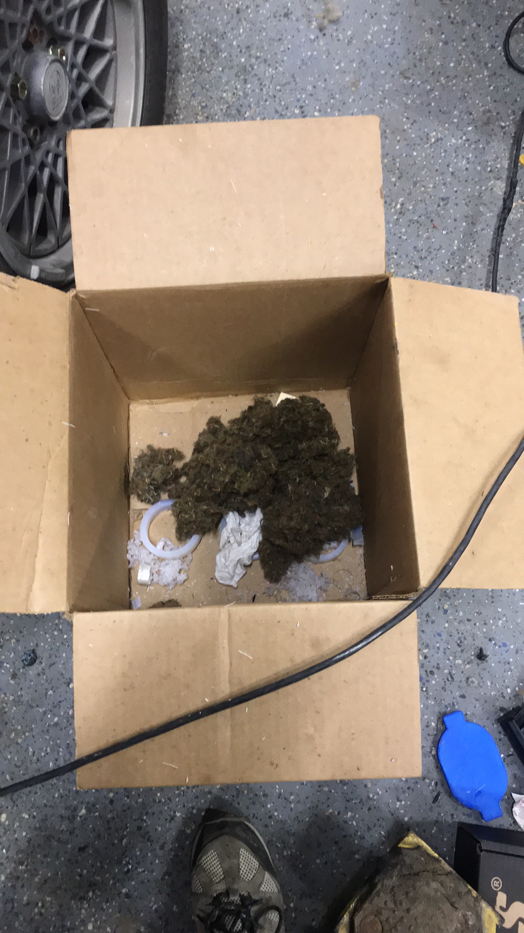

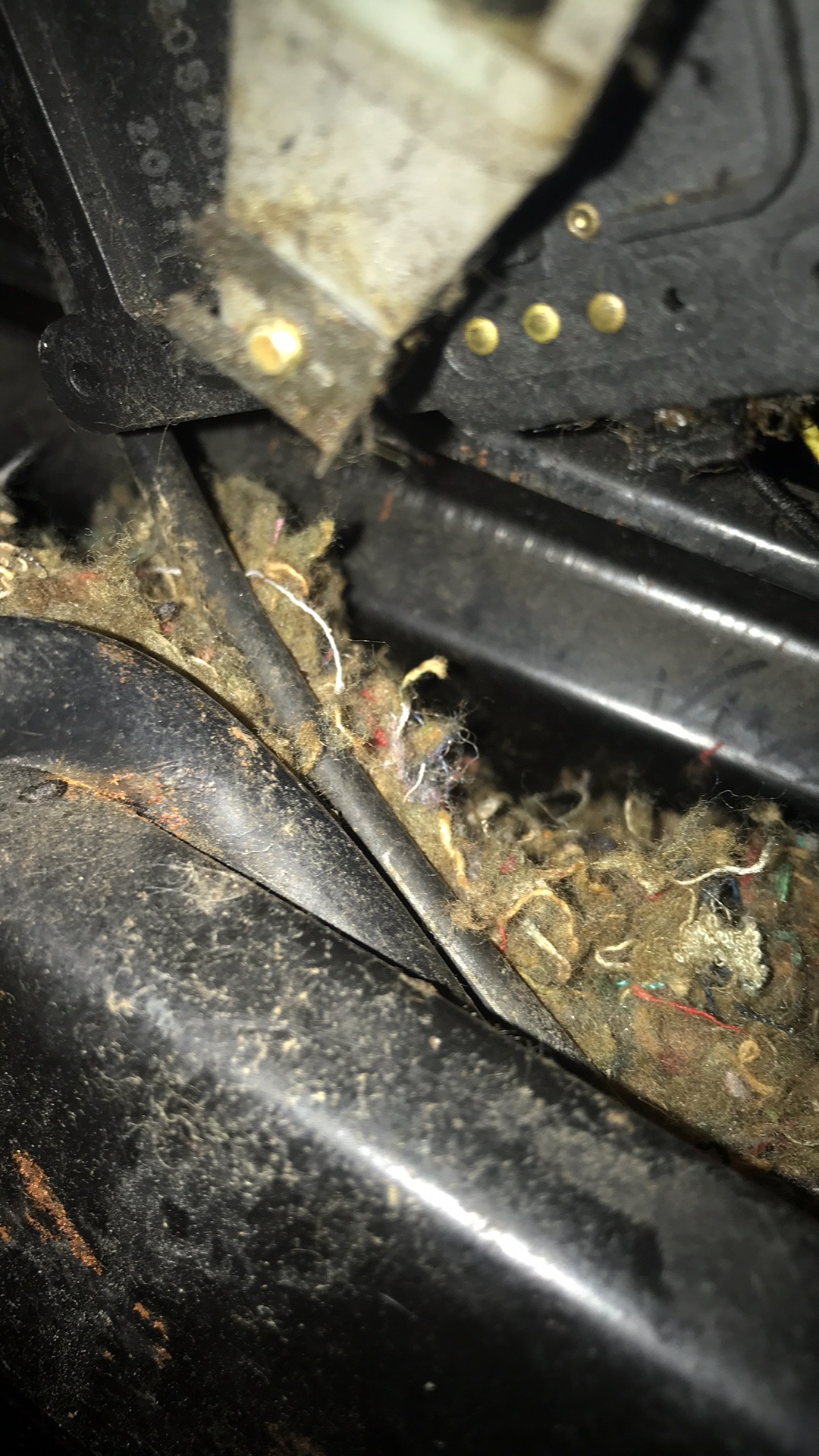

There’s a mouse nest at the very front of the center console tunnel, and under hvac stuff. Using a grabber tool was taking far too long.
There is one 7mm bolt that holds on the bottom part of the hvac, and it slid out and allowed me to reach my hand it. It still was tight but I got the nest out. I did my best to wipe down in there too.
The mice must’ve been in there a while as per had drilled down the sides of the console from a seam. This was a gross job.
Here is a picture while everything was drying. I used a lot of degreaser to get it nice. I need to now prep all of the holes to be welded, and scuff some paint so I can just hit it with another coat. Then the carpets can go back in. That’s all I did tonight.

I wonder why the passenger arm rest doesn't line up? They are all the same.
copperhens
DEC 23, 07:27 PM
Looking good!
I wonder why the passenger arm rest doesn't line up? They are all the same. |
Even bending it hard it still was hard to line up, and I didn’t want to force it and break it. Even with the two bolts in I can’t really tell anyway as it’s not even wiggly. The car is already looking loads better.
