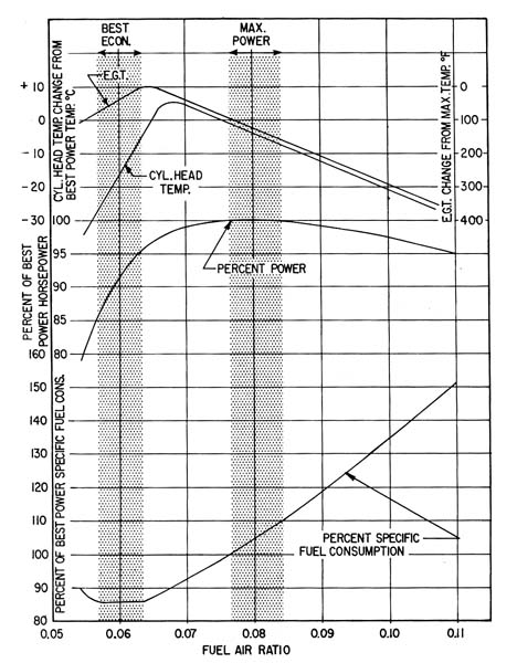

I had always been under the impression Rich Best Torque wasn't affected much by E85, so if peak power is at 12:1 or 12.5:1, AKA Lambda of .85-.82, you tune to achieve the same AFR reading on the dyno. Almost all tuners do not rescale their graphs for fuel types (stoich on Gas is 14.7, on E85 it is 9.76) Oxygen sensors are blind to fuel type, they report voltage vs lambda, the numbers reported are scaled typically for the fuel type i.e. gasoline. The benefit of E85, is its octane rating, allowing for more timing, at the cost of EGT's since the flam front propagation is slower.
 The textbook chart for a "typical" relationship of Lamba. It will vary based of efficiency of design and flame front speeds, which is affected by a laundry list of variables.
Correct me if I am wrong.
*edit: I believe this chart is in % Mass ratio 6.8% mass ratio is stoich for gasoline[This message has been edited by FieroWannaBe (edited 08-25-2020).]
Let's play "How many scales can we fit on the same graph?"!
Snazzy plot... what book is it from?

| quote | Originally posted by Will:
Snazzy plot... what book is it from? |
Figure 3-1. Representative Effect of Fuel/Air Ratio on Cylinder Head Temperature, Power and Specific Fuel Consumption at Constant RPM and Manifold Pressure in Cruise Range Operation, from Operator’s Manual Lycoming O-360, HO-360, IO-360, AIO-360, HIO-360 & TIO-360 Series, 8th Edition, Part No. 60297-12, dated October 2005. Page 3-7 https://i.stack.imgur.com/tJAao.png
That took some time to track down. I first saw it and similar plots during my ICE course as handouts from the Proff.

| quote | Originally posted by lou_dias: running a little rich only helps with snap throttle acceleration, not WOT. Leaner is meaner. When you are at WOT for more than a second you are losing power by being rich. You can prove this to yourself on any dyno...which I've done year after year after year. . |
I would argue this is patently false. I dare say many professional engine builders or tuners would agree with me here. Unless, of course, those nerds who does this all day are just wrong. There is no Universal number, but universally there is a richer than stoich. point where best BMEP is achieved. It may not be lambda .8 or .9, but its probably not 1.0, since no fuel injected engine will safely burn 100% of its potential charge during the duration of the expansion and combustion process at normal engine speeds. However, there are many engines that run lean of stoich, and they require careful consideration to avoid pre-ignition.[This message has been edited by FieroWannaBe (edited 08-26-2020).]

| quote | Originally posted by FieroWannaBe: there is a richer than stoich. point where best BMEP is achieved. It may not be lambda .8 or .9, but its probably not 1.0
Lou wants to run an (I assume) gasoline-equivalent 14 AFR, so lambda 0.95. Still rich of stoich.[This message has been edited by pmbrunelle (edited 08-26-2020).]
